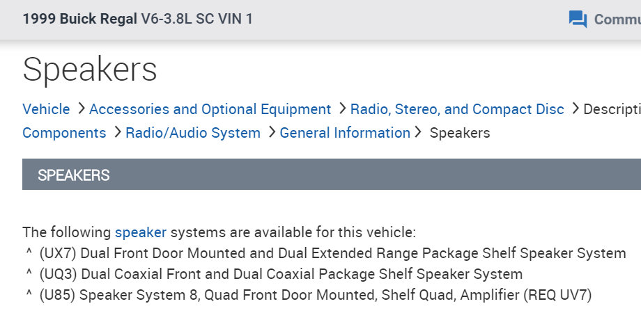

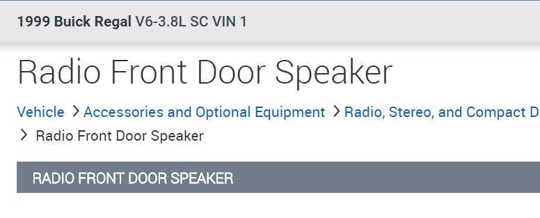

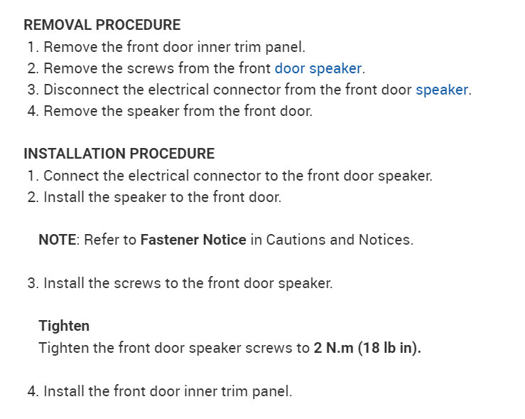

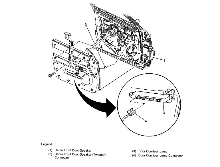

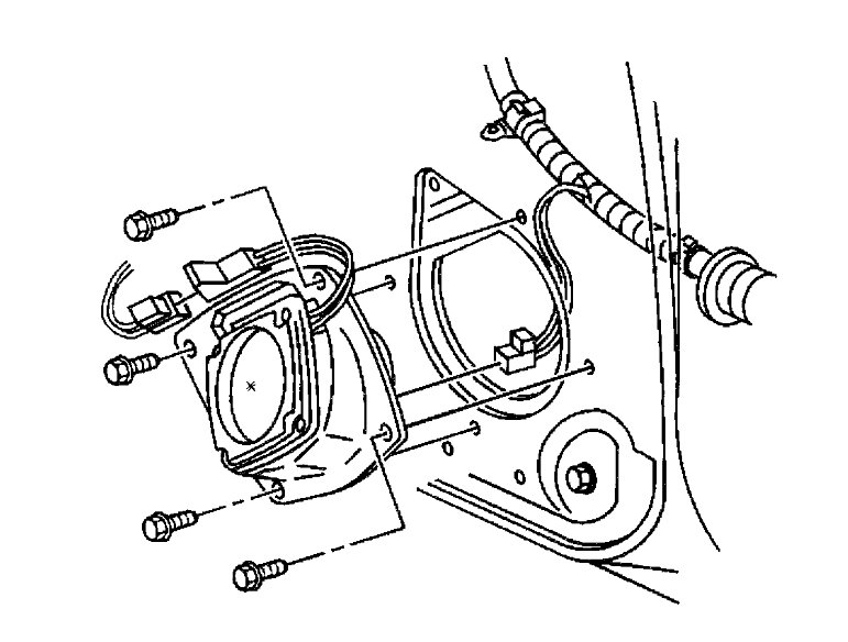

On the car listed above LS model, when replacing front door speakers and tweeters, do the door panels have to be removed or can the speaker enclosures be removed by themselves?
Jul 19, 2019 at 12:22 PM
SCGRANTURISMO
  • 4,897 POSTS
In the diagrams down below I have included the factory step by step directions for the removal and installation of the speakers in the front doors of your vehicle. Please go through this guide and get back to us with how everything turns out.

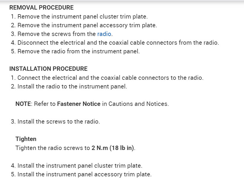

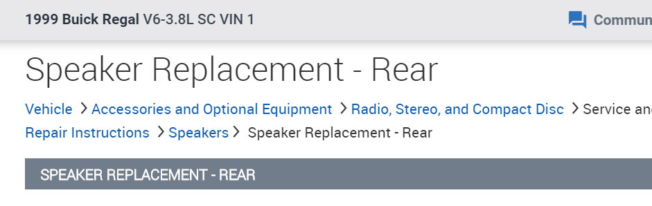

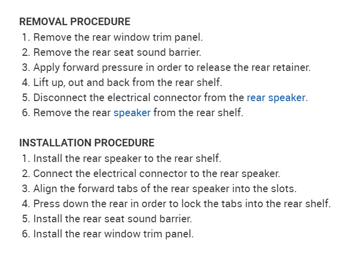

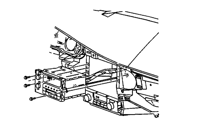

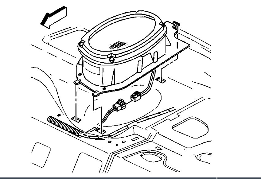

How about the radio? is it as easy as the front door speakers? And also, how about the back 6x9 speakers, how do you remove those?
And last question, I've read that my car has 8 speakers including the 2 tweeters by the front of the vehicle. My car seems to have only 6 speakers including the 2 tweeters in the front.
Jul 19, 2019 at 1:43 PM
SCGRANTURISMO
  • 4,897 POSTS
Hello again,
I have included all the information that you have requested in the diagrams down below. The difference in the speaker count is whether or not you have the premium sound or not. With the premium sound you not only got two extra speakers, they were also manufactured by Bose. The stereo looks to be a double din stereo, so keep that in mind when selecting a stereo or bracket. Please let us know how everything turns out.
