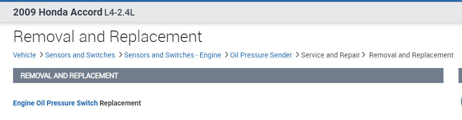

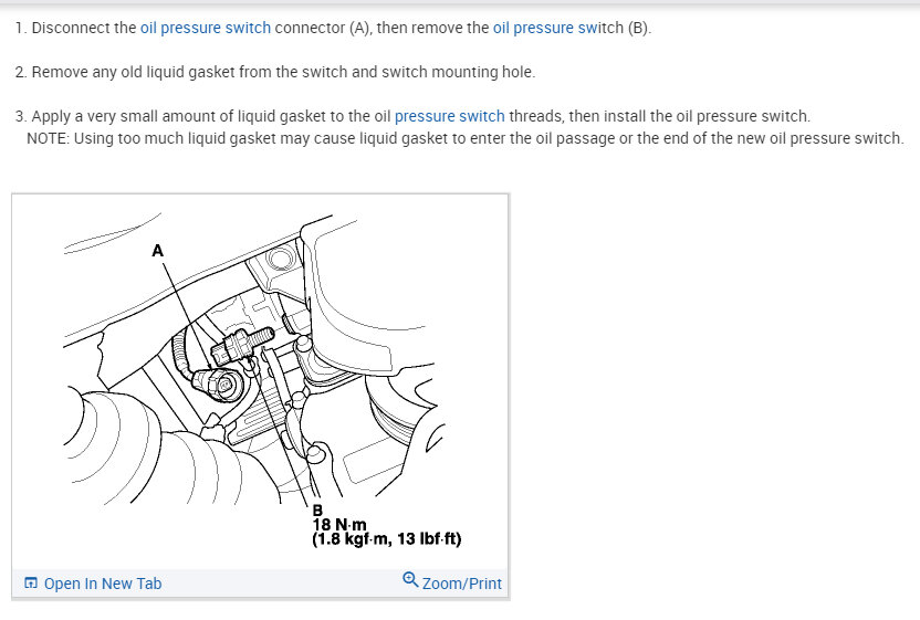

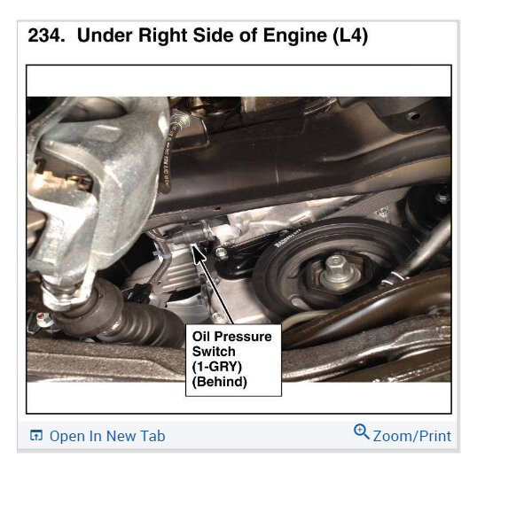

  • 110,251 POSTS
I attached the directions below for replacing the oil pressure switch. It is sort of hidden under the engine. LOL
The first pic shows the sensor and the last two are the directions.
Let me know how things turn out for you or if you have other questions. Note: Were any recommendations provided for the timing belt noise?
