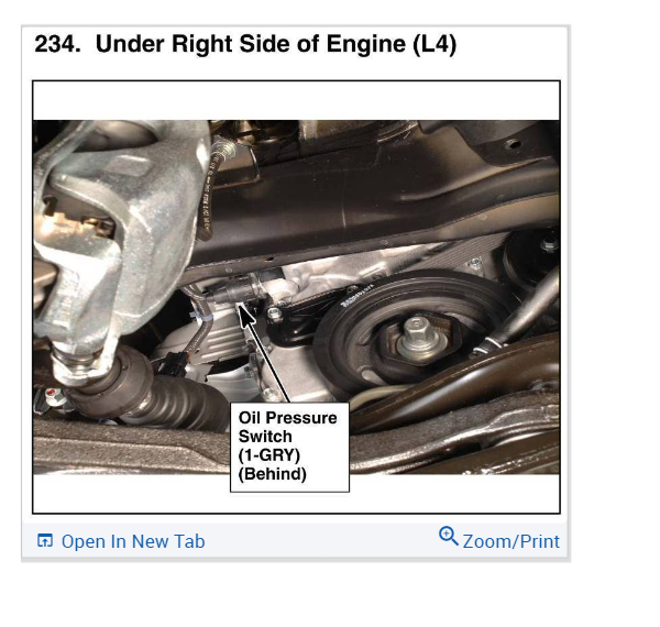

They told me it's the timing belt. As for the light. it's the sensor.

I guess it was a coincidence.. yes, they did say to change the sensor as well.

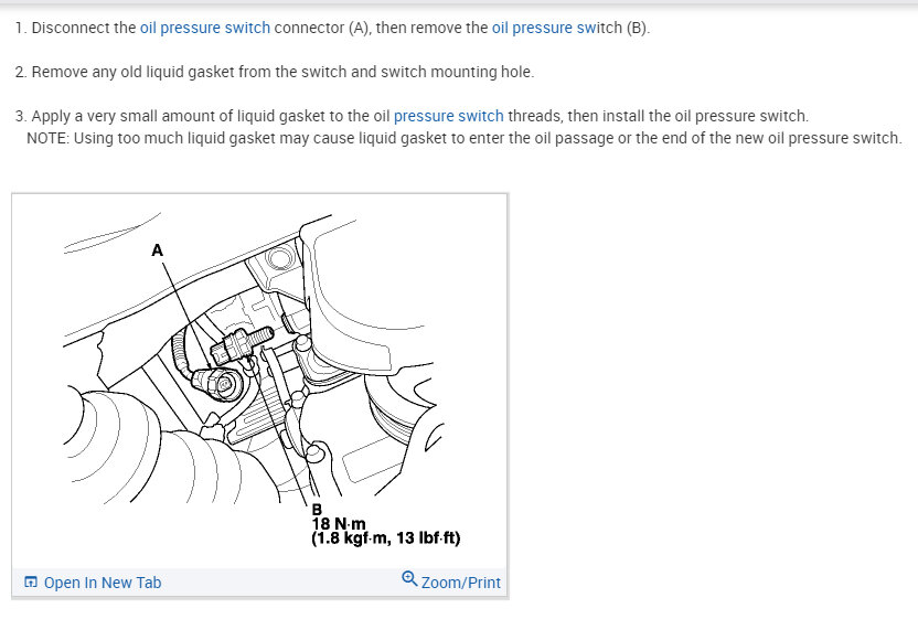

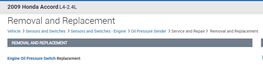

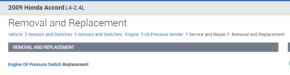

I attached the directions below for replacing the oil pressure switch. It is sort of hidden under the engine. LOL
The first pic shows the sensor and the last two are the directions.
Let me know how things turn out for you or if you have other questions. Note: Were any recommendations provided for the timing belt noise?
