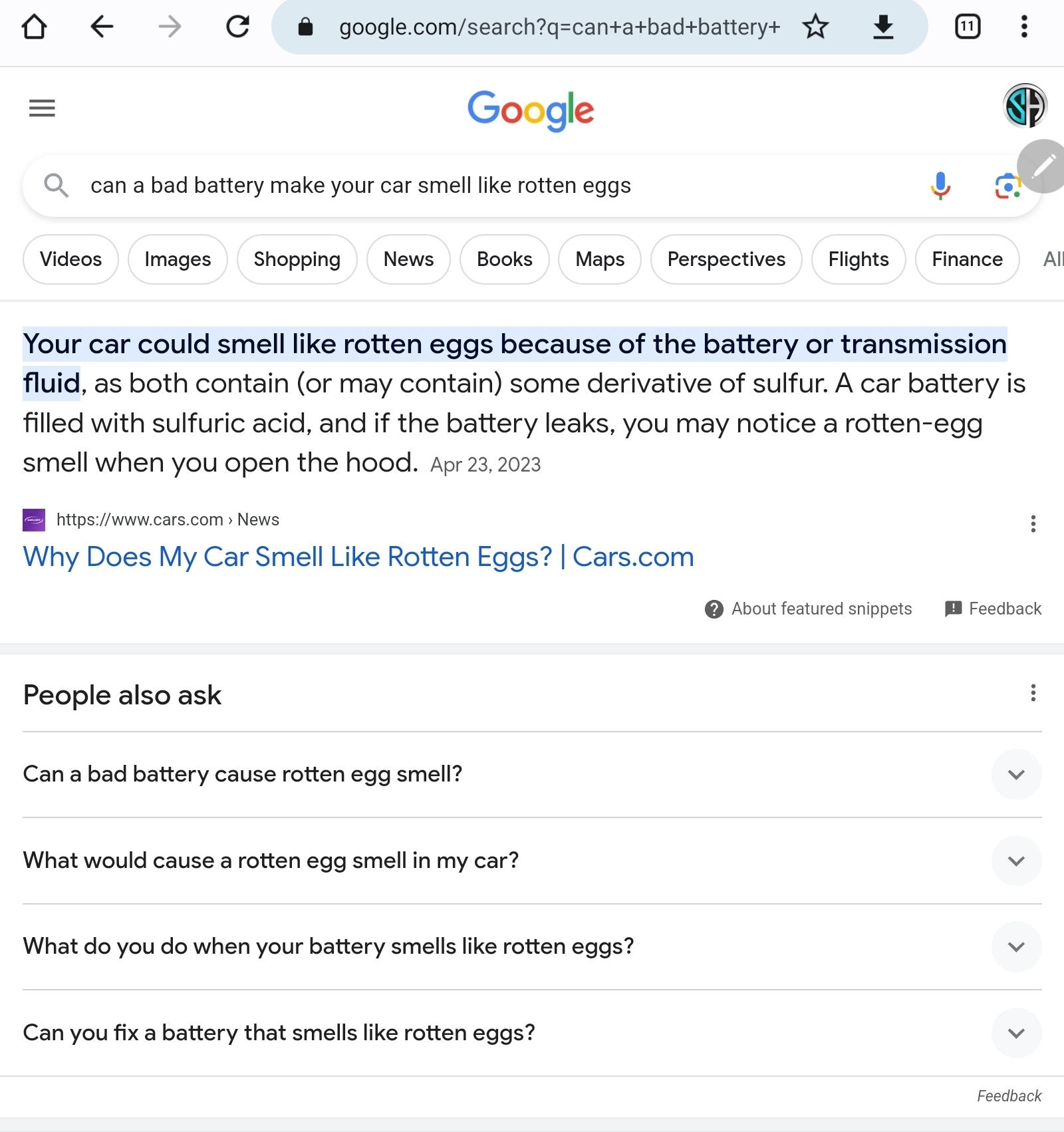

So, I tried to figure out what's wrong I checked all Over the car, but recently my car battery started to make issues it needed a boost. then like a few days ago it died fully. I wonder if the rotten egg smell is from the battery. I took the car to Hyundai dealership they changed the battery and said about the smell I need to change the cabin filter of the car. Wondering what you think?

It could be that something got into the HVAC causing the odor, but on this new of vehicle, I would think the cabin air filter would still be good. Also, does it only happen when you use the brakes? If you allow the vehicle to be parked and idling, do you smell it?
Yes, a battery can cause it as well. It's interesting that the battery was drained on this new of vehicle.
If you want, here is a link that explains in general how to replace a cabin air filter. It wouldn't hurt to inspect it.
Also, once you stop the vehicle, do you still smell it, or does it go away? I still have a feeling it is related to the exhaust. Were they able to smell it when it was at the dealer? I ask because it is still 100% under warranty and if there is a noted problem, they are responsible for repairs.

So, I didn't really focus exactly when I smelled it where and how long it smells but I did notice that it comes from the battery the smell....

This could indicate the battery is being over or under charged. Also, if there is a constant heavy load on the battery, that can cause the odor as well.
Do me a favor. Let's confirm the alternator is working properly. If you take a look at this link, it explains how to test the alternator. All you will need is a simple voltmeter or multimeter.
Let me know the results.
