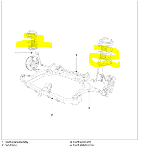

My vehicle is sitting lower than normal and has a rubbing sound. Also seems to roll or waddle on the highway. I checked that all lugs were tight on wheels.
Dec 28, 2022 at 11:11 AM
  • 110,244 POSTS
The height of the vehicle is determined by the suspension coil springs. Does it seem to sit low in the front, rear, or a specific wheel?
Take a look at the two pics below. The first is the front suspension. I highlighted the coil springs that are part of the strut assembly. Make sure they are not broken.

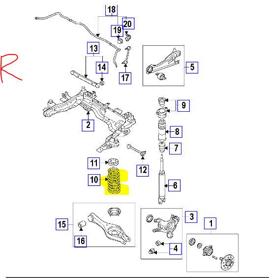

Pic 2 shows one side of the rear suspension. I highlighted the coil spring. There is also one on the opposite side. Do the same. Confirm nothing is broken.
Let me know what you find. Also, if you could take a few pics of how it's sitting and upload them for me to see, it may help.
