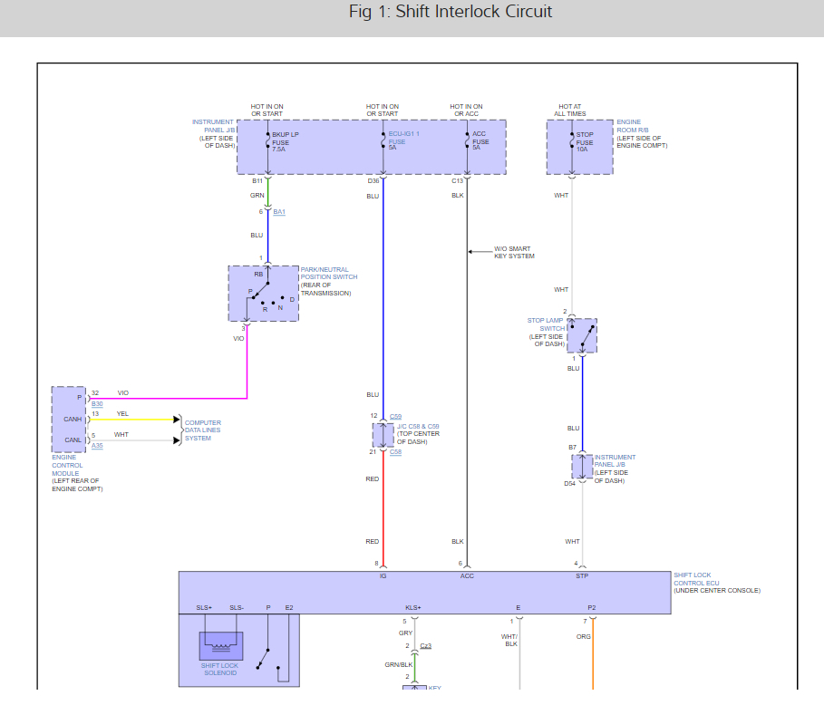

car parked has not been started or moved from an outdoor spot (under a tree) in year+.
2 months ago, it started immediately with a boost. The battery was (practically drained). When it started there was a burning-type smell that came from under the hood briefly. The(auto) shifter would not go into drive or neutral but would reverse but extremely stiff.
Fast forward to last week a brand-new battery was installed by a mobile service tech. However, it wouldn't start (no sound). The tech did a few tests and determined: a full charge going to the battery, shift release not working, as well as power windows. Noted check for broken ground, fuse, potential rodent...
Is there anything else that should be considered here? I'm not sure if these issues are somehow all related or more separate. I plan to get it towed to a mechanic today. I'm not a mechanically inclined person and looking to stay in contact with a qualified expert to provide a 3rd perspective throughout the process. Hoping to hear from you.

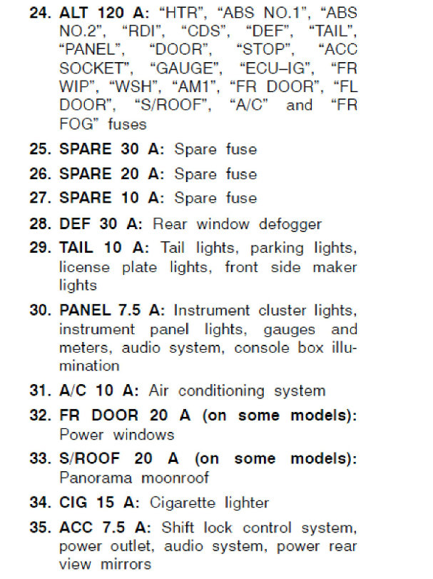

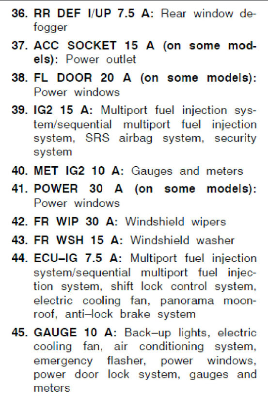

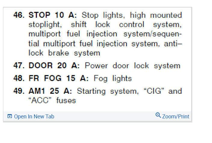

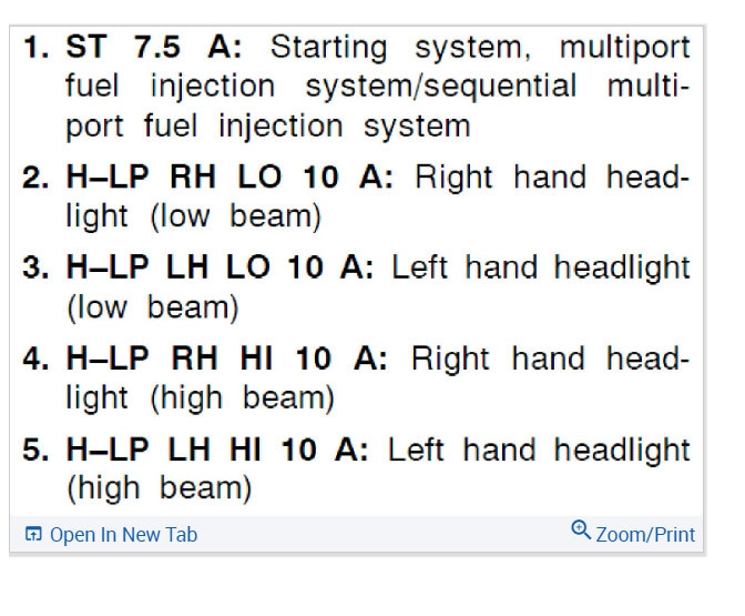

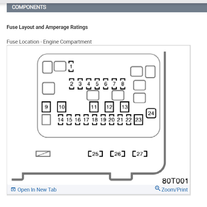

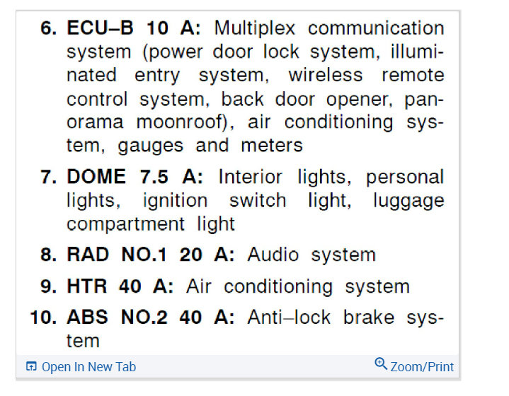

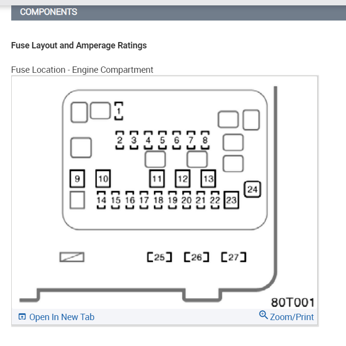

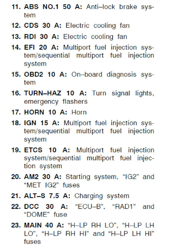

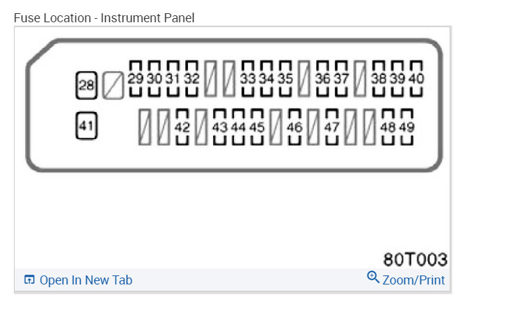

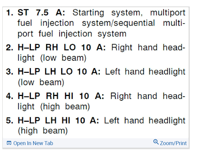

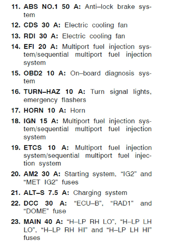

It sounds like the main body ECU is out, did you check all of the fuses? If not, I would start there.
Here is a guide to help and the fuse location in the diagrams below:
If the fuses are okay, I would do a CAN scan which is easy to do. You can get a CAN scanner from Amazon for about $30.00.
https://youtu.be/u-4syLc-ifQ
Here is a scanner link:
https://amzn.to/3o41KcZ

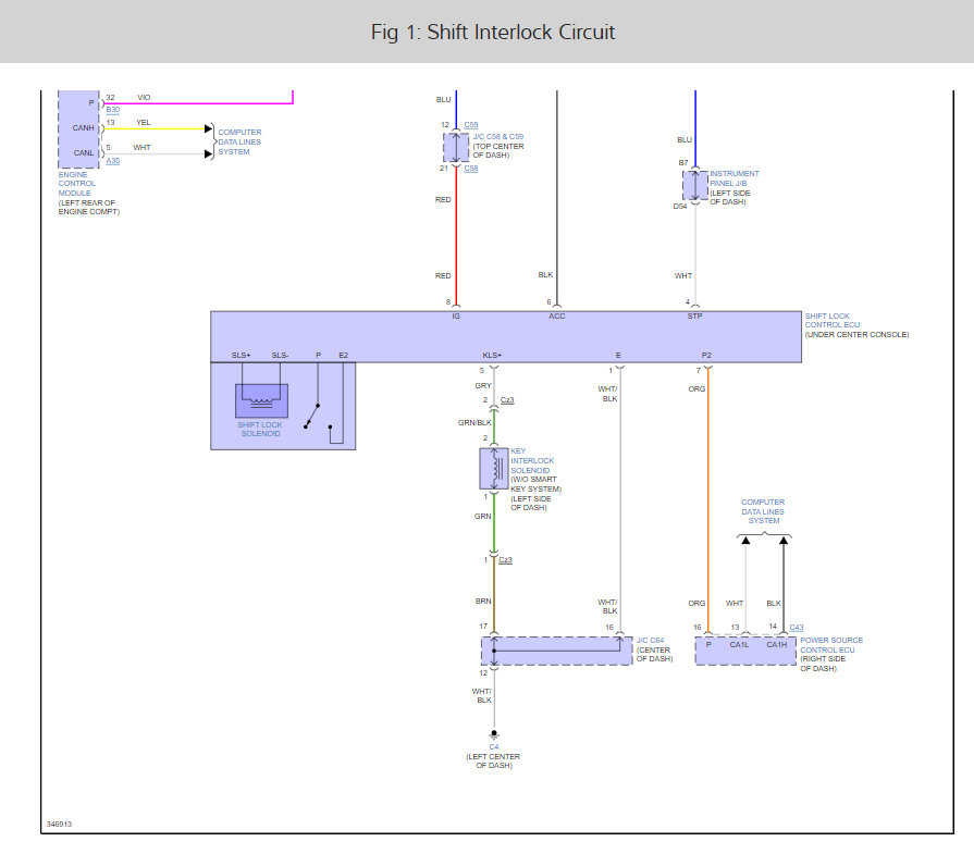

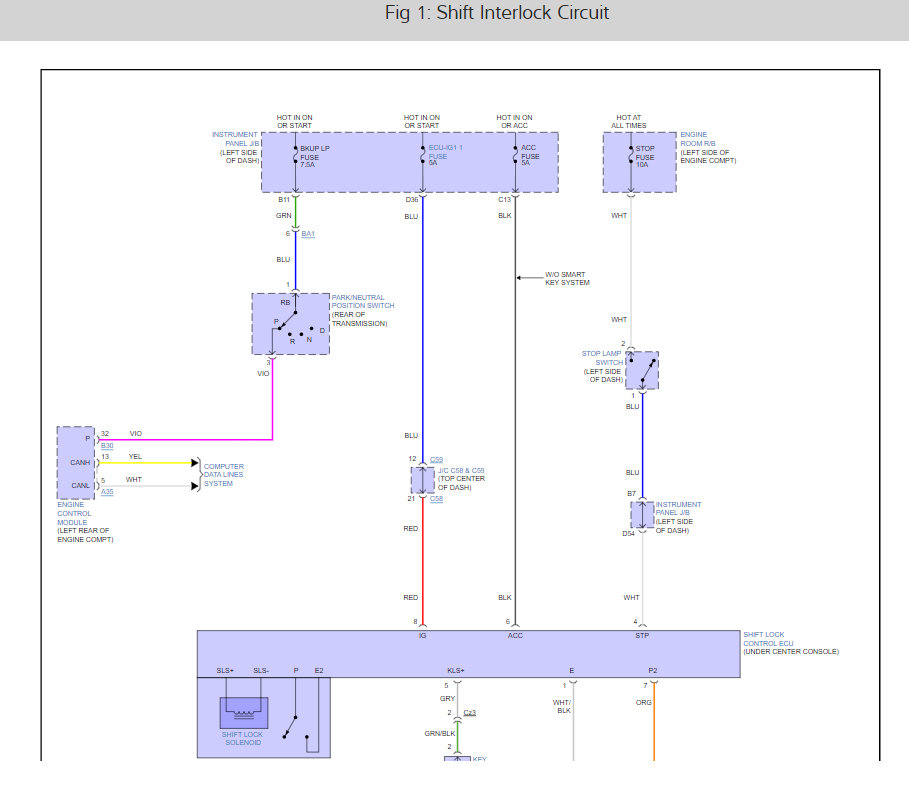

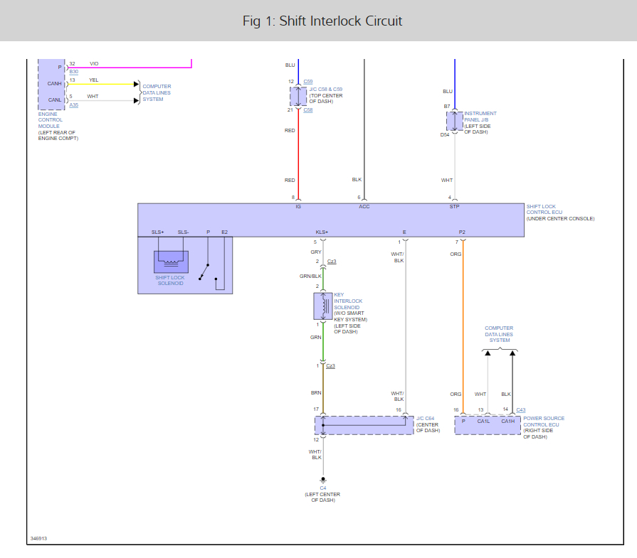

The shift interlock solenoid is run by the ECU and the windows the body control module. Check out the wiring diagrams below so you can see how the system works. Check out the diagrams (below). Please let us know what you find. We are interested to see what it is.
