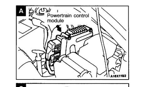

Both the check engine light, and battery light come on, but turn off when I turn on my car again. I can't seem to pass emissions, as every time it shuts off my computer data is lost. What could be causing this? I have already changed my alternator, head gasket, spark plugs. And I've cleaned my air filter.

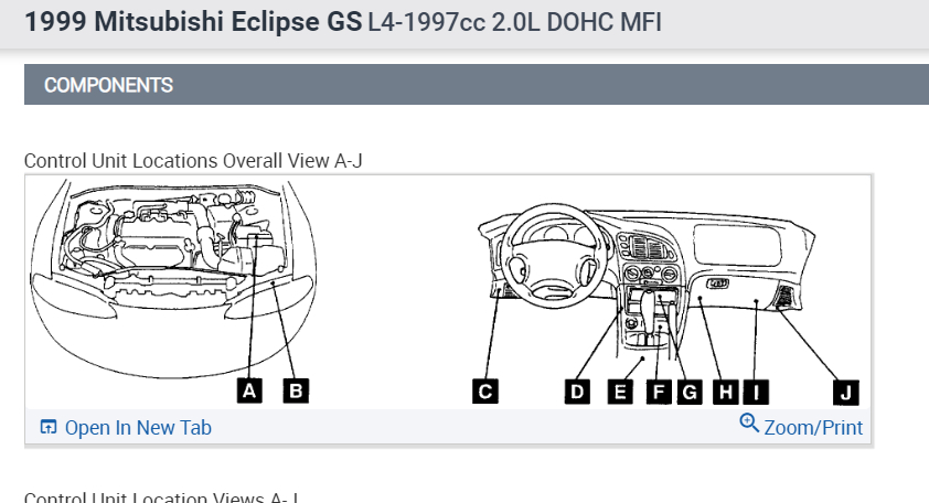

It sounds like the PCM is bad, but we should do a CAN scan to see what codes come up, you can get a CAN scanner (Controller Area Network) which will work on most cars from Amazon.
https://youtu.be/u-4syLc-ifQ
Here is how to change the PCM out in case a code comes up for it, you can get a preprogrammed unit by searching Google or Ebay. Check out the images (below). Please let us know how it goes
