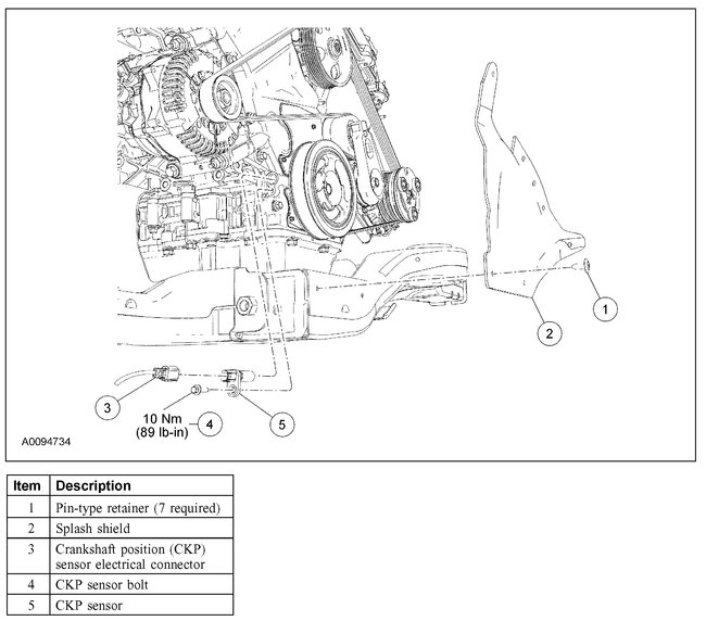

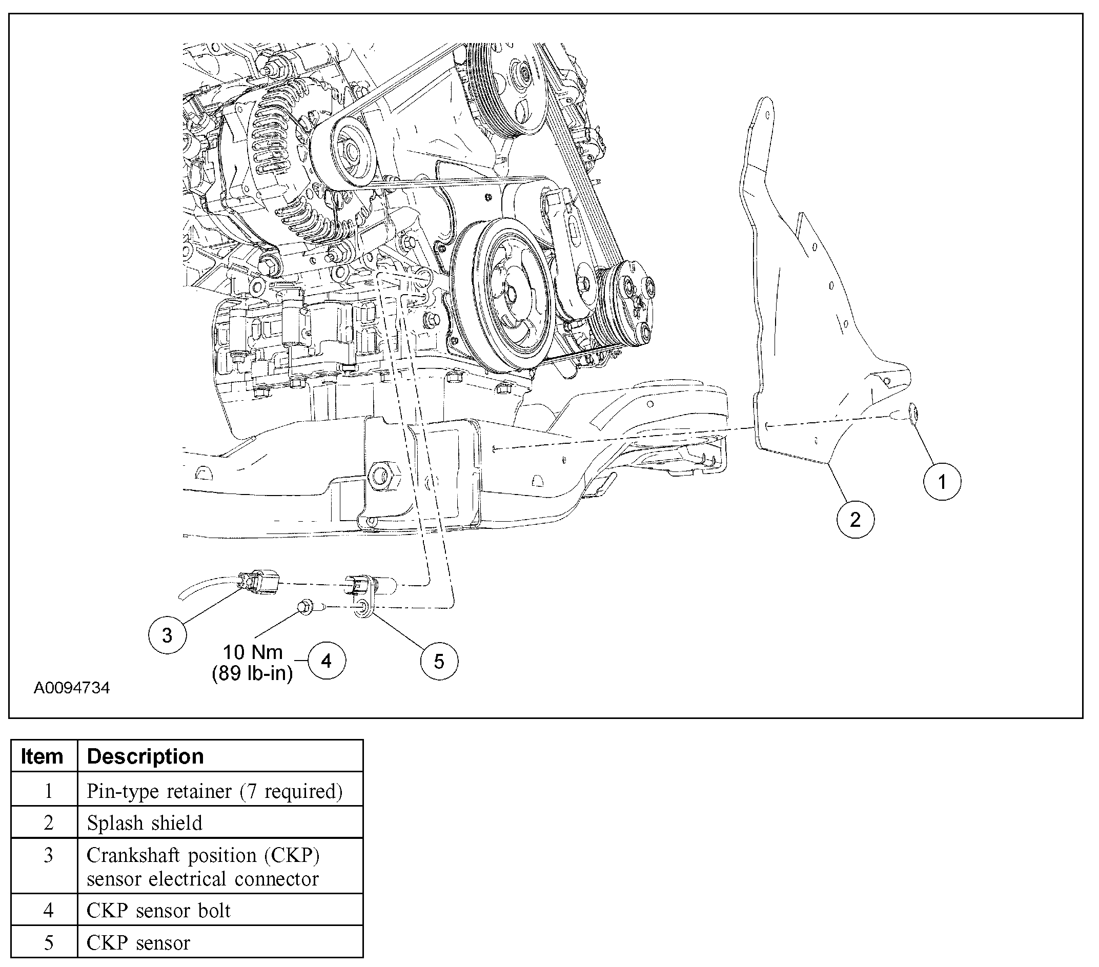

Here are the specific directions for replacing the sensor if you find it is bad. The picture attached correlates with these directions, showing where it is located.
CRANKSHAFT POSITION (CKP) SENSOR
Removal and Installation
1. With vehicle in NEUTRAL, position it on a hoist.
2. Disconnect the battery ground cable.
3. Remove the 7 pin-type retainers and the RH splash shield.
4. Disconnect the crankshaft position (CKP) sensor electrical connector.
5. Remove the bolt and the CKP sensor.
- To install, tighten to 10 Nm (89 lb-in).
6. To install, reverse the removal procedure.
Check this first and let me know what you find. If you need additional help or have other questions, let me know.
