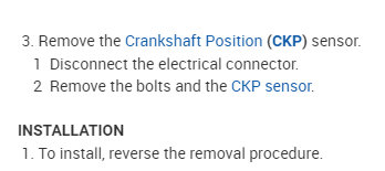

The car shuts off while driving and will not start back for a little while.

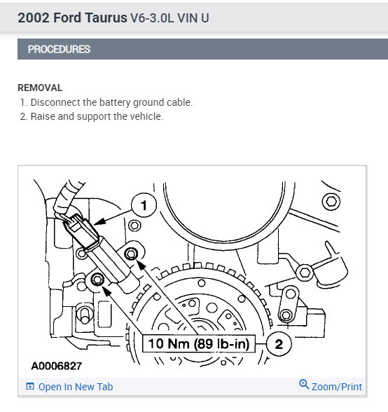

What you described sounds like a failing crankshaft position sensor. When they begin to fail, they are adversely affected by heat. Once they cool off, they work again.
Do me a favor. Take a look through this link and let me know if anything discussed mirrors what you experience:
To confirm this is the issue, you can either check for an RPM when there is a crank no start condition using a live data scan tool, or you can check if there is spark loss to the plugs.
Here is a link that explains how that is done:
https://www.2carpros.com/articles/how-to-check-for-ignition-spark
If there is no spark or no RPM signal, this is my first suspect.
If you look below, I attached the directions specific to this vehicle for the replacement of the part. Take a look through them and let me know if you have questions.
