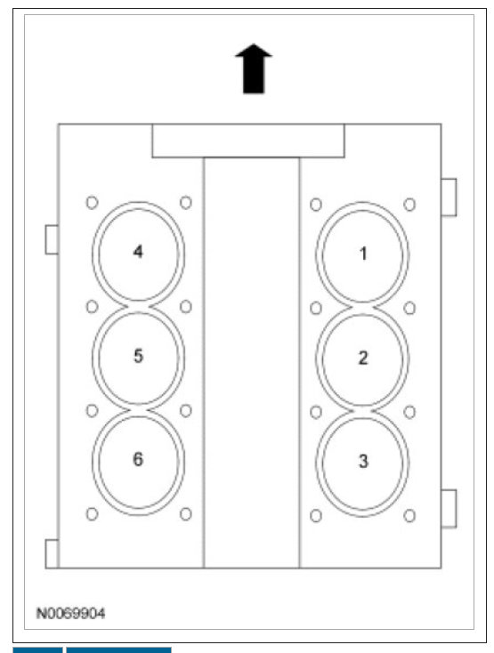

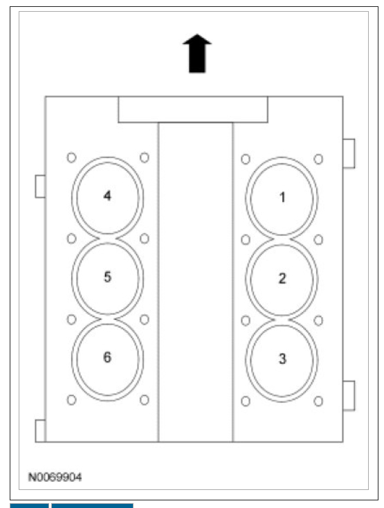

P0060, P1450, P0456, P144A, P0316
Feb 26, 2018 at 12:31 PM
  • 55,398 POSTS

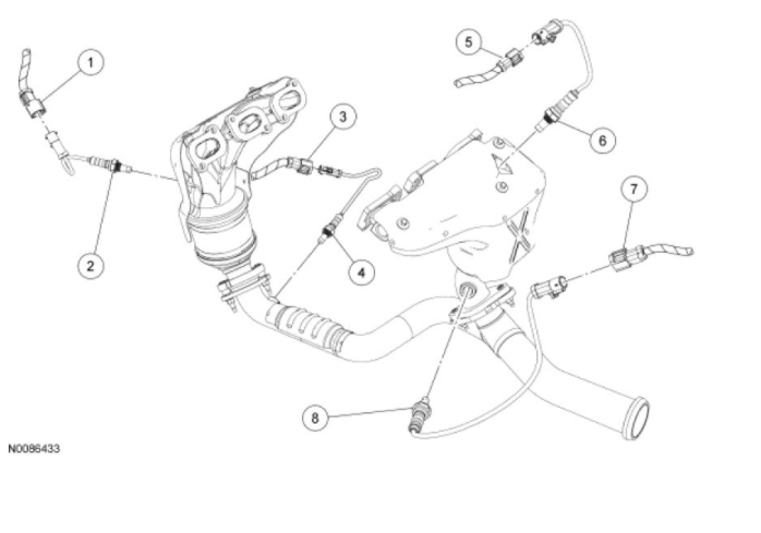

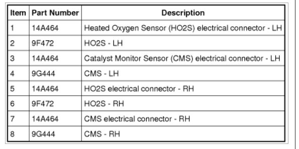

The first code is a bank 2 sensor 2 oxygen sensor which you can change yourself getting the sensor from Amazon and following this guide.
https://www.2carpros.com/articles/how-to-replace-an-oxygen-sensor
Which can cause the engine to shut off. I would do this first and then clear the codes and go from there.
The other codes are EVAP and misfire codes which wont make the engine stall only the oxygen sensor can do that. Might want to look at the gas cap first.
Check out the diagrams (Below) the sensor you want to replace is the second one down one the front bank. Closest to the front of the car.
