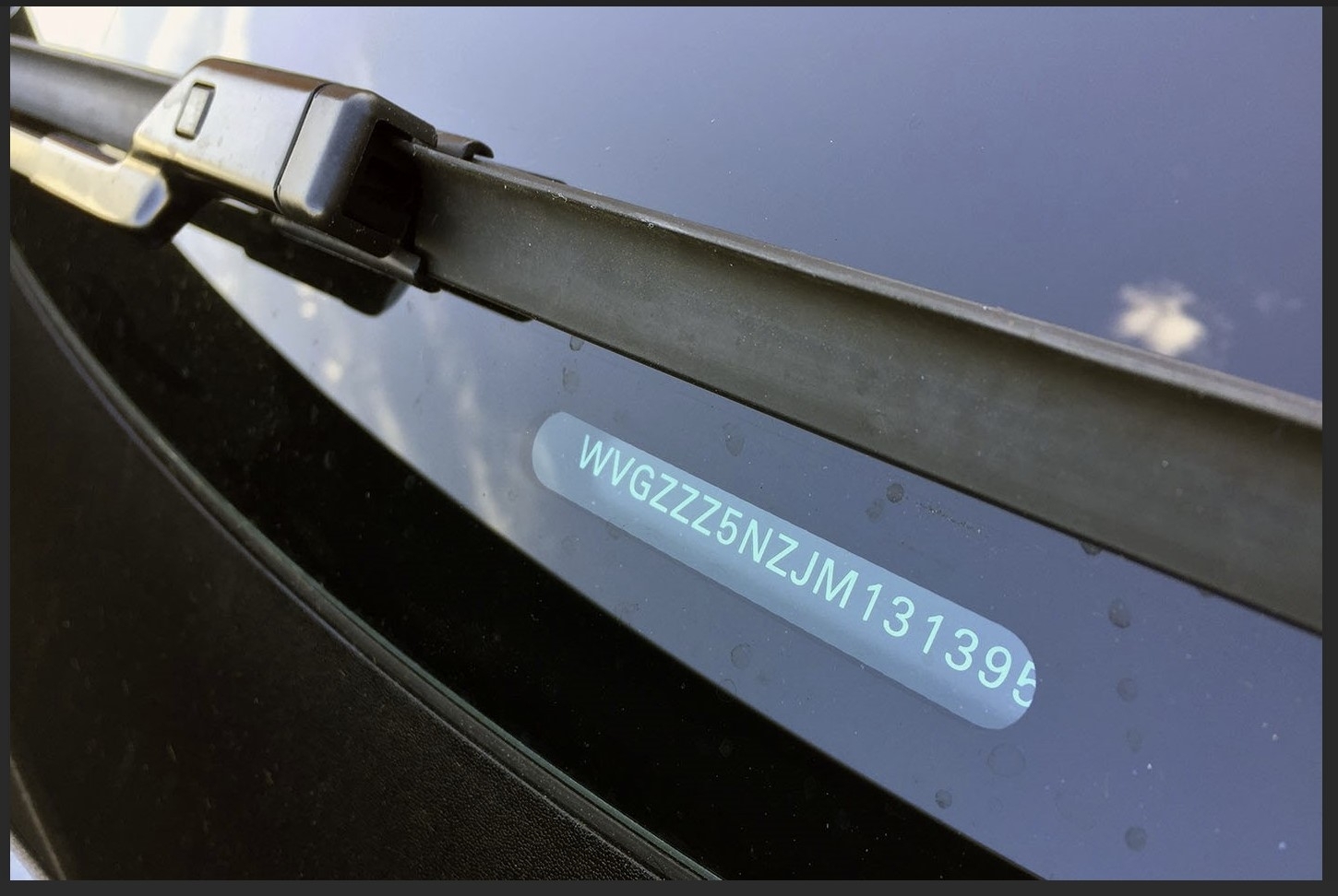

First would you mind sending me your entire 17 Digit VIN? There is some conflicting information on my end saying that the 2010 Equinox only came with a 2.4L and 3.0L. I don't think it is correct. With your VIN I can get the exact information for your vehicle so we can start figuring out what's going on and help you a lot better.
This can be found at the bottom of the driver's side of the windshield, the driver's sides door jamb, and you will also find it on your vehicle's registration.
