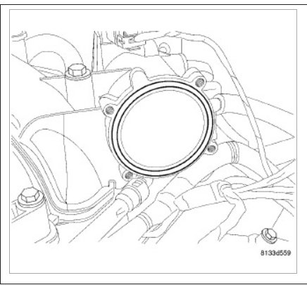

When pulling up to a light or stop sign the car shuts off. Put into park starts right back up. When I put it into drive will not go nowhere, put it back in the park and back and to drive several times and it will finally go. What is causing this?

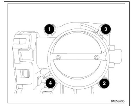

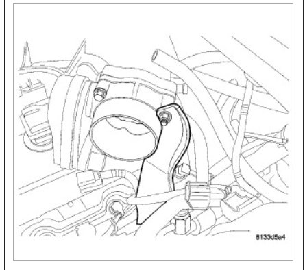

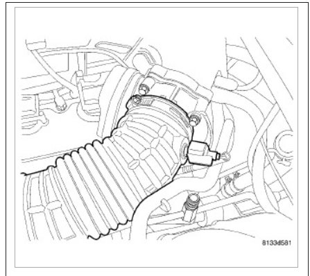

I have seen this problem before the throttle bore gets dirty which causes the actuator to malfunction. Here is a guide and diagrams below to help you get the job done:
