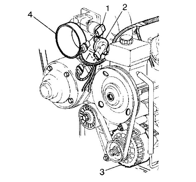

As I was pulling in to my driveway felt my steering wheel tighten up car shut off, but still the electrical stuff was running fans were still on except the car. any ideas?

Does the car start right back up or does it not start?

Yes, it will start right back up.

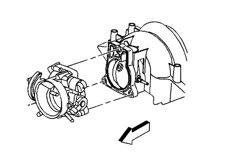

Okay, I would try cleaning the throttle body of all carbon. That is a common issue for stalling.

Okay, will do. anything I should use for cleaning?
Oct 29, 2019 at 9:57 AM
Throttle body cleaner. you can get it at any parts store.
