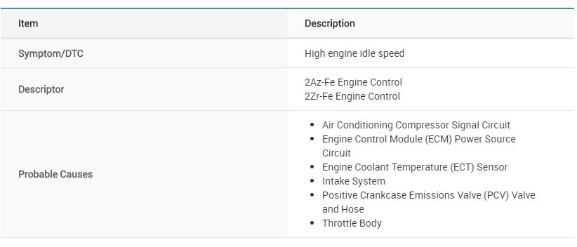

This am I was driving I turned my steering got tight I turned again and I started swerving all my light were flashing then my car turned off. It had no power. I pulled over and turned the car back on no lights on, drives fine. What do you think is going on?
Aug 22, 2018 at 2:54 AM
  • 110,244 POSTS
If there is no check engine light staying on and this is the only time it happened, it could be many different things, vacuum leak, idle air control valve stuck, bad gas. If you would like to check a few things, I will attach links that describe the component and how to check them.

My car has been revving up when I start goes up not to much, but it has never done that before.
Aug 24, 2018 at 3:10 AM
IRENE1988
  • 17 POSTS
It has been doing it for like three weeks.
Aug 24, 2018 at 3:11 AM
  • 110,244 POSTS
Welcome back.
There is a chance that it is related to an engine vacuum leak or the idle air control valve (IAC). The IAC is responsible for maintaining the engine's idle speed. You mentioned that the idle has been higher than normal. I attached a picture of possible causes. However, there is a list. If the check engine light is on, you should scan the computer to determine if there is a trouble code stored which should indicate where the problem is coming from.
Here is a quick video showing it being done. Most parts stores will do it for you for free.
https://youtu.be/YV3TRZwer8k
If the check engine light is not on, most likely, there will not be codes. Were you able to test any of the items I mentioned in the first post? There are so many different things which can cause it. Things as simple as a plugged air filter can cause the engine to run rich or even not at all. A weak battery can cause the idle issue.
