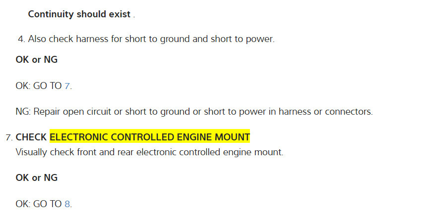

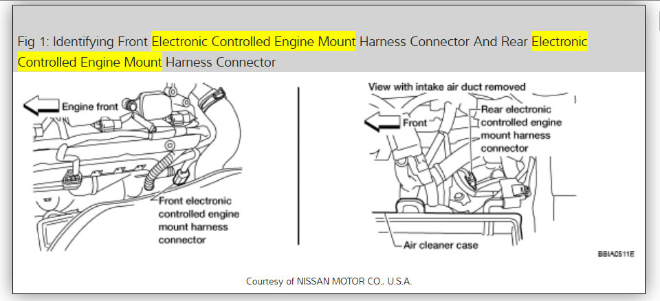

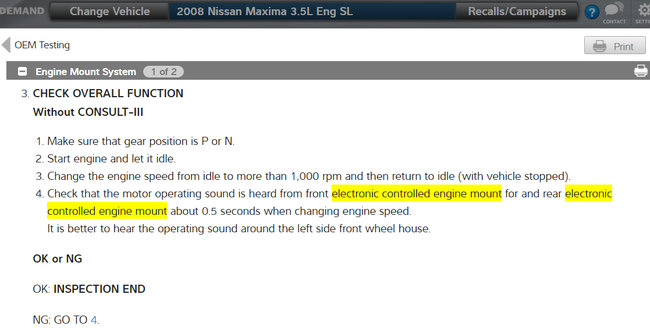

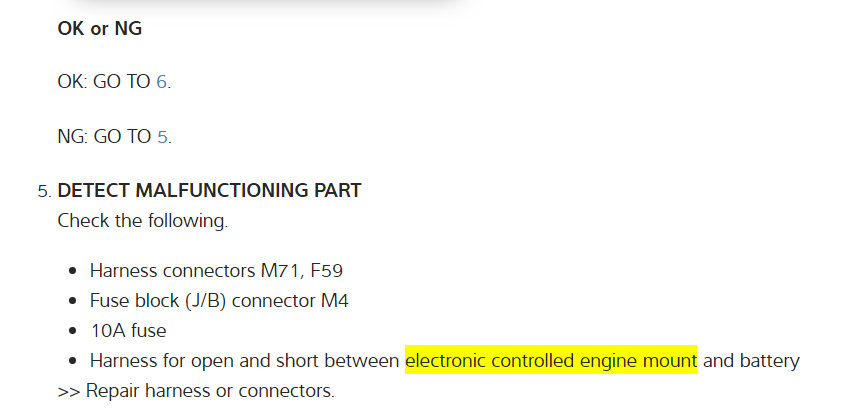

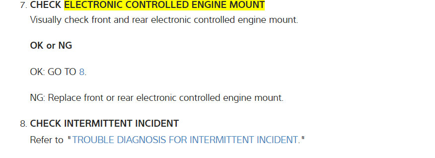

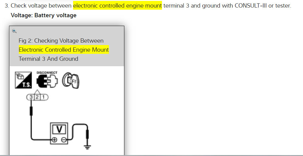

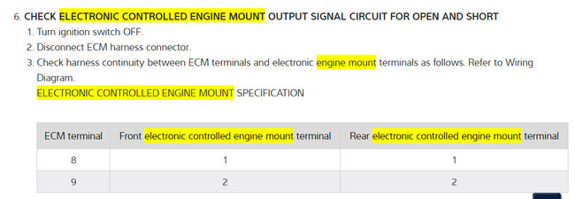

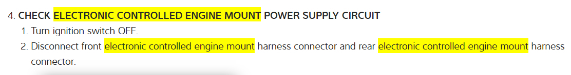

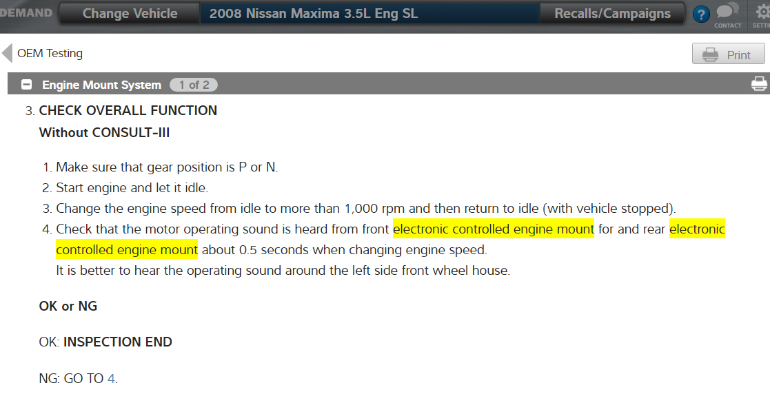

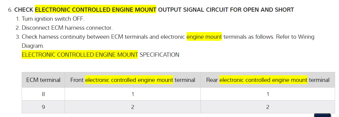

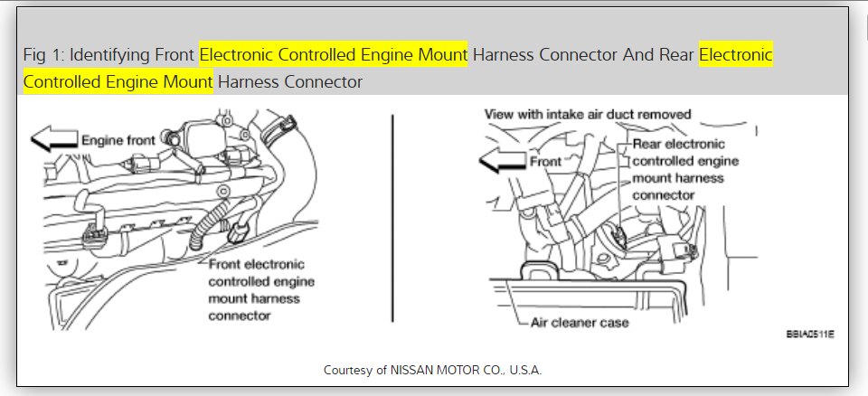

This could be a motor or trans axle mount. If the motor or transmission mounts become loose or malfunction the the dampering effect that they provide will no longer be there. As the RPM's and the load on the engine/transmission increase then so would the vibrations. When you let off on the accelerator pedal, the load will also go away and that could be why the vibration then smooths out.
I have included factory diagnostic troubleshooting guide for your vehicle's motor mounts in the diagrams down below. Please go through this guide and get back to us with what you find out.
