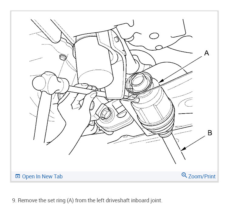

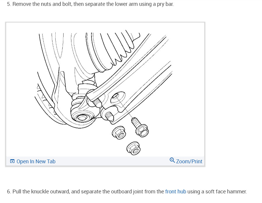

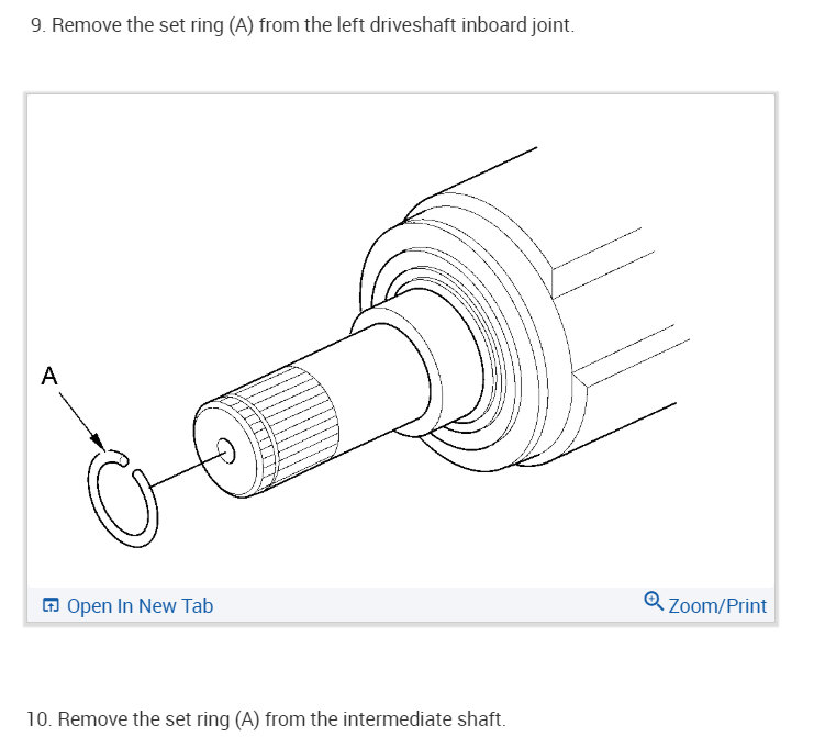

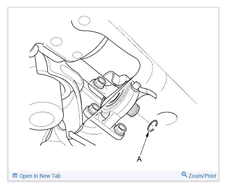

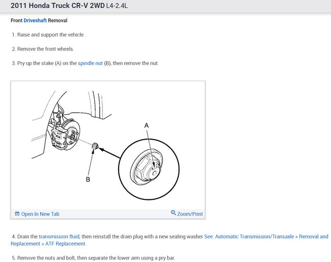

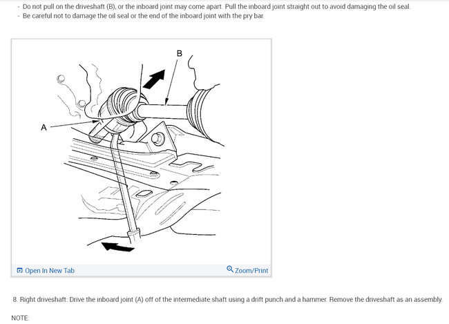

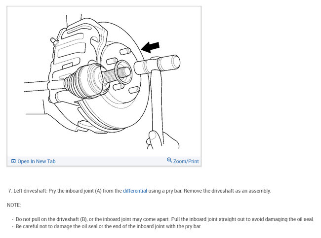

What happens is the CV axles wear out causing the vibration under load. here is a guide to help you change them out step by step with instructions in the diagrams below to show you how on your car:
https://www.2carpros.com/articles/replace-cv-axle
Start a new question for the EVAP codes

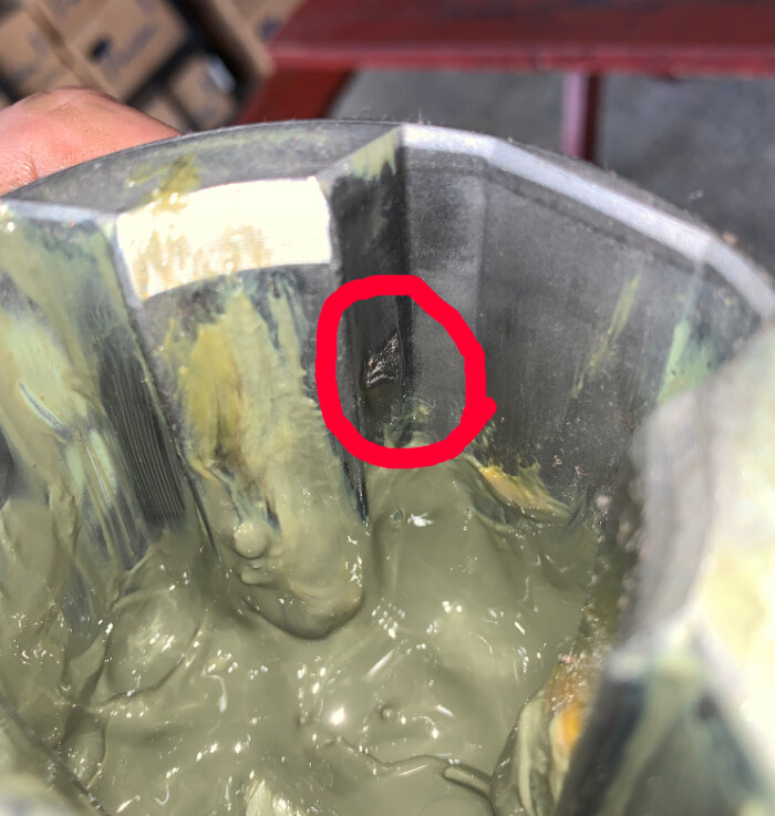

Ken's advice was 100% spot on. It was the CV axle on one side. I had both replaced and no more problems. I had a little difficulty finding a mechanic that would believe it was the CV, but finally was referred to a shop that knew exactly what Ken was describing and was confident in fixing it. They showed me the wear inside the part. Sorry, it's been a while and I'm rusty on details, but I was amazed how few people understood this problem. Good luck with your car and belated thanks to you Ken...really saved my bacon.

I just checked my records. I replaced both front axles. Both of the inner CV joints had divots.

Here's one of the inner CV joints showing the wear. Hard to believe that tiny mark caused all that vibration. Hope this helps!

Good to hear, yep that is the kind of wear that will cause the vibration, thanks for the image to show anyone else having this problem. Use 2CarPros anytime, we are here to help. Please tell a friend.
