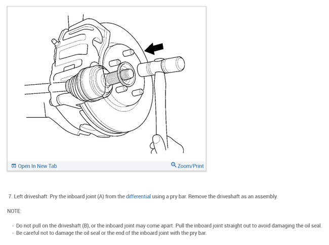

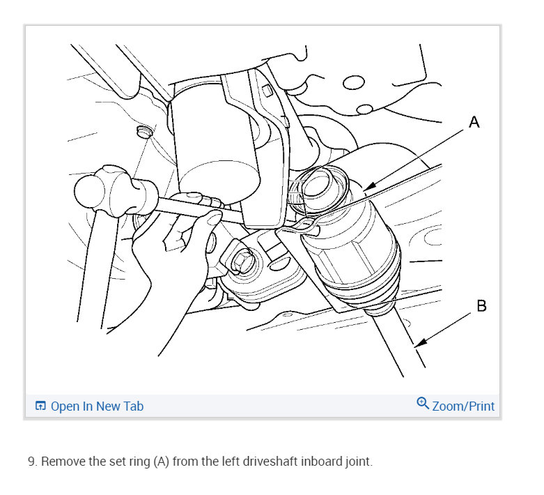

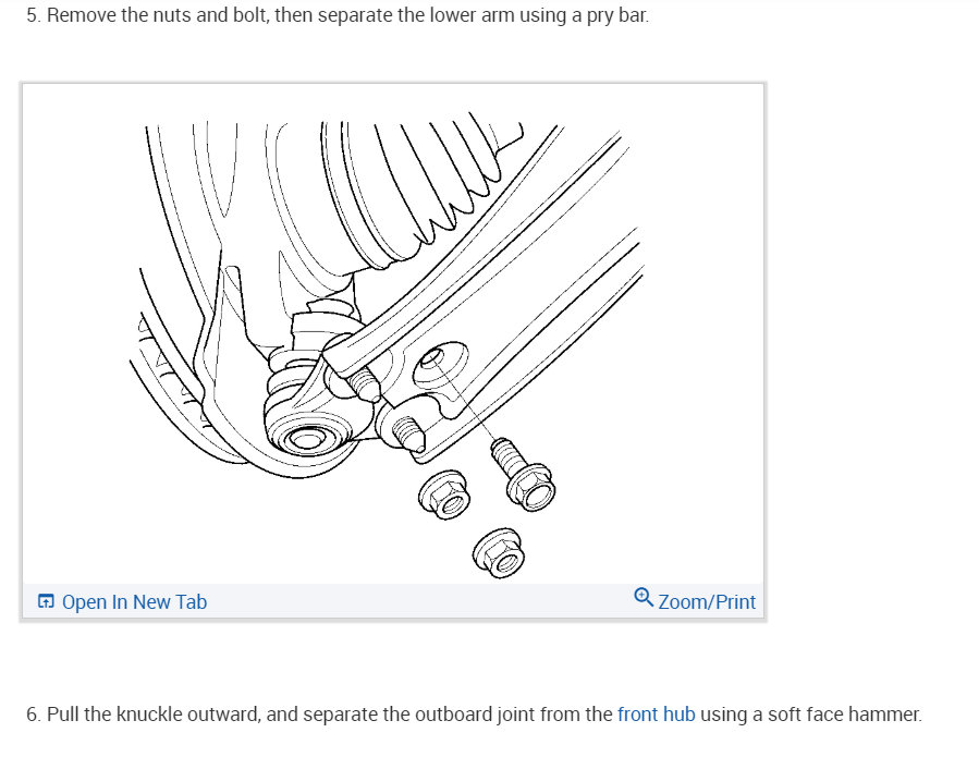

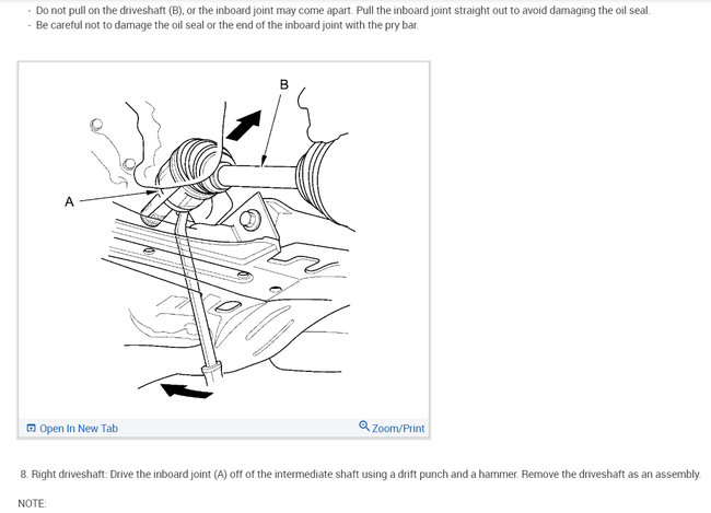

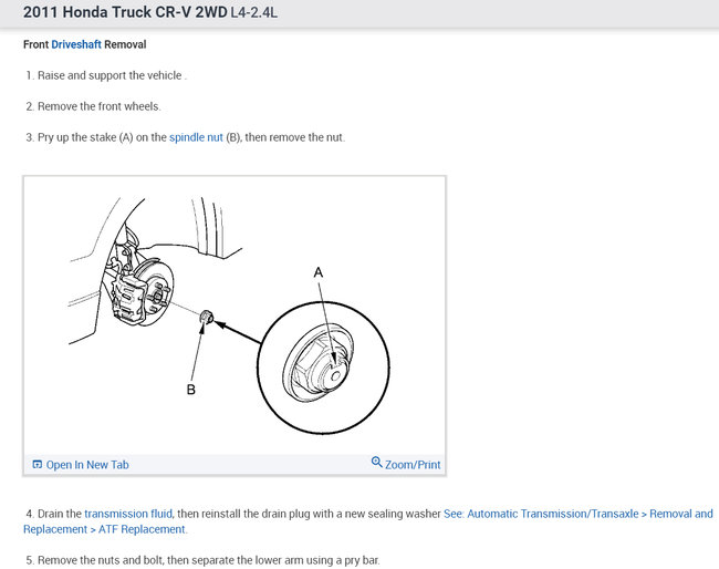

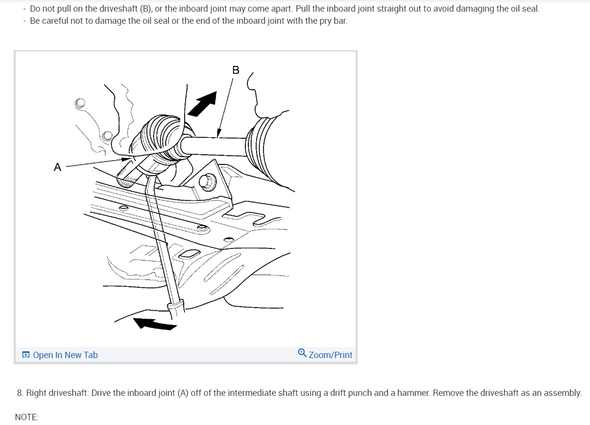

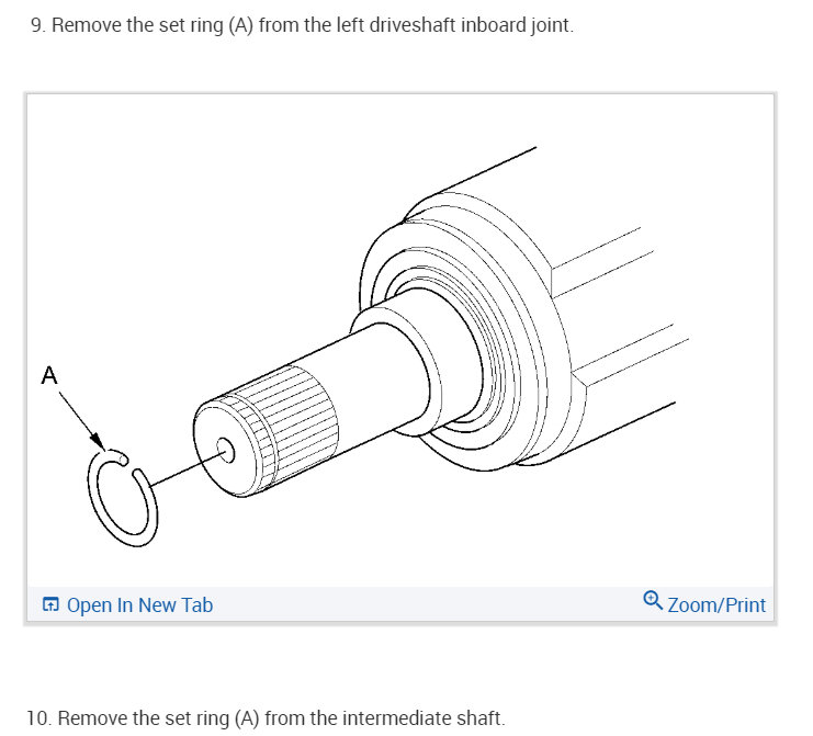

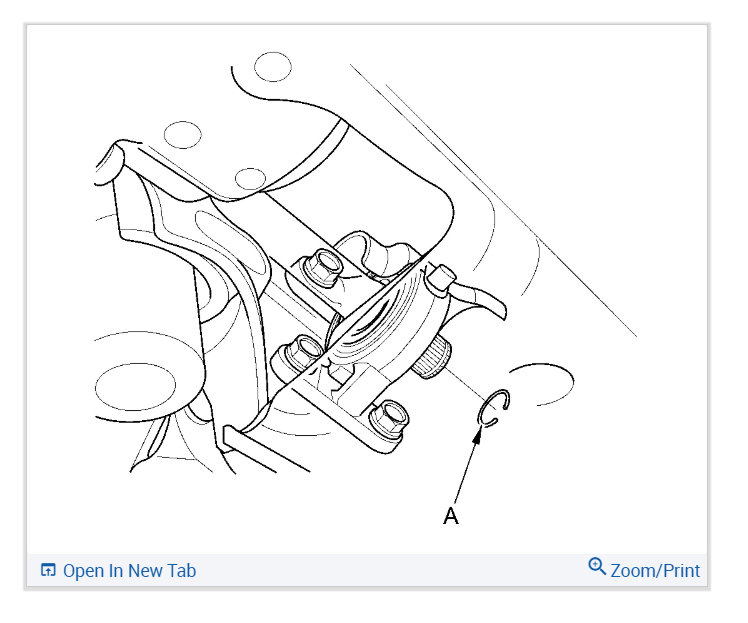

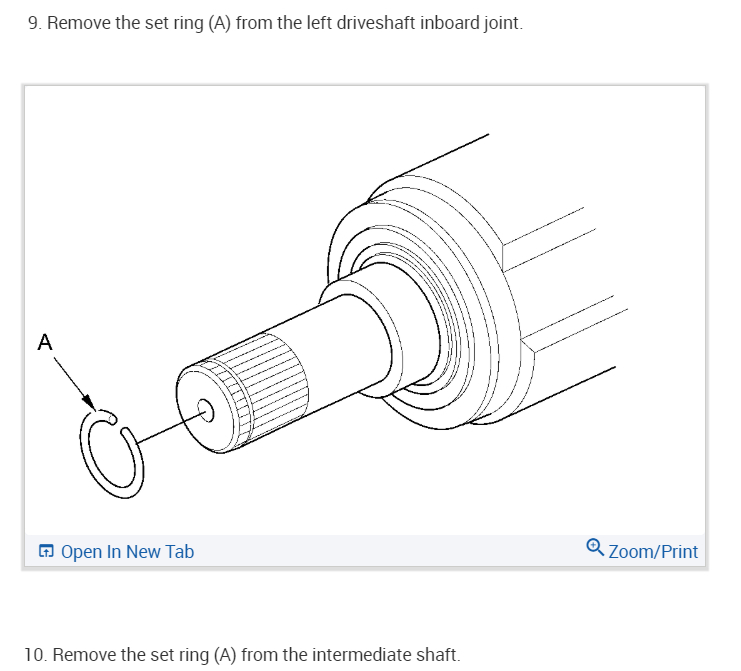

What happens is the CV axles wear out causing the vibration under load. here is a guide to help you change them out step by step with instructions in the diagrams below to show you how on your car:
https://www.2carpros.com/articles/replace-cv-axle
Start a new question for the EVAP codes

Thank you so much for your replay and the very thorough and informative installation instructions. Wow! I wish I was the least bit handy, I could save myself some money. I do appreciate seeing what's involved though.
Is this repair something any mechanic should be able to handle?
Do both axles need replacing? If not, how can I know which one is bad? Trying to keep costs down if possible.
Is it possible it's just a leaky/failed boot and not the entire axle needing replacement?
Also, I've read that some people have had problems with off-brand CV axles on Honda's and that subsequent OEM replacements fixed the problem. Any light you can shed on that? Do you recommend OEM? I'm sure they're more expensive.
One final question, now that you've identified the axle as the problem, I recall getting distracted in traffic and bumping a curb lightly with my right front wheel while making a right-hand turn. I was already slowed quite a bit but remember thinking "I hope it's okay." Nothing seemed out of place or wrong afterward, so I forgot about it. That was a couple months ago. Could that have caused the problem and it took awhile to manifest in the ride?
Many thanks once again!
John
Sep 2, 2019 at 4:10 PM
  • 55,433 POSTS
Yes, a mechanic will be able to handle it should cost about $180.00 labor. I would do both axles and use OEM axle rebuilds. You are looking for new CV joints when doing the rebuilt axles, cost should be about $75.00 an axle. Let me know.

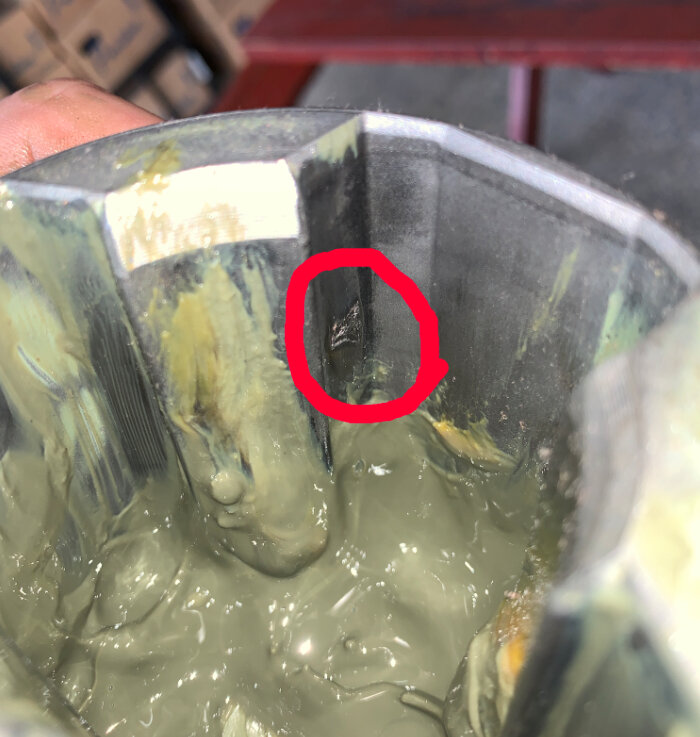

Ken's advice was 100% spot on. It was the CV axle on one side. I had both replaced and no more problems. I had a little difficulty finding a mechanic that would believe it was the CV, but finally was referred to a shop that knew exactly what Ken was describing and was confident in fixing it. They showed me the wear inside the part. Sorry, it's been a while and I'm rusty on details, but I was amazed how few people understood this problem. Good luck with your car and belated thanks to you Ken...really saved my bacon.
Apr 21, 2023 at 3:01 PM
JVT
  • 5 POSTS
I just checked my records. I replaced both front axles. Both of the inner CV joints had divots.
Apr 21, 2023 at 3:09 PM
JVT
  • 5 POSTS
Here's one of the inner CV joints showing the wear. Hard to believe that tiny mark caused all that vibration. Hope this helps!
Apr 21, 2023 at 3:21 PM
  • 55,433 POSTS
Good to hear, yep that is the kind of wear that will cause the vibration, thanks for the image to show anyone else having this problem. Use 2CarPros anytime, we are here to help. Please tell a friend.
