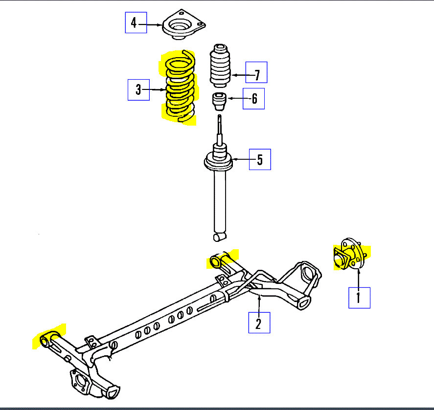

It's odd you only feel it through the seat and not the steering. Since this is the case, I would think it is being caused at the rear of the vehicle.
Have you checked rear wheel bearings? When you are accelerating, there is a weight transfer to the rear. Let me know.
I attached an exploded view of the rear suspension and highlighted things to check. I have a feeling the issue is in the rear. If it was a CV joint, front bearing issue, or anything related to the front, I feel you would notice it in the steering.
Also, I'm not sure where you are located, but if you live in the snow belt where salt is used in the winter, make sure the rear axle isn't damaged.
Jun 21, 2022 at 3:00 PM
