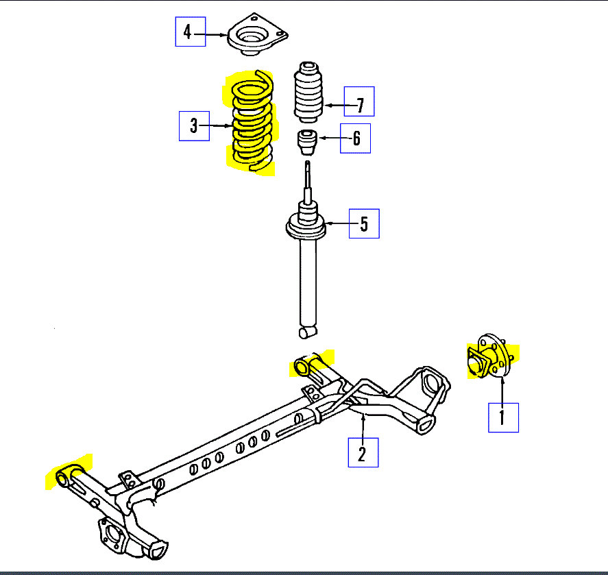

It's odd you only feel it through the seat and not the steering. Since this is the case, I would think it is being caused at the rear of the vehicle.
Have you checked rear wheel bearings? When you are accelerating, there is a weight transfer to the rear. Let me know.
I attached an exploded view of the rear suspension and highlighted things to check. I have a feeling the issue is in the rear. If it was a CV joint, front bearing issue, or anything related to the front, I feel you would notice it in the steering.
Also, I'm not sure where you are located, but if you live in the snow belt where salt is used in the winter, make sure the rear axle isn't damaged.
Jun 21, 2022 at 10:00 PM

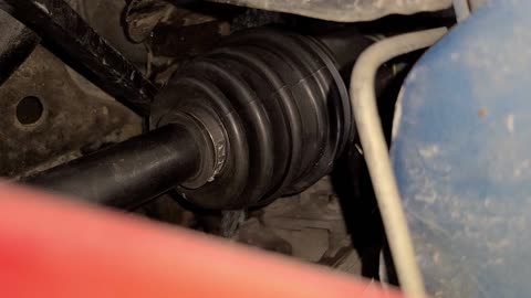

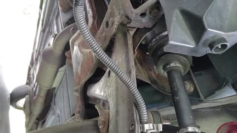

Thank you! I will try this. I've been underneath the car since my last email looking at things again. I put car in neutral and jacked up side i feel it's coming from. Turned wheel back and forth by hand while watching CV joint. There is some play i'm worried about with the joint that goes into transmission. I will try to get it on video and send it. I know some play is normal but i've got a gut feeling that mine isn't normal and the axle is jumping around. I can show you this on video with the car sitting still. Trying to find a way to mount my phone to record while driving so i can see if the shaking corelates with a jumpy axle.

Here's a short clip of the play transmission side. Does not appear to be coming from output shaft but rather the connection and cup to the axle. Everything is seated. It was a $50.00 axle so maybe it's junk, don't know. No clicking either from joints.
Jun 23, 2022 at 10:11 AM
  • 110,194 POSTS
Is that play at the input shaft where the axle pushes into the transmission? Are you sure it is fully seated?

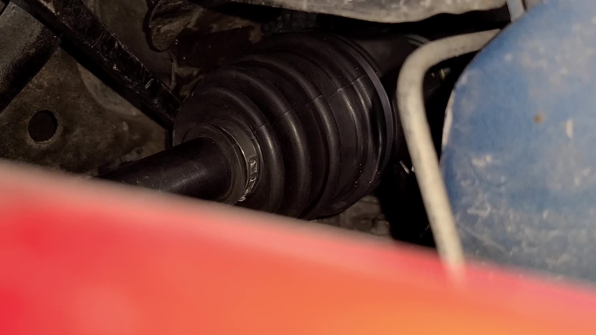

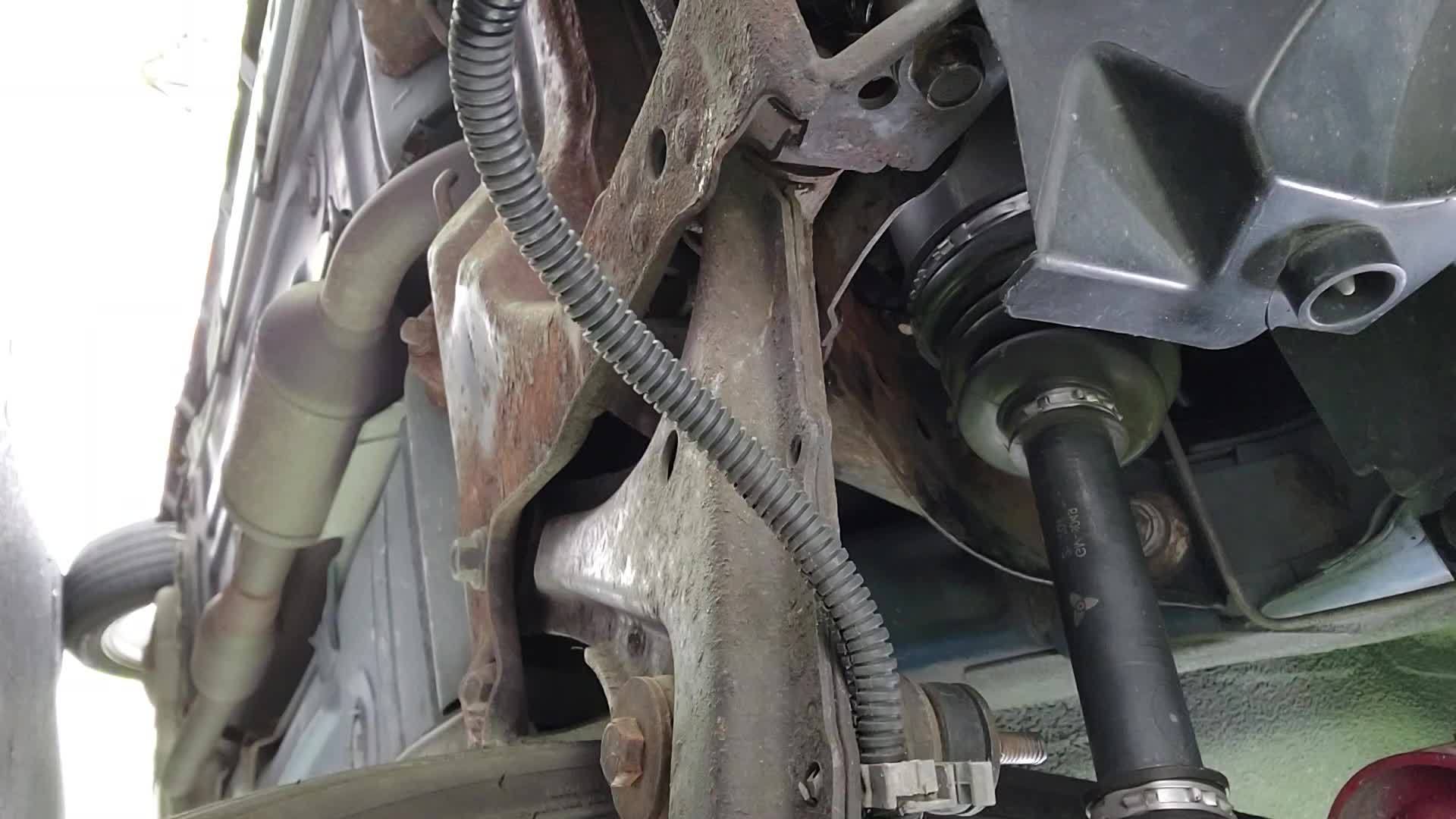

Yes, it is play at the input shaft but it seems to all be in the cup. I checked the shaft when I had the axle off, and it didn't move. It is fully seated. I looked at reviews online for the brand I bought and there are similar complaints about that inner joint. I ordered a new axle by car quest and spent more money for this one. I will return the other to rockauto. The shaking is coming from the engine jerking on the mounts. I believe the jerking is being caused by that inner cv joint. I had front end up and in gear and accelerated and just slight shaking. I then power braked to create some torque and sure enough there was the shake. I have a video of it I can send you later. I'll update you later this weekend after I replace the axle. Thanks for your replies!

Well, put the other axle in today. There were some obvious differences between the CarQuest and the track motive. The most obvious was the length. The track motive I had on was about an inch longer than the CarQuest and the inner cup was smaller. I chose to put the CarQuest on because t hats what I put on the other side about a month ago. The stub shaft just fit really loose inside the track motive. It fits great now and it's much tighter and no play anymore. It was a wise choice. But, sad to say it did not fix the problem. Still shaking from 30-50 under acceleration. I had stub shaft in the Trans and checked for play and there was maybe 1mm play but would that little bit of play in the Transmission because that much throw to shake the whole engine? I don't know what else to do. I forgot that I did have struts off and knuckles when I did ball joints and did not have front end alignment after thar I just marked everything. Also I loosened axle nuts and retorqued them on both sides. I am hearing slight humming now. Maybe I'll throw some dollar signs at the hub bearings or should it be front end alignment?
I'm attaching video before I changed axle. You can see in video first seconds running car no power braking. Then I power brake and you can see car steering to shake also exhaust and everything. I just really hope it isn't the tranmission. Never had any problems with it. Had car from brand new. Was taken care of.
