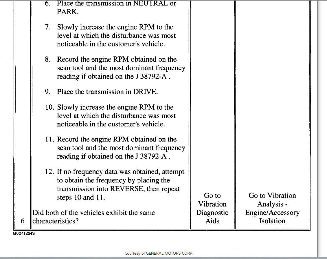

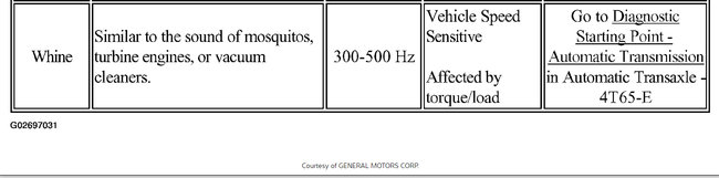

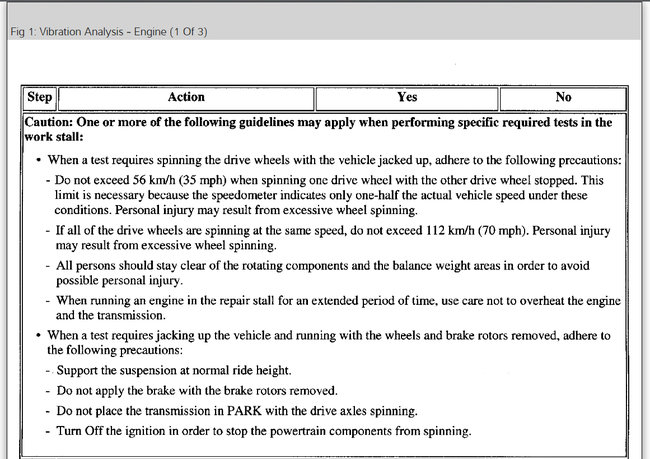

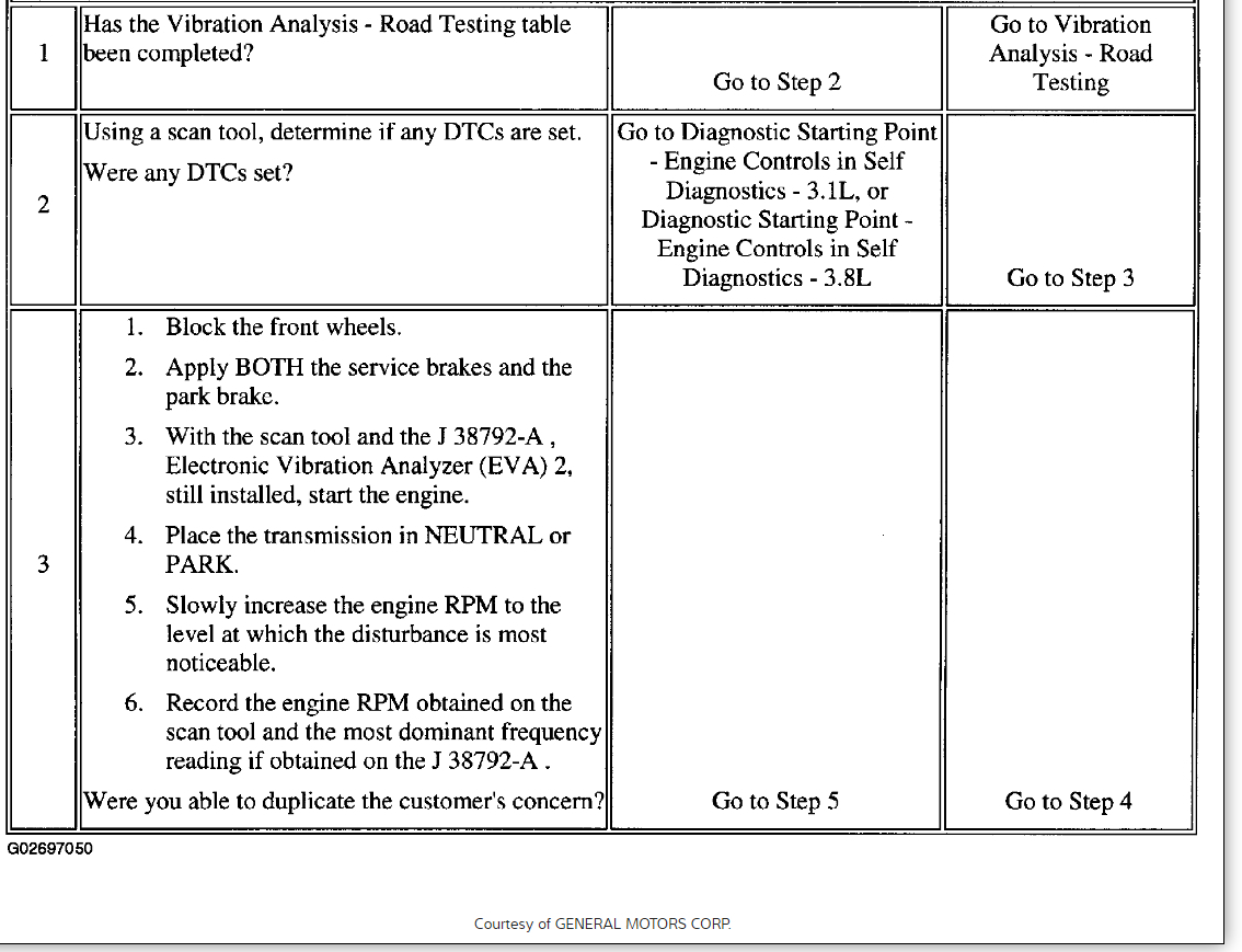

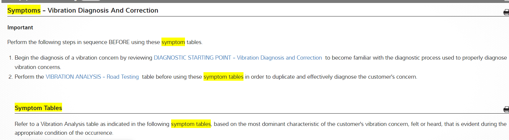

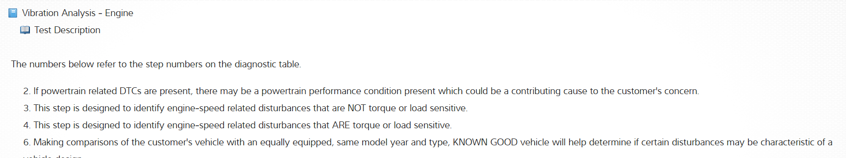

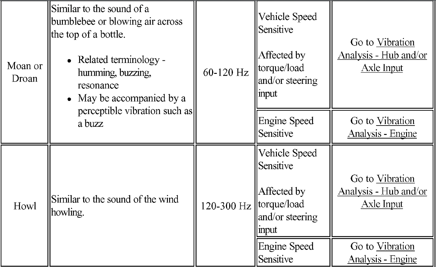

My car when I give it gas, when I let off it stops. just wondering what it could be. any help appreciated!
Mar 3, 2019 at 4:58 PM
SCGRANTURISMO
  • 4,897 POSTS

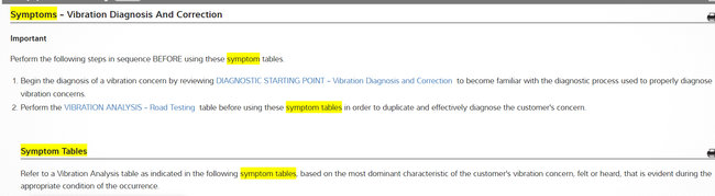

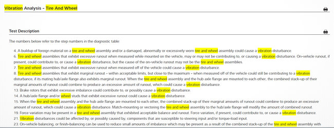

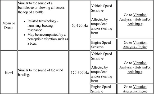

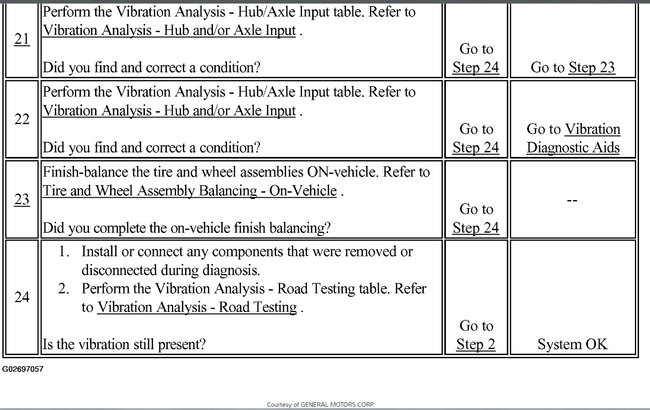

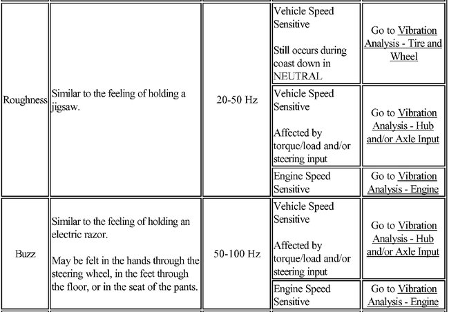

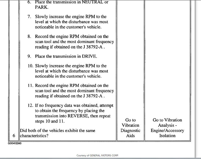

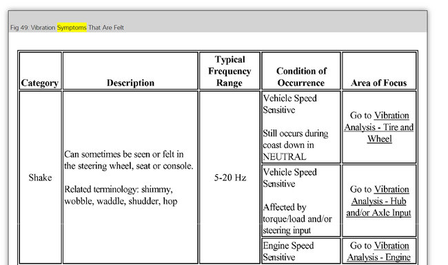

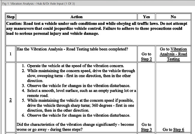

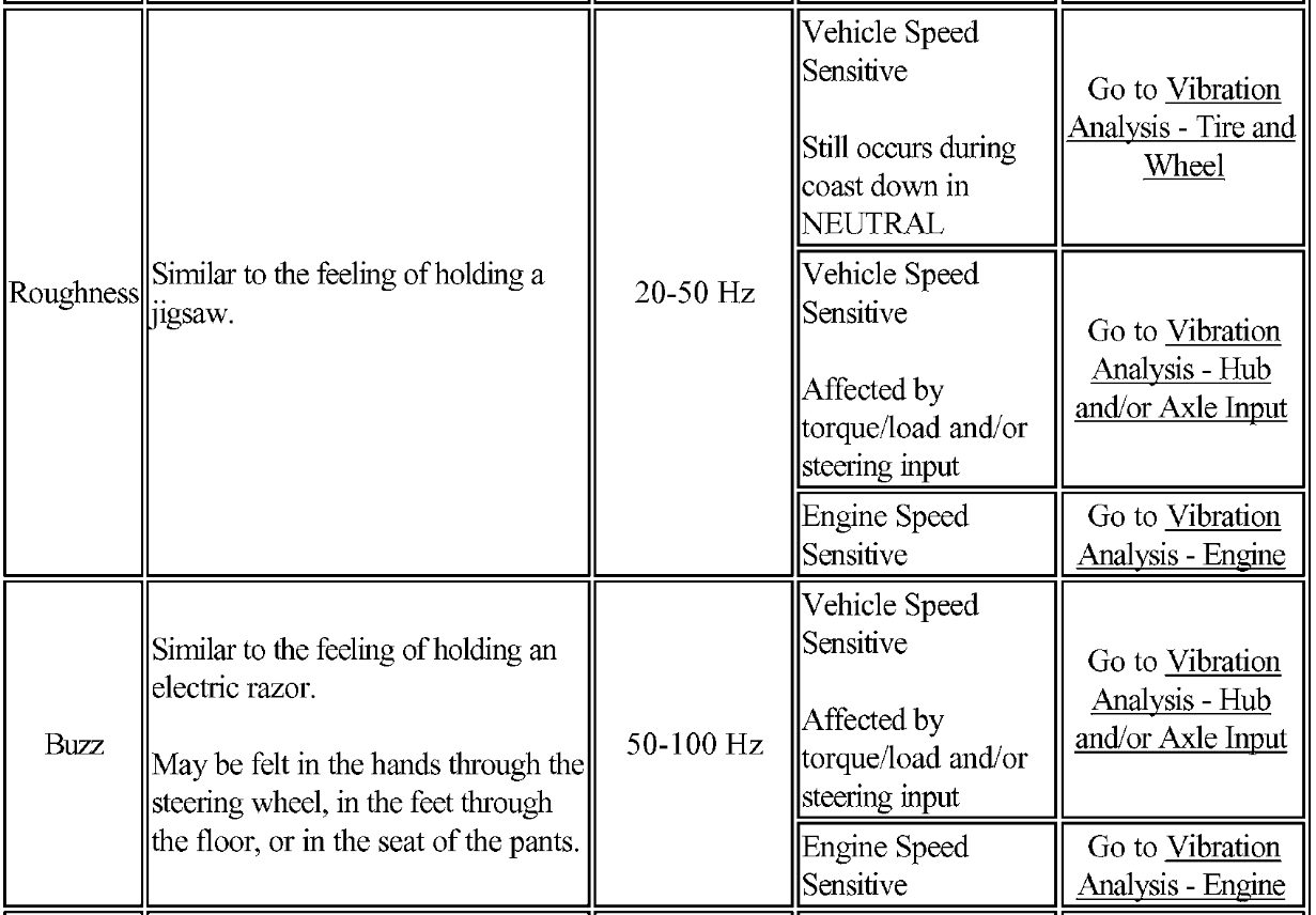

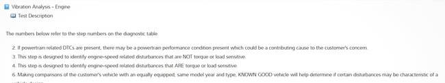

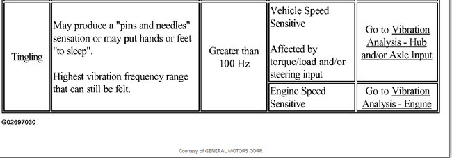

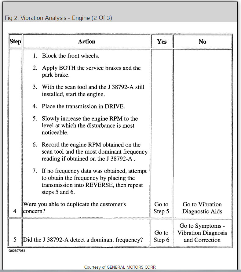

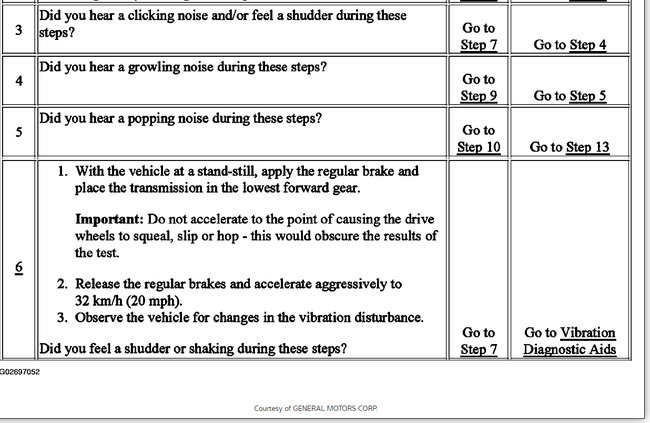

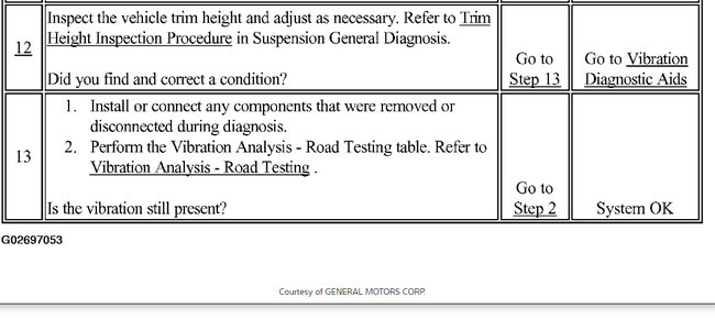

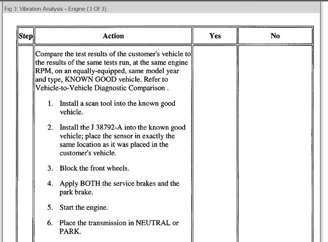

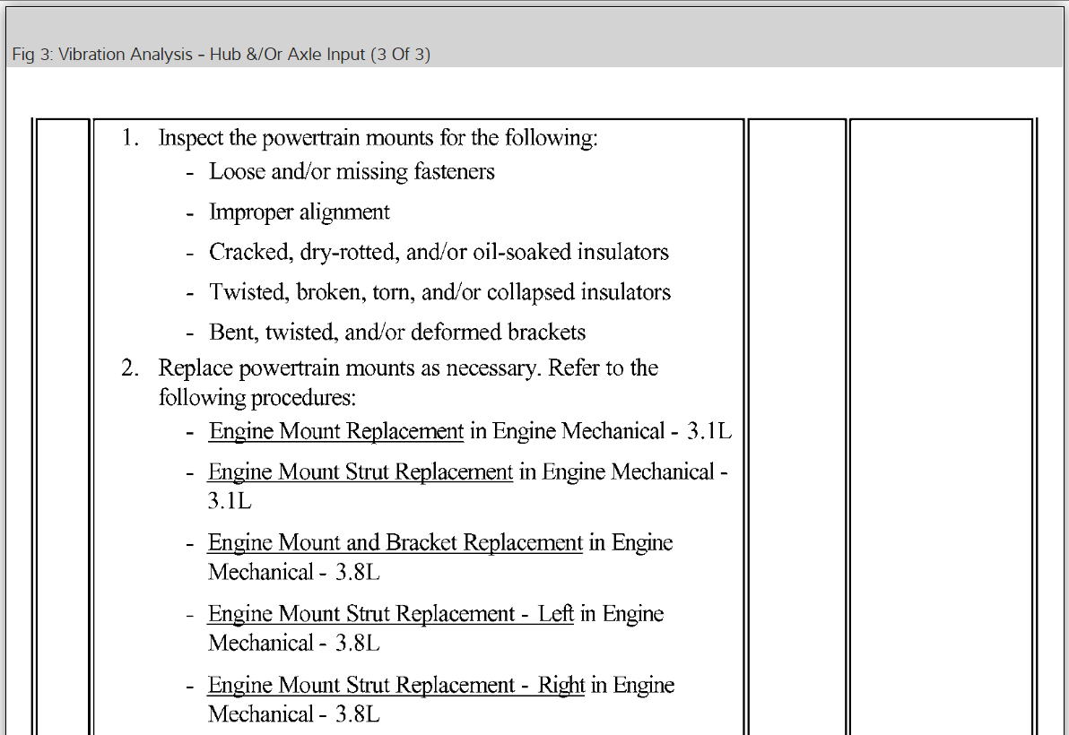

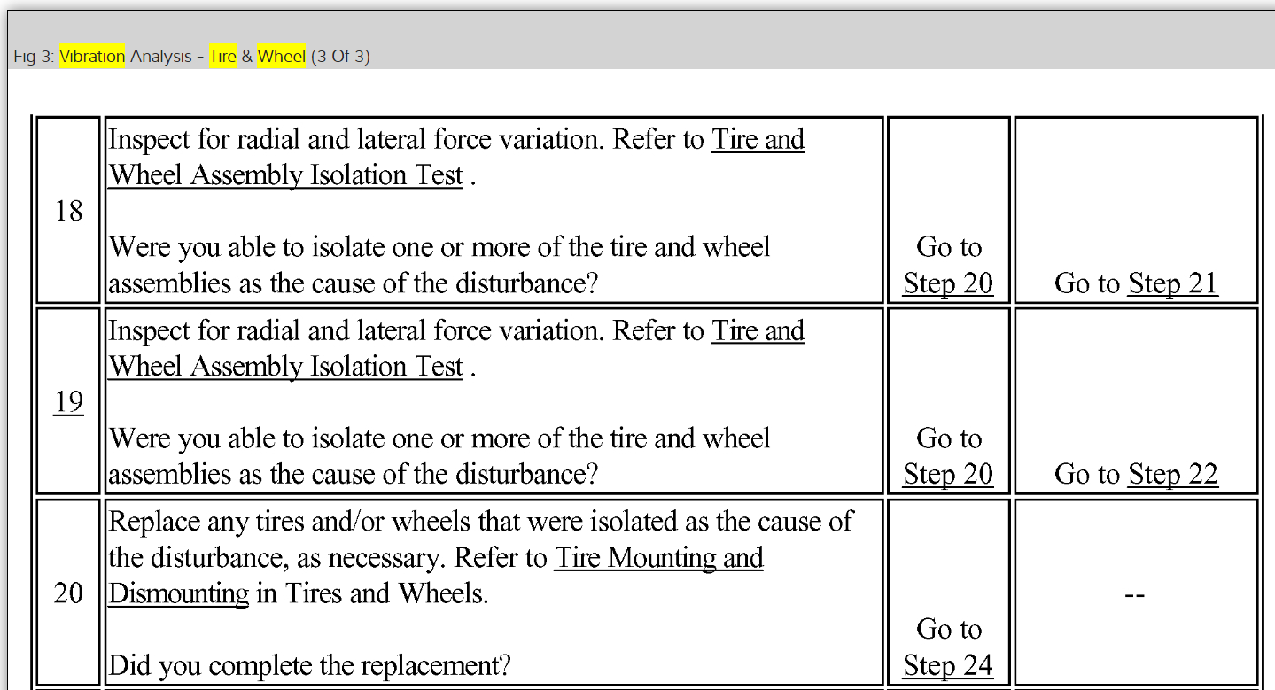

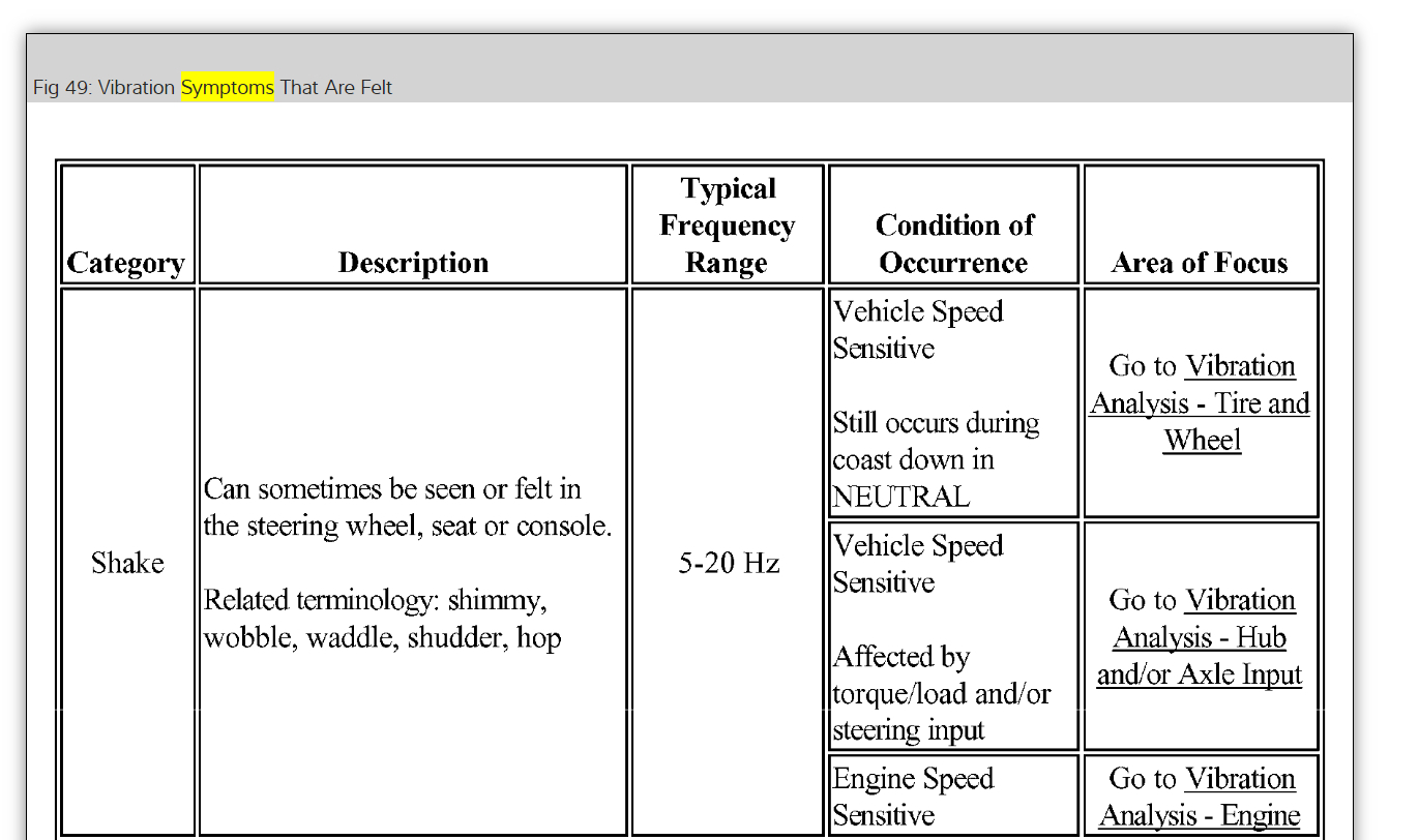

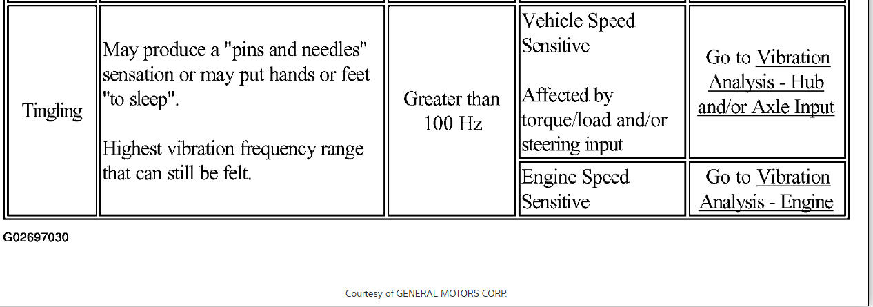

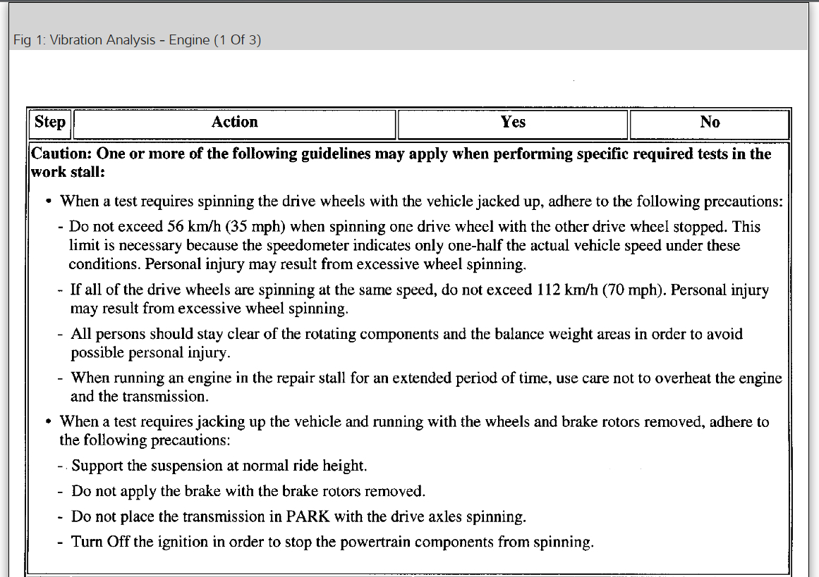

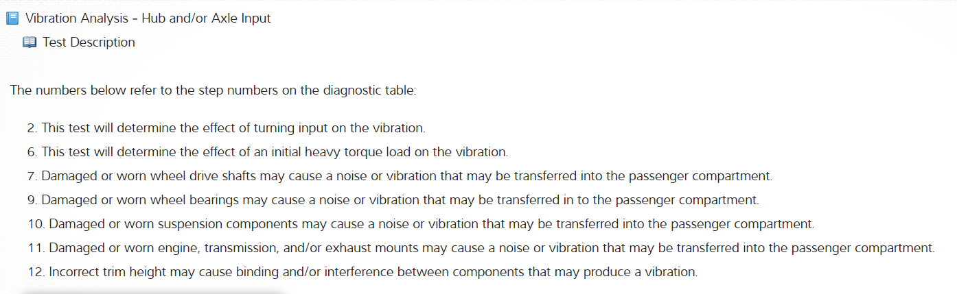

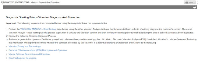

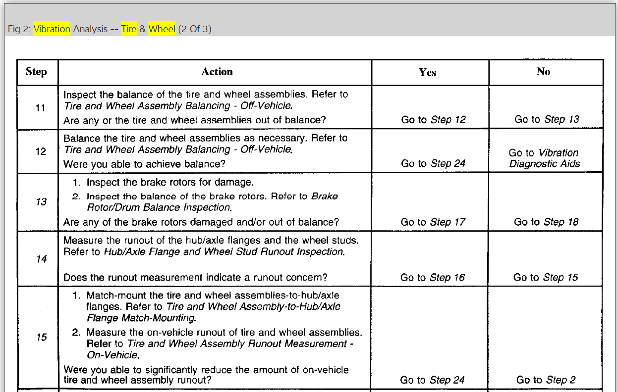

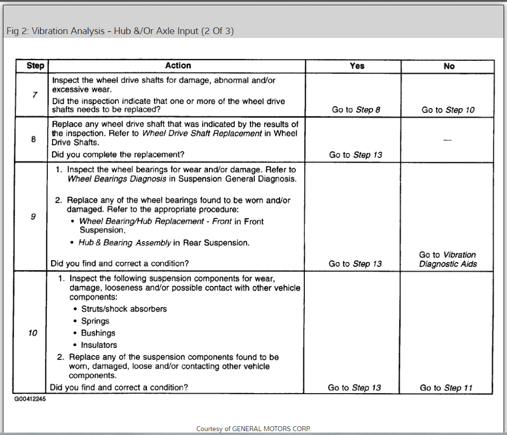

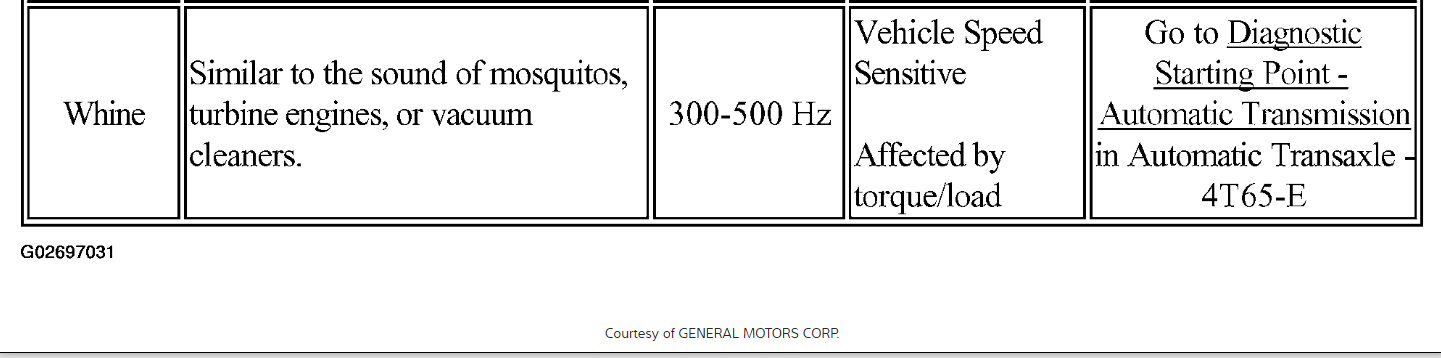

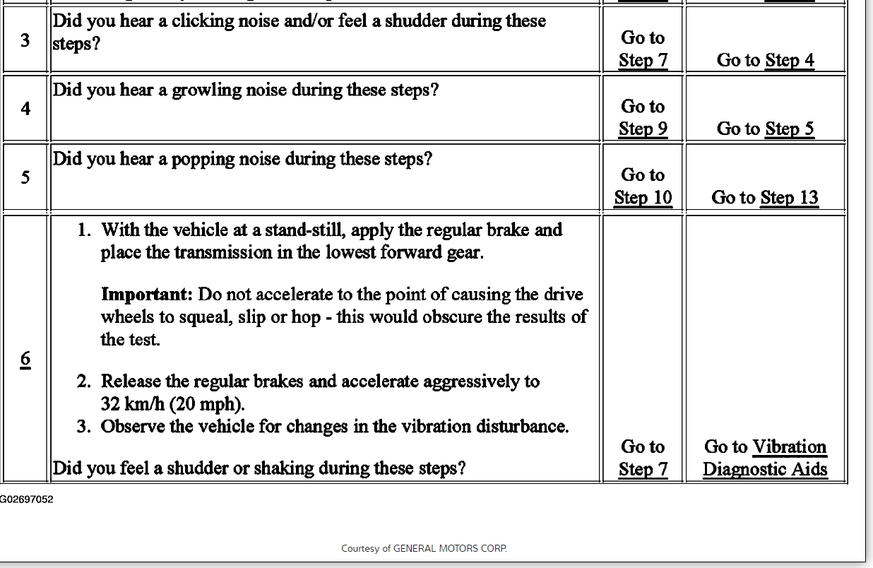

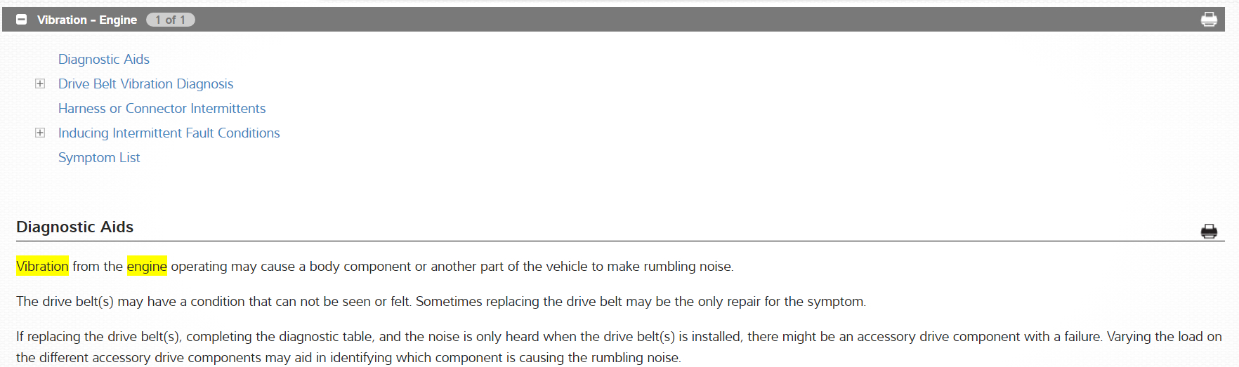

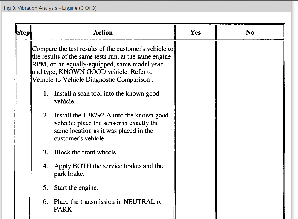

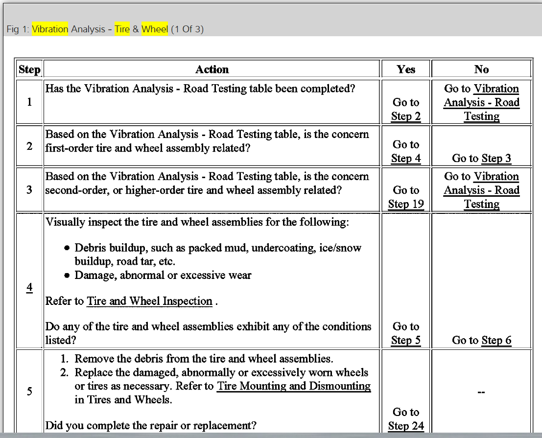

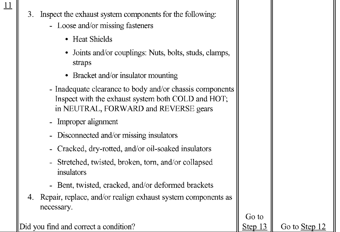

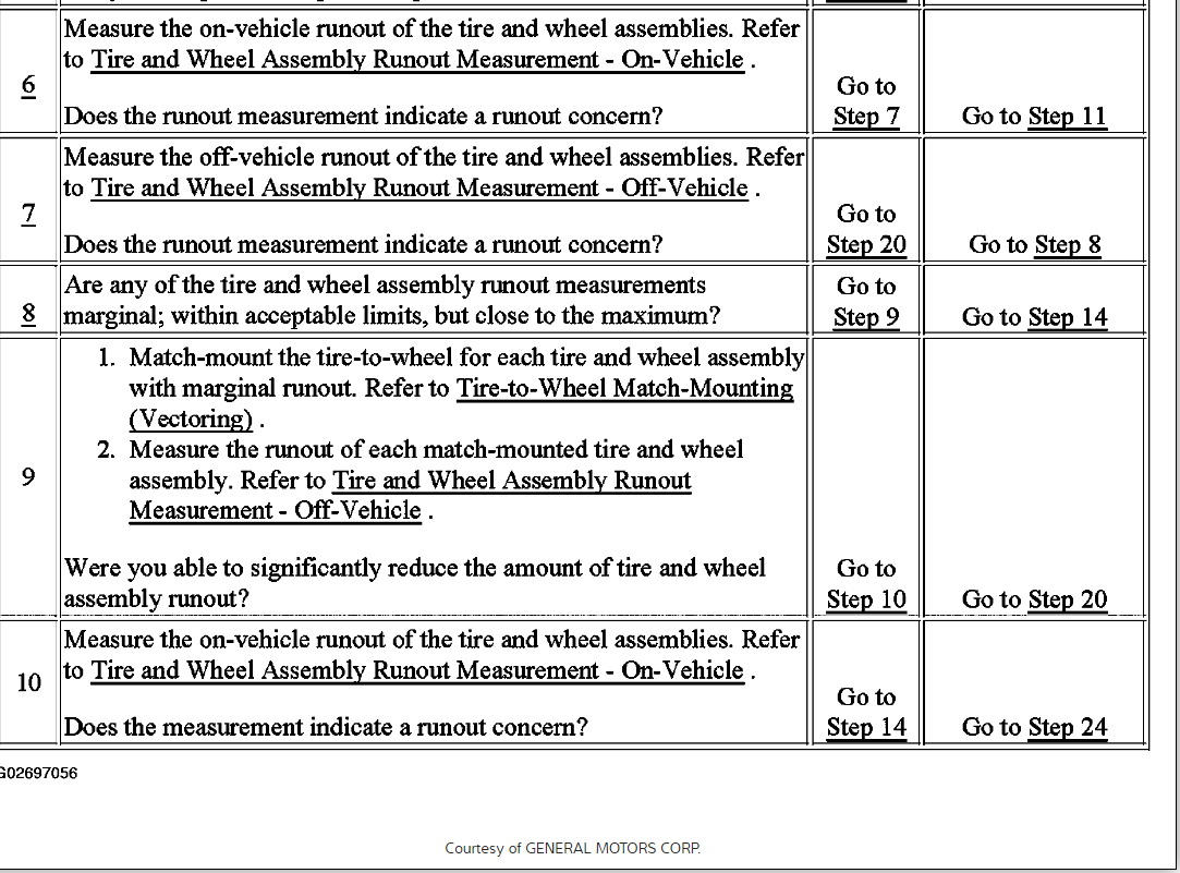

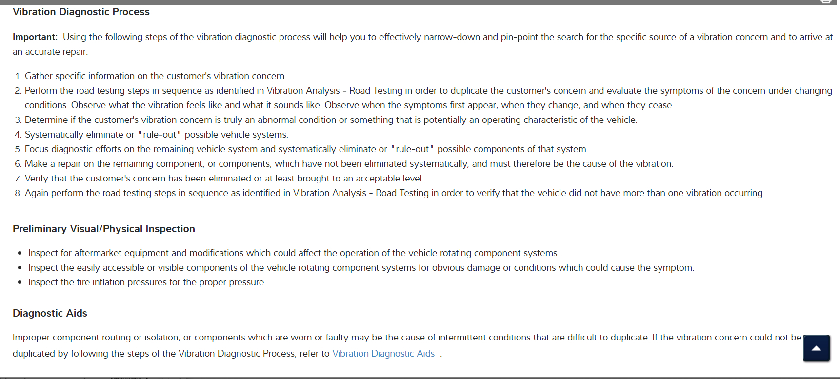

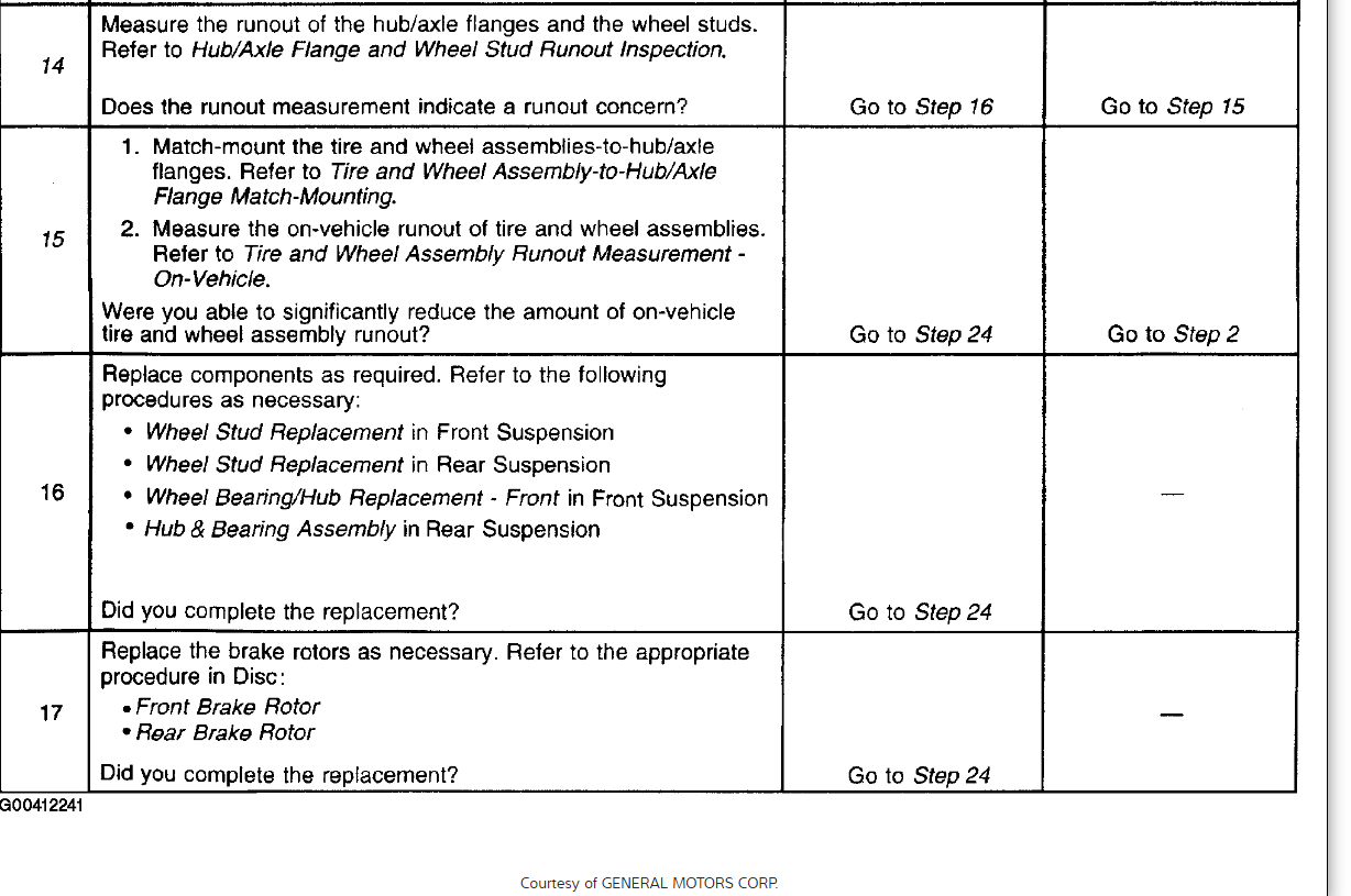

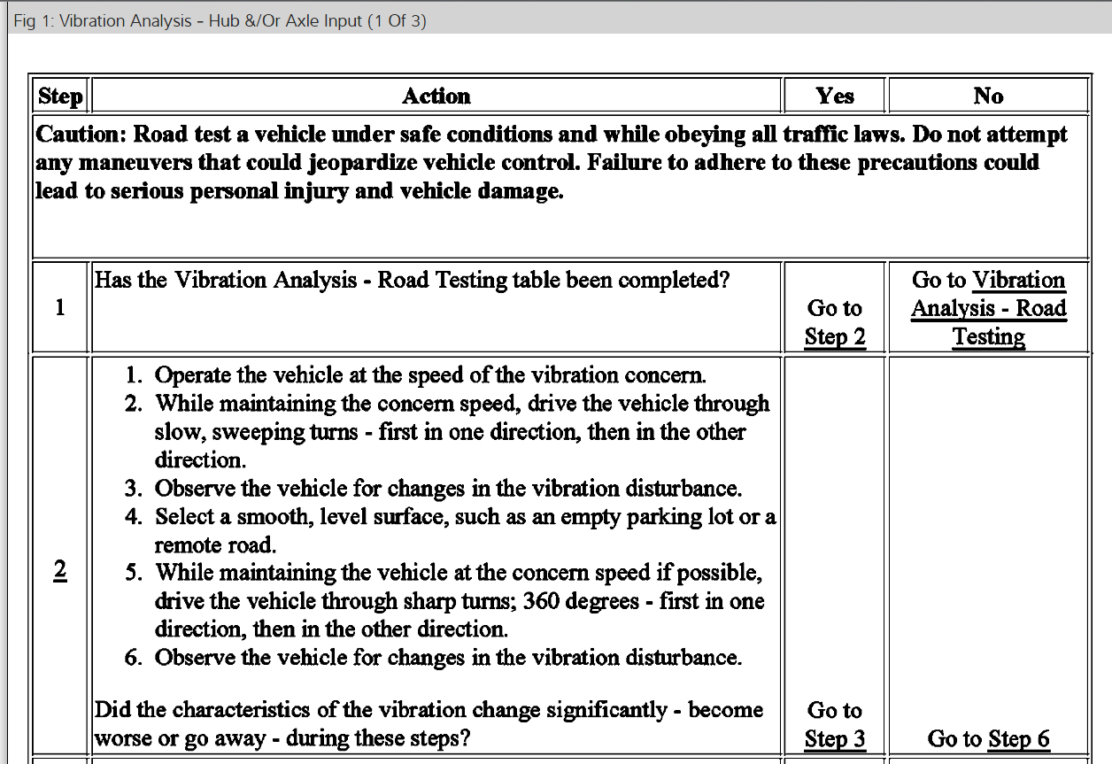

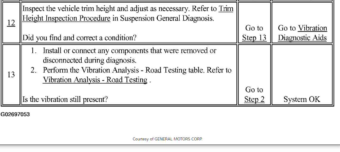

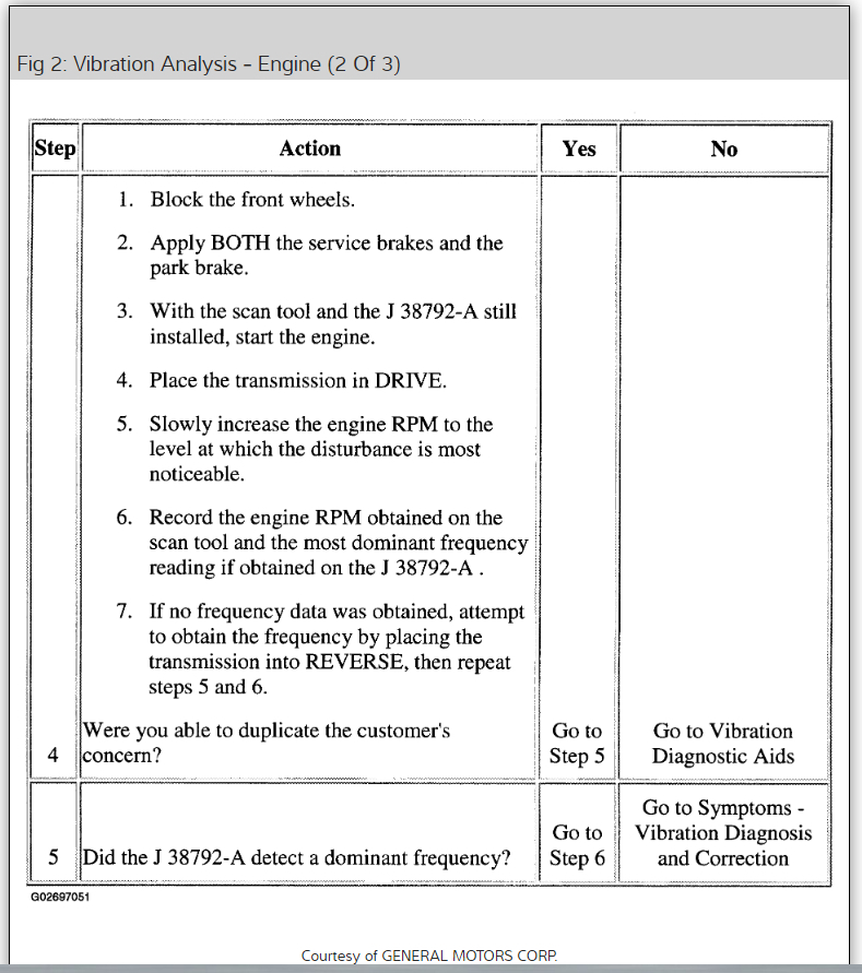

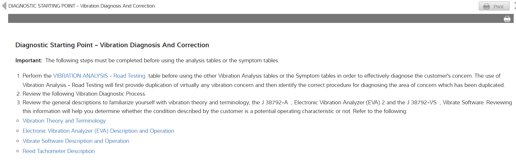

This sounds to me like it could be a problem with the motor mounts. But to be sure I have included a comprehensive vibration troubleshooting guide for you in the diagrams down below. Please go through it and let us know what you find out.
Thanks,
Alex
2CarPros
Mar 3, 2019 at 7:41 PM
HARRY SETT
That's what my cousin said it was. so ill have to check the motor mounts.
