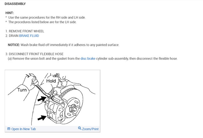

steering wheel shakes when applying brakes at higher speeds?
118,000 MILES • 6 CYL • 2WD • AUTOMATIC
ANDYLAT

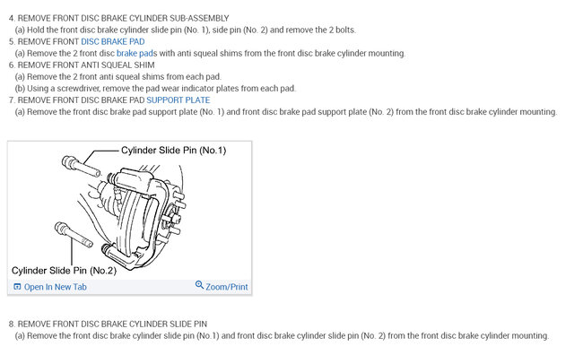

Steering wheel shakes when applying brakes at higher speeds?
Apr 6, 2023 at 1:53 AM
  • 55,688 POSTS

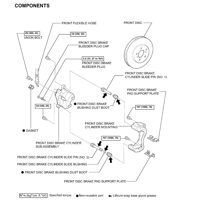

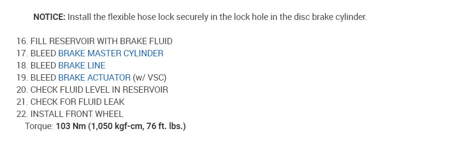

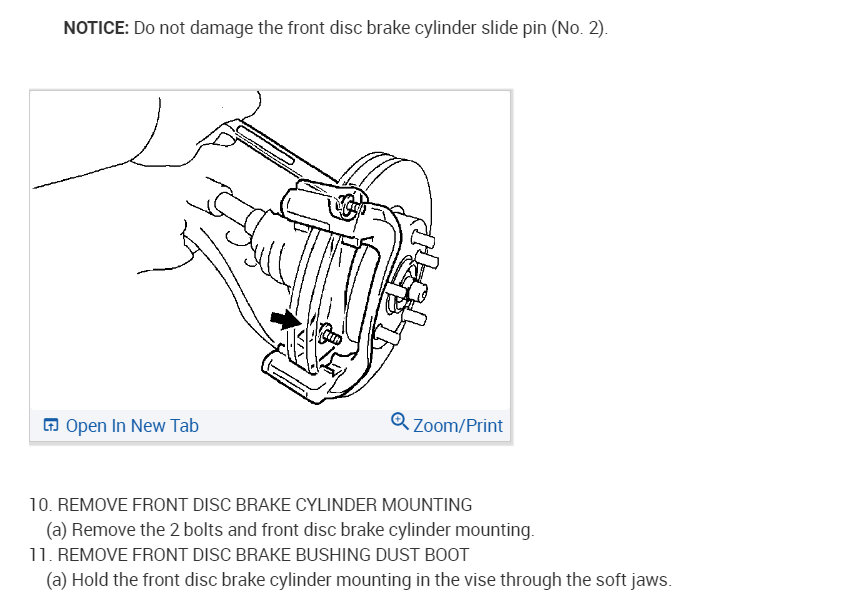

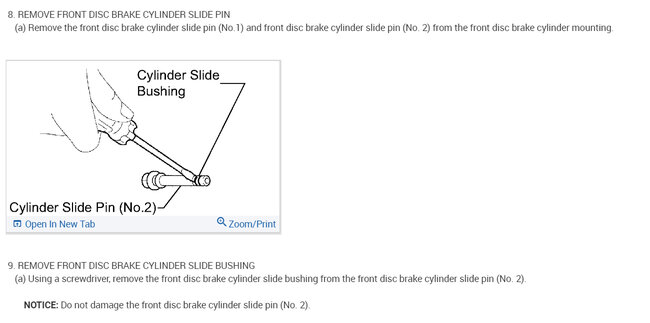

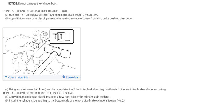

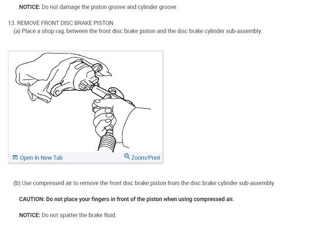

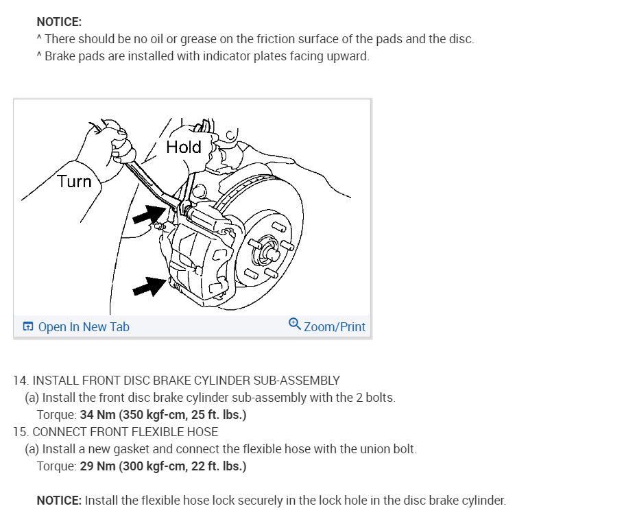

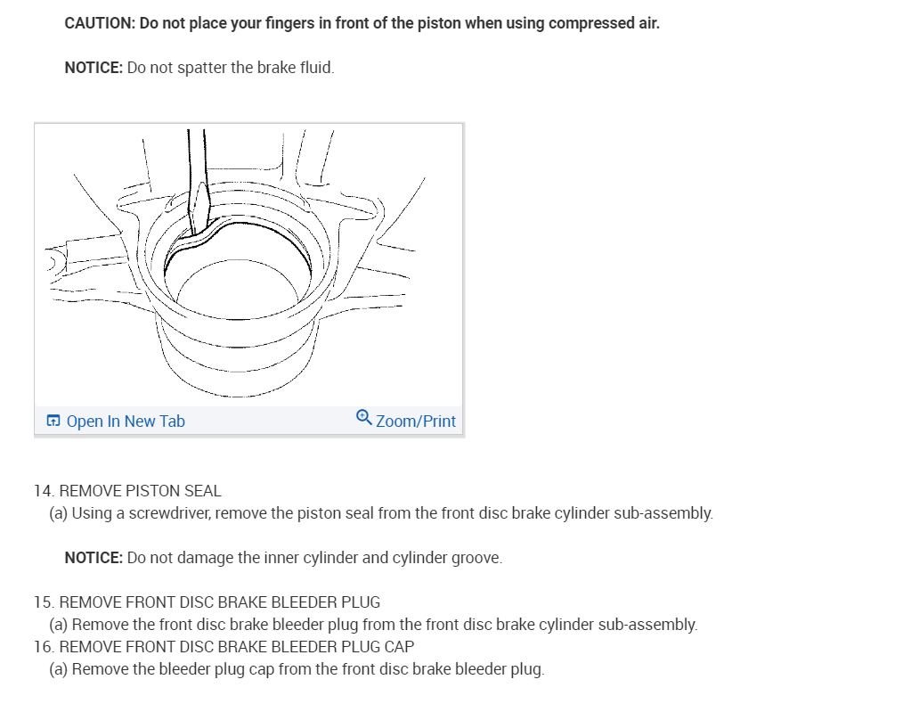

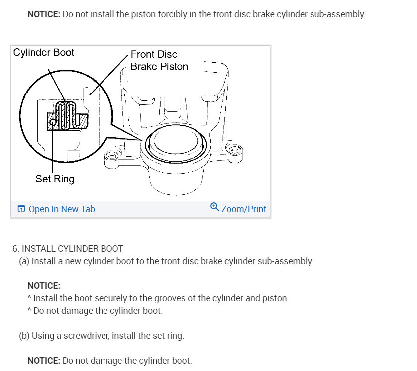

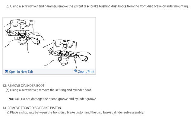

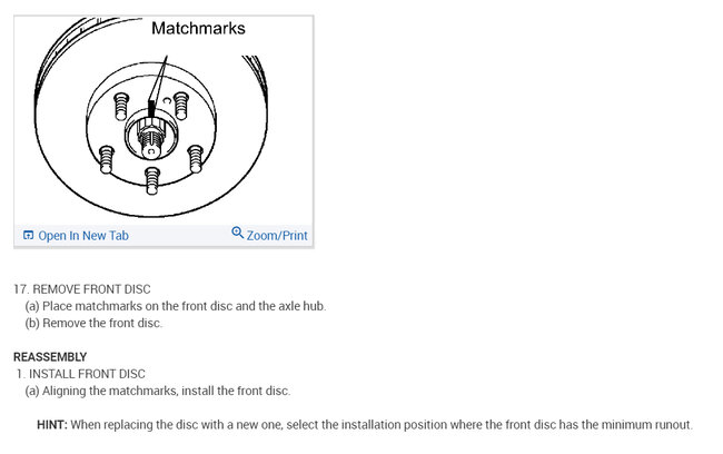

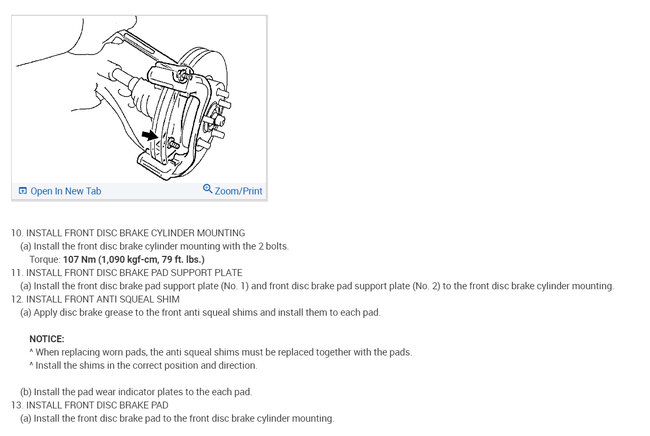

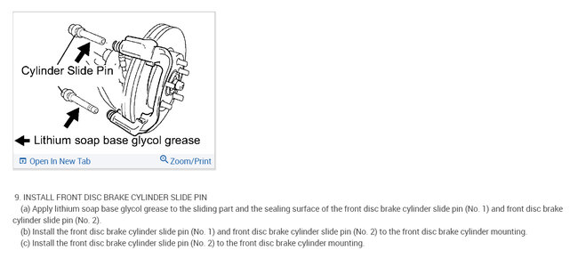

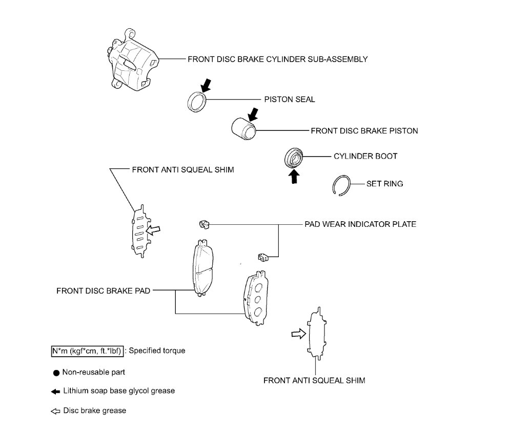

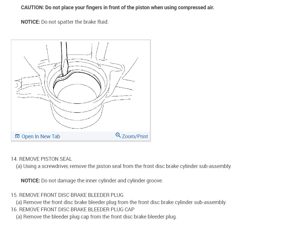

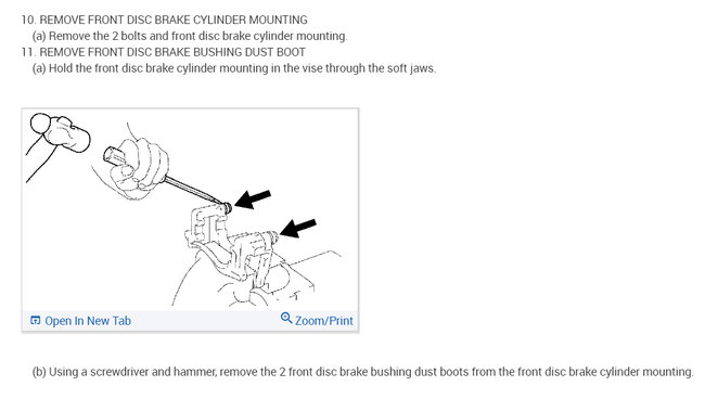

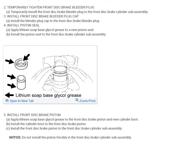

This is common when the front brake rotors and pads need to be replaced. This generic guide can help walk you through the steps and I have included how to change the brakes out in the images below for your car.
Check out the images (below). Please let us know if you need anything else to get the problem fixed.
