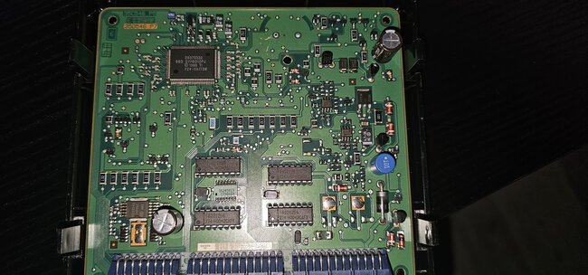

I replaced the fuse and got a new Anti-Theft Vats Security Module but still SUV starts and immediately shuts off, and no response when I press the lock or unlock button on key fob.

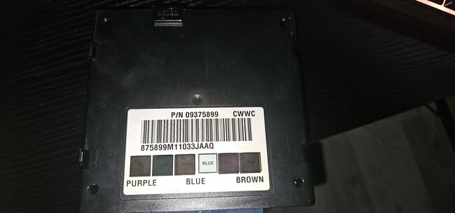

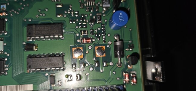

Bought a CAN scanner but due to me unhooking battery and the truck starting but immediately stalling after starting, I have no codes or lights on the dash at all but the security light, I did by one used BCM from ebay to see if something would happen. I notice that the one I pulled out my truck, had a couple burned spots on it, idk if they should be there or overtime it happen

A used BCM will need to be programmed to the truck, this is why I suggested Flashmasters. Also, I cannot see the burn marks on the board but any burn marks are not good. I think you found the problem.
