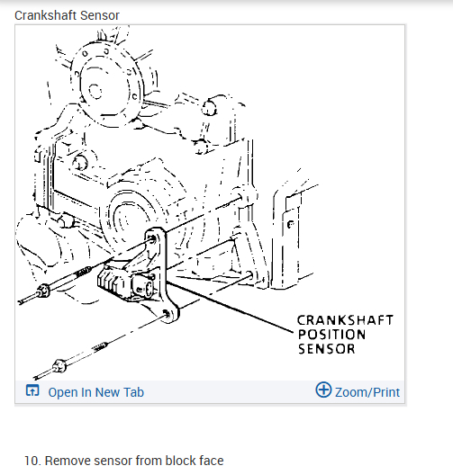

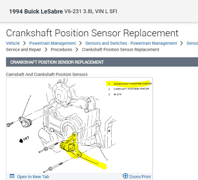

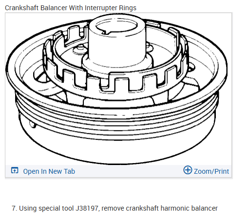

It sounds like you have a faulty crankshaft position sensor. When they begin to fail, they are adversely affected by heat. Heat causes expansion. The wire winding within the sensor expands and causes a disconnect, shutting off the engine. Once it cools, the connection is once again complete, and the vehicle runs.
Take a look through this link and let us know if the link's description mirrors what you are experiencing.
If it does, this is what I would replace. Here is a link that explains in general how it is done:

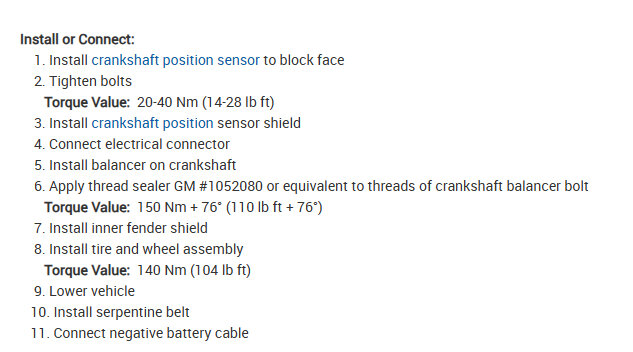

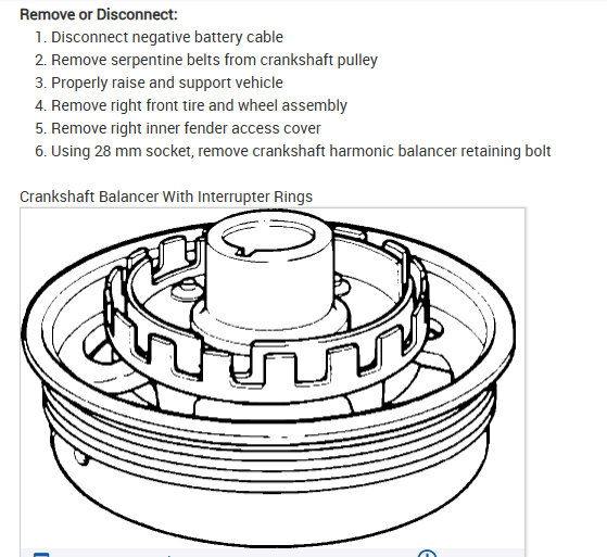

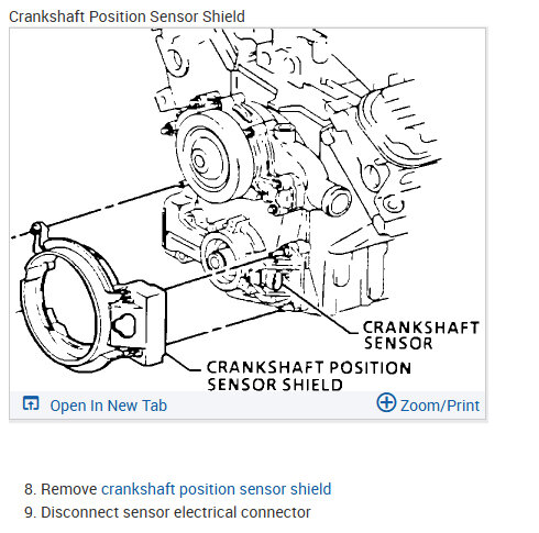

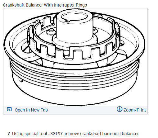

On this vehicle, the harmonic balancer will need to be removed. If you look below, I have attached the directions specific to this vehicle. I can't guarantee it without further testing, but I am very confident this is the problem.
Let us know if this helps or if you have other questions.

I will second the crank sensor as being the issue on this. That is a very typical failure mode. The internal electronics fail and generate heat and shuts off. Then you need to wait for it to cool down before it works again, and being bolted to the engine means it has to cool as well. A quick way to test if it's the sensor, go to a store like Walmart or best buy and get a can of "canned air" or "computer duster". That stuff is a different version of the AC refrigerant in your car. Now for the test. First locate the sensor so you are sure where it is. Now put on gloves and some eye protection. Take the car for a drive until it stalls out. Now take the can of "air" and flip it upside down and spray the sensor with the liquid that comes out. Be careful that you spray only the sensor and not yourself. Spray it for about 5 seconds or so and let it evaporate off. Wait 10 seconds and spray it again. Now try to start the car. If it starts up without the long wait you have the answer that it is the crank sensor.
