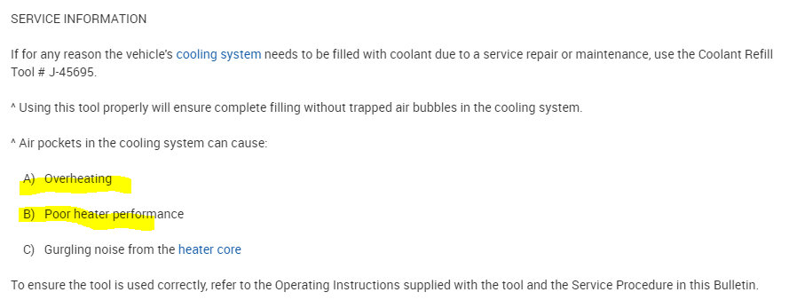

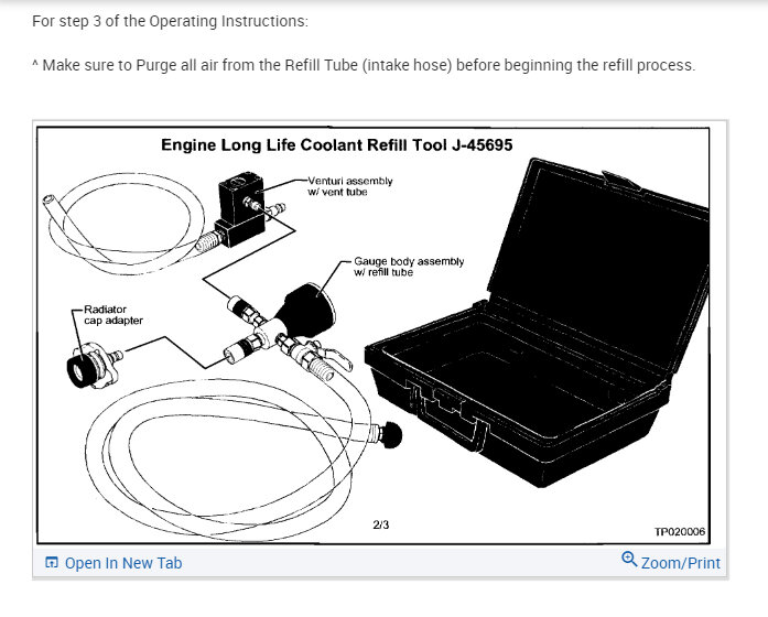

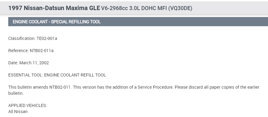

Even if the t-stat is stuck shut, you should get heat. To me, it sounds like there is an air block in the cooling system. That can prevent the heater from working.

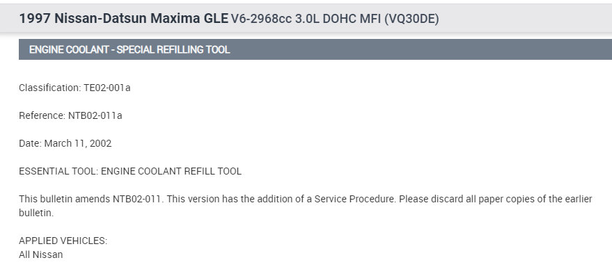

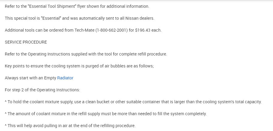

Also, when refilling this system, the manufacturer recommends the use of a coolant refill tool, Nissan tool # J-45695. See the technical service bulletin below.
As far as the heater issue is concerned, this is my first suspect. As far as the thermostats are concerned, because they are not expensive, I do suggest replacing it.

Also, I feel once the air is removed from the system, the heater will start working again. It may not overheat either since you flushed the radiator.

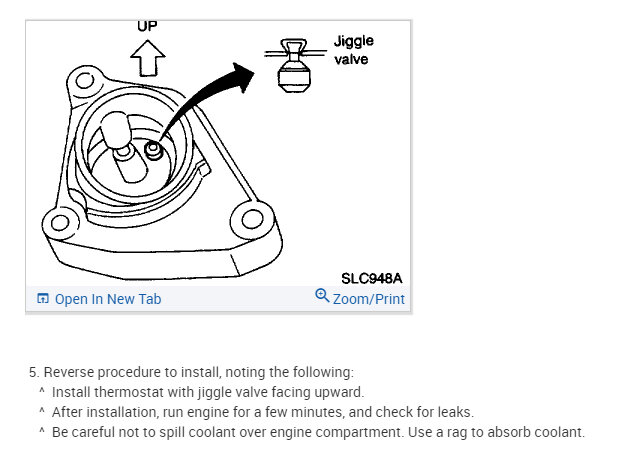

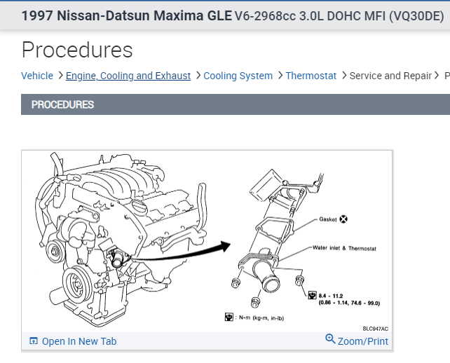

After changing my thermostat in the car it will not crank now.
Jul 1, 2023 at 5:39 AM
  • 110,244 POSTS
When you say it won't start, do you mean the starter won't engage or it does, but the engine fails to start?

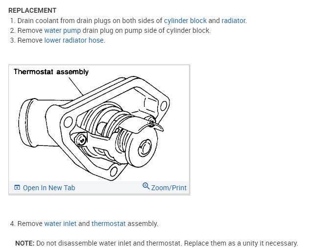

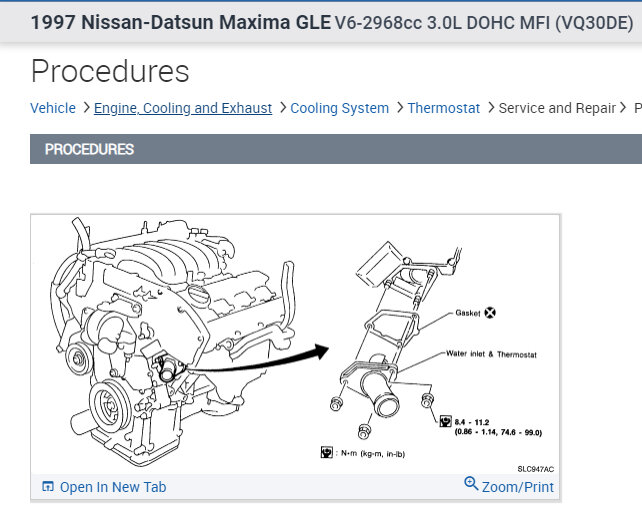

Also, I attached the directions below for replacing the thermostat. Let me know if there is anything you may have missed or if you have questions,
