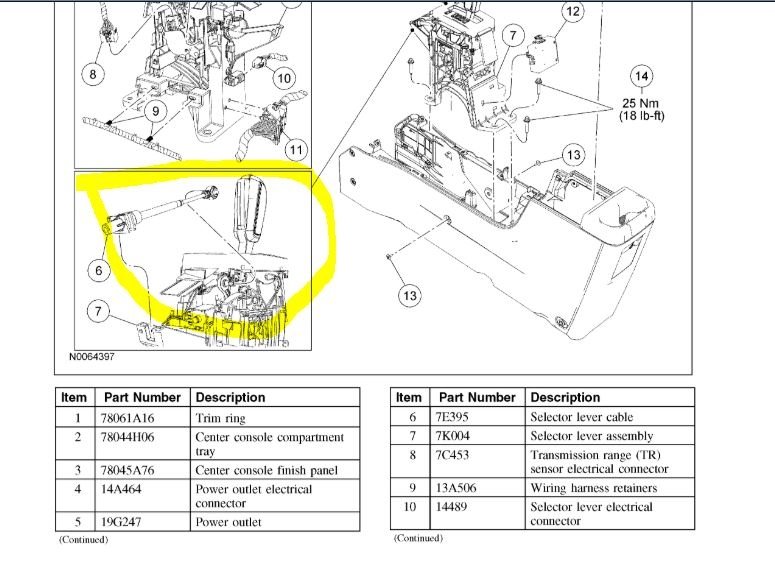

The other night I ran over a tree trunk pretty hard on the road. It knocked out my alignment so I had the alignment done and tires balanced. I had it done at a tire shop and when I got my car back I got in and realized my car was rolling in park mode. I also realized that my shifter was a lot easier to move too. All the gears work except park. Side note: this is a hybrid vehicle.

Good afternoon,
Chances are you have damaged the shifter cable. That is what controls it going into park.
You may have done more damage than you thought.
I would have this checked at a shop to check the exact issue.

The problem I am having is that I cannot find the shifter cable on the transmission and am starting to believe there isn’t one since it’s a hybrid and has a ECvt transmission.
Mar 3, 2019 at 5:44 AM
Okay, there is a shift cable from the shifter out to the transmission. I attached a picture for you.

Thank you! But where can I access that on my car?
Mar 3, 2019 at 7:12 AM
You need to remove the console and the shifter to access the cable. The other end goes to the transmission. You may need to go under the car and look at the cable where it comes out of the body and follow it to the transmission.

I have a hybrid and my car has been rolling in park. I cannot find the gear selector cable connection to the transmission to check the connection. Can you please help me locate the connection to the transmission?

Good afternoon,
I found a recall on this issue for you to review.

I went to a Ford dealership and they searched my VIN number. They did not find any recalls.
Mar 11, 2019 at 10:50 AM
I would have them check it anyway.
