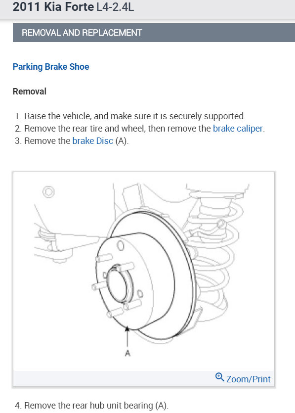

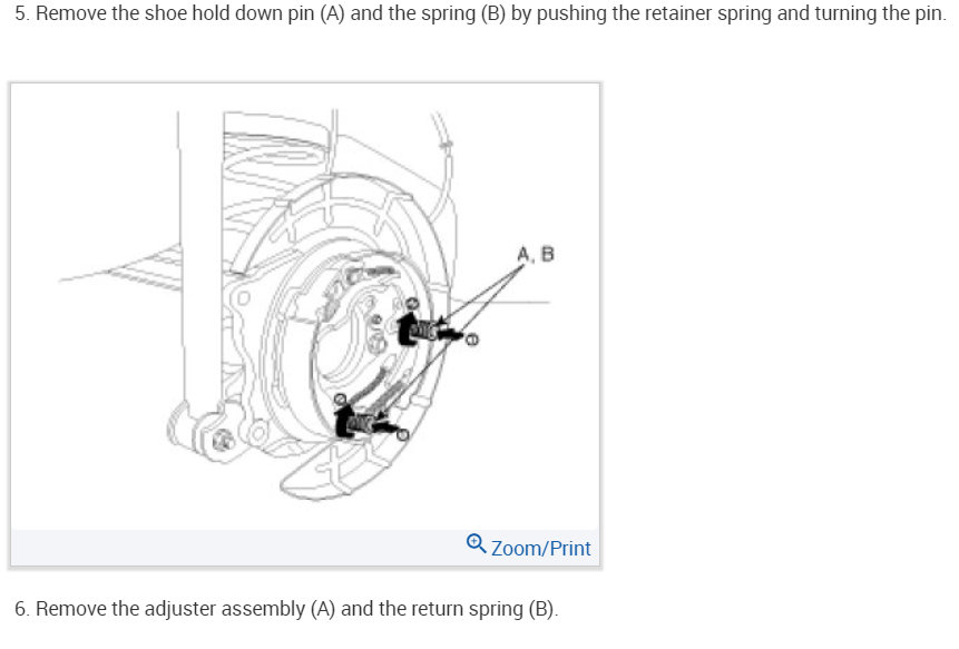

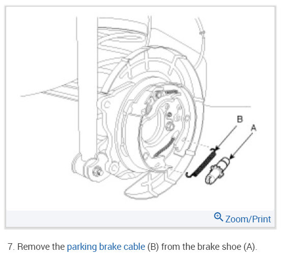

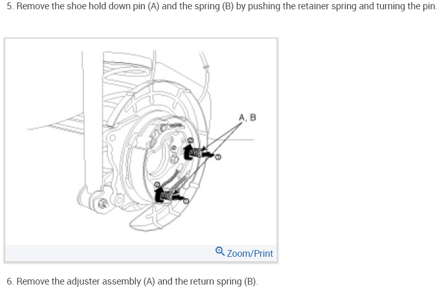

My car is rolling back in neutral with the emergency brake on. I parked in a normal parking lot and the car rolled about three feet backwards.
Aug 13, 2018 at 12:54 AM
  • 55,433 POSTS

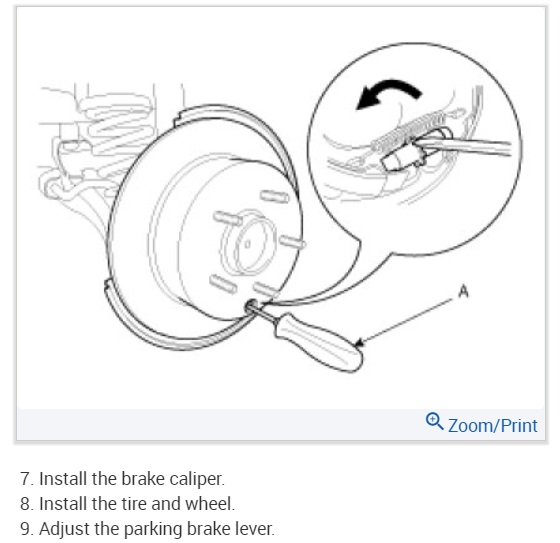

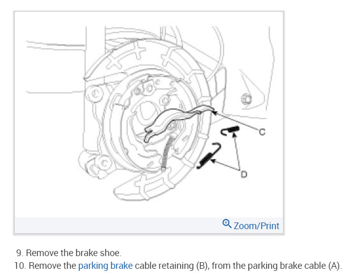

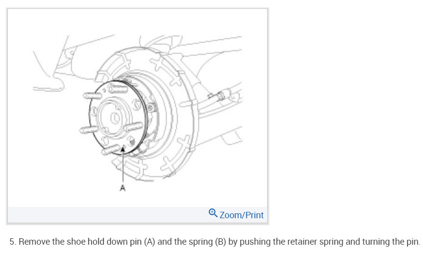

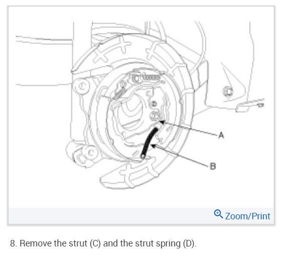

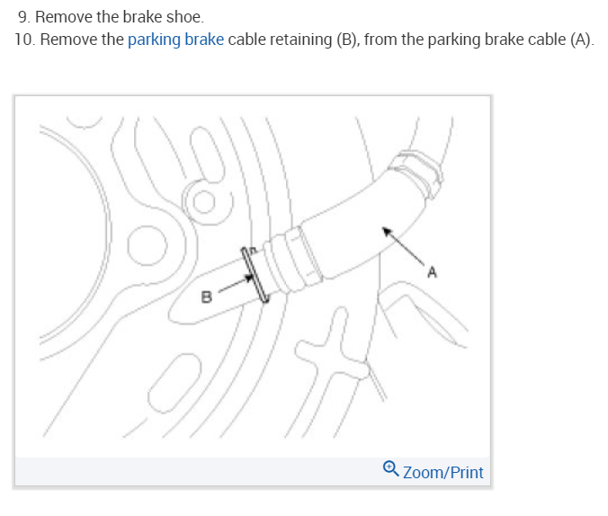

It sounds like the emergency brake shoes are worn and need to be replaced. Here is a guide to help you see what you are in for doing the job with diagrams below to show you on your car:
https://www.2carpros.com/articles/parking-brake-shoe-replacement
