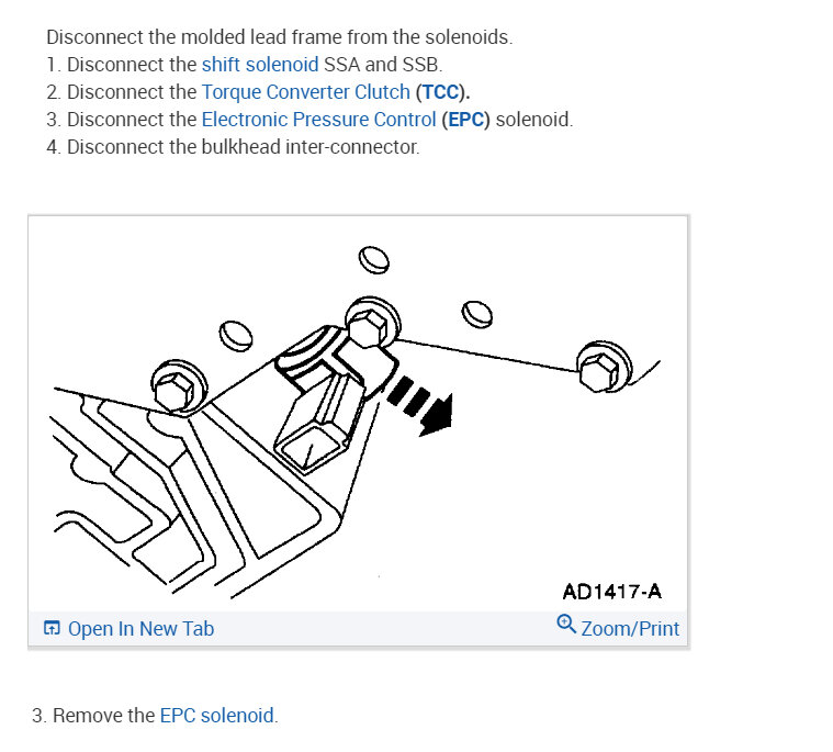

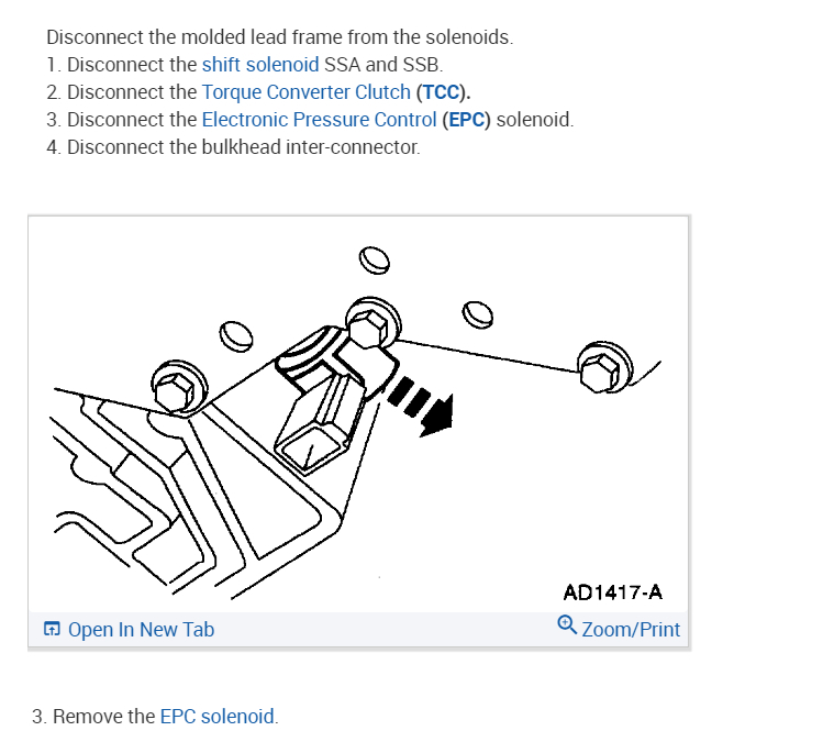

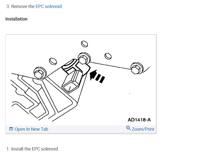

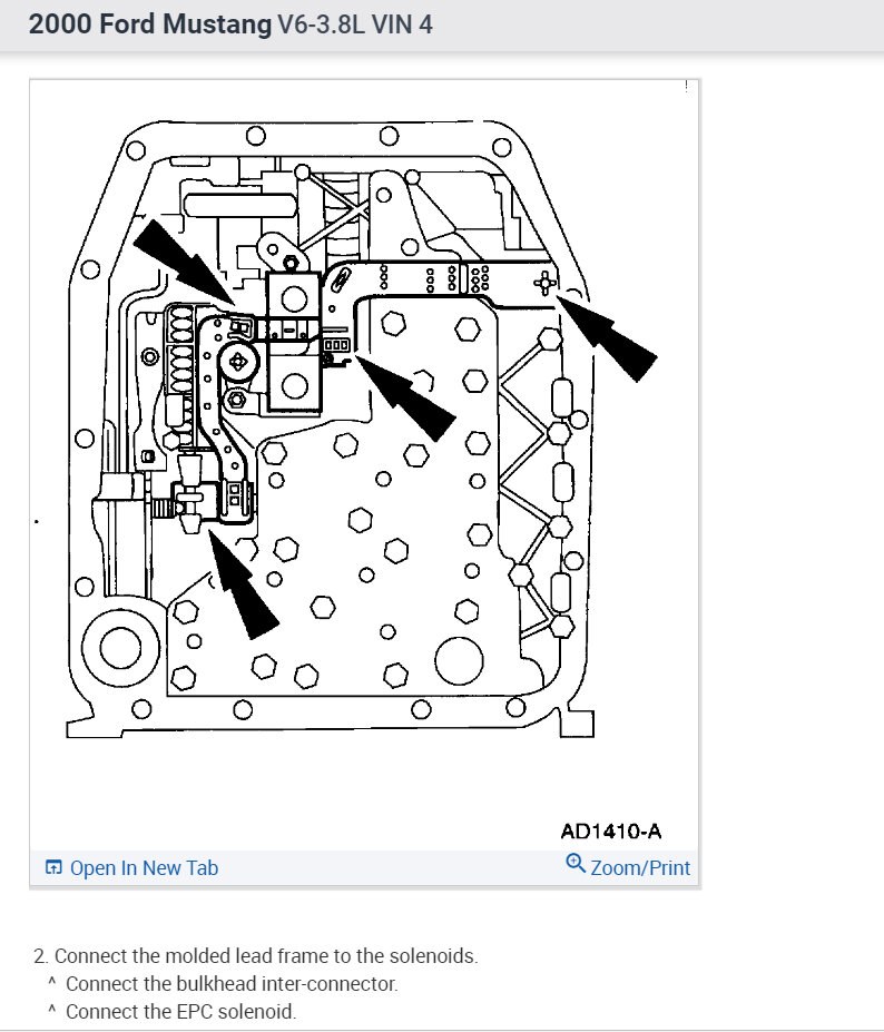

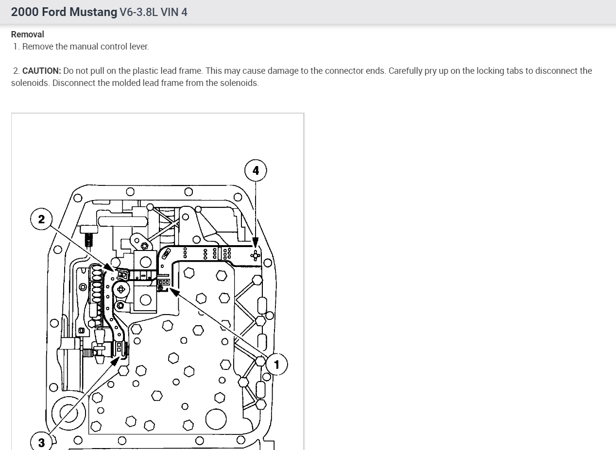

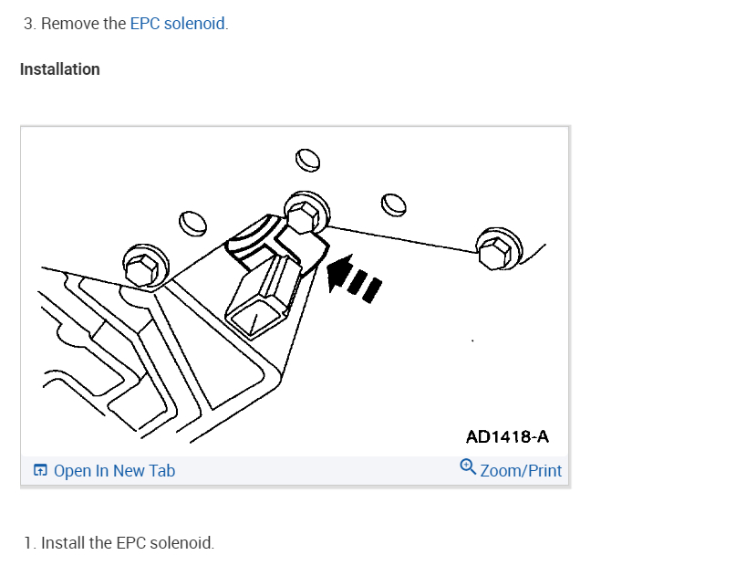

The first thing to check would be to make sure the transmission filter did not fall off and into the pan, also does it have any check engine lights on? We should run the codes anyway, here is a guide to help you. Be sure to recheck the fluid level. You could have an input shaft speed sensor that is going out.
This guide can help as well:
Here is the location of the sensor in case you need it. Check out the images (below). Please let us know what you find. We are interested to see what it is.
