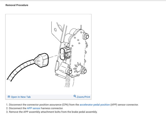

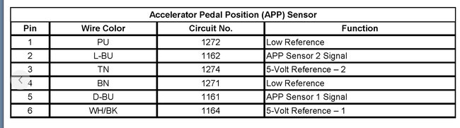

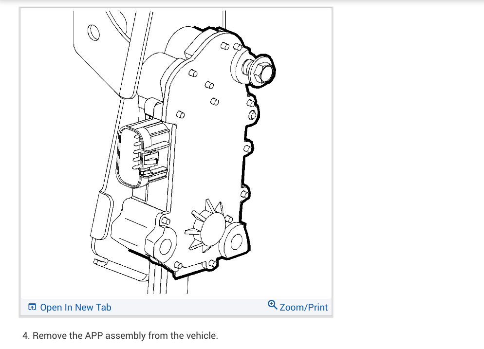

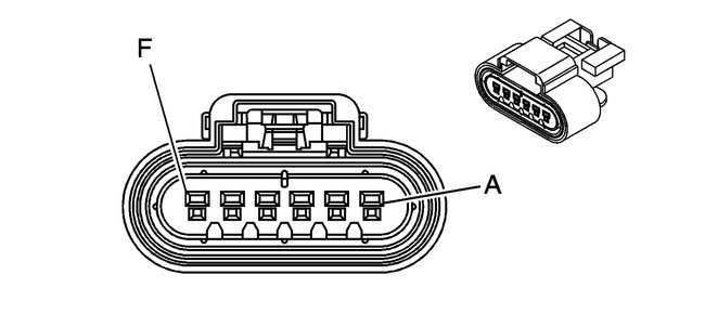

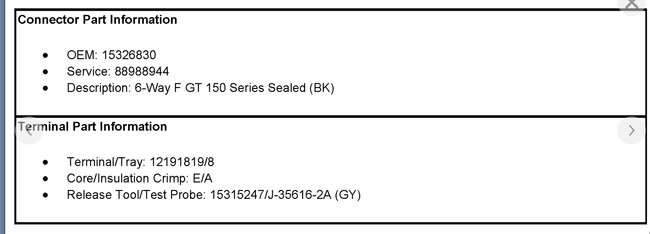

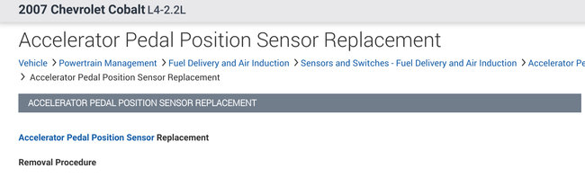

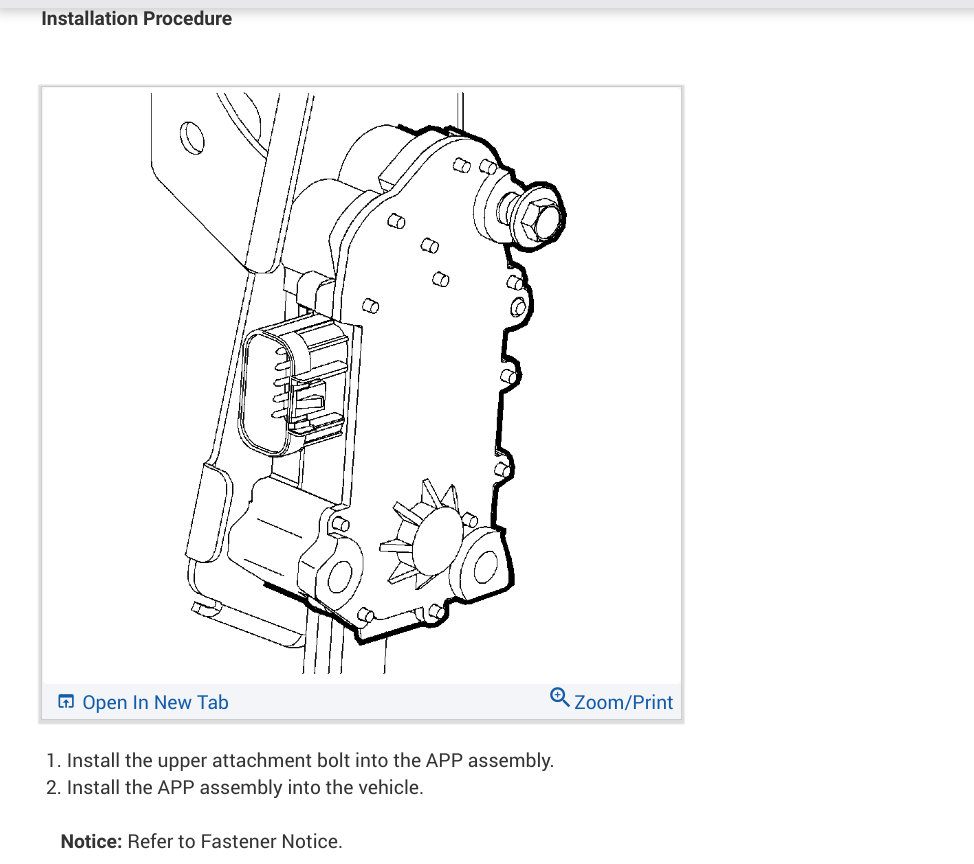

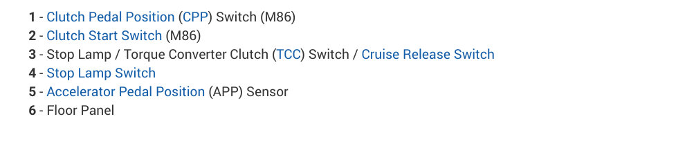

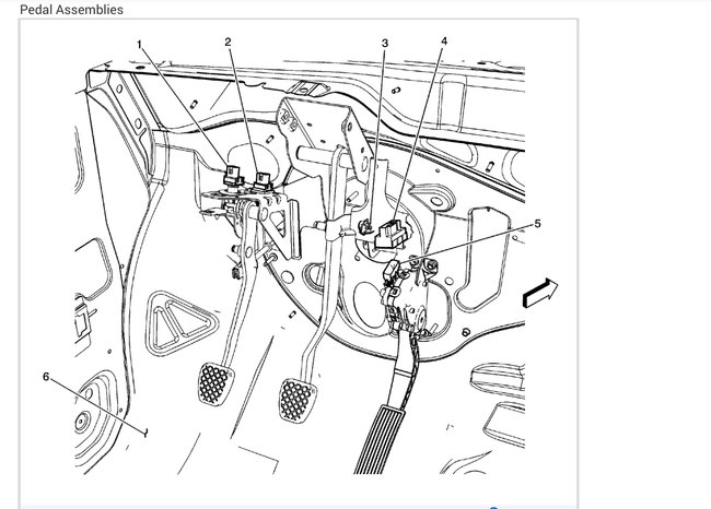

This could be a problem with your Accelerator Pedal Position sensor[APP] or its electrical connector. I would start by disconnecting the electrical connector and inspect it for corrosion or misaligned or bent/broken pins. If the electrical connector is okay, then I would recommend replacing the sensor. In the diagrams down below I have included the instructions for the removal and installation of the APP sensor, as well as it's locations, and the electrical connector pinout diagram for you. Please go through these guides and get back to us with how everything turns out.
Thanks,
Alex
