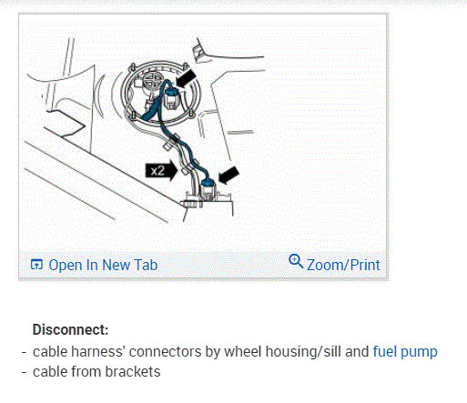

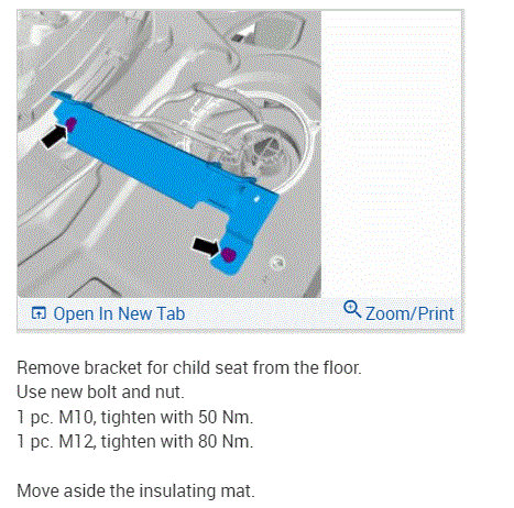

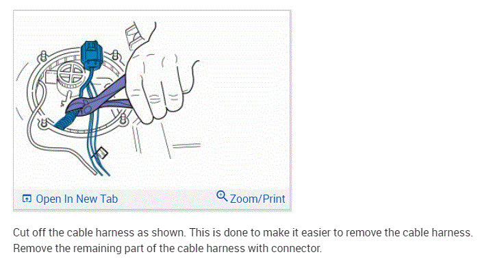

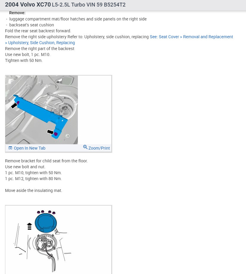

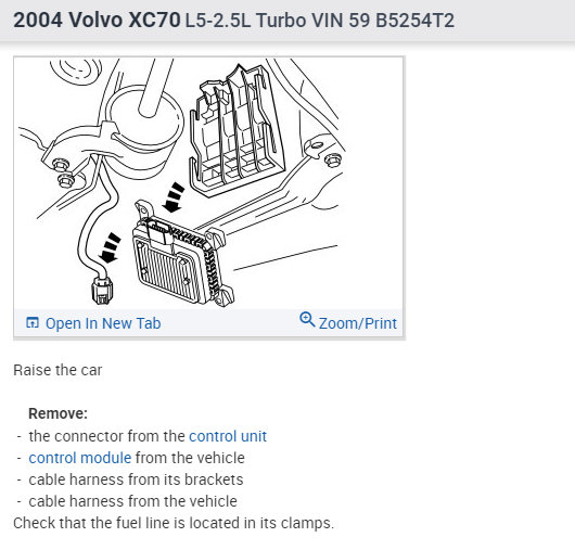

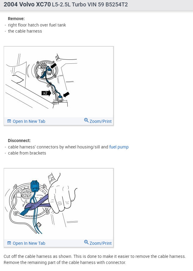

It's on the tank (top), but you don't need to remove the tank.
If you look below, I have attached the directions. Some of these were actually near the spare tire, but others were on the tank.
Let me know if this helps or if you have questions.

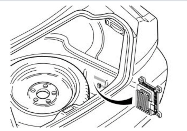

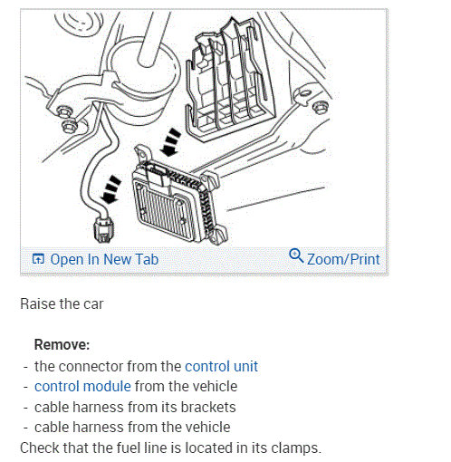

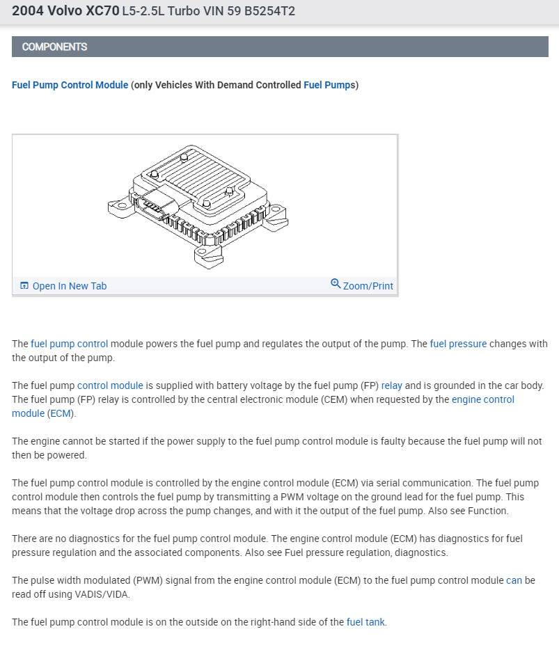

Keep in mind that the fuel pump module is only equipped with vehicles with demand control fuel pump (according to Volvo).
When the vehicle stalls, are you able to start it back up easily or does it take time before starting again?
I have attached the fuel pump module diagrams below. Take a look at that to see if you might have overlooked anything.
Let me know of any questions.

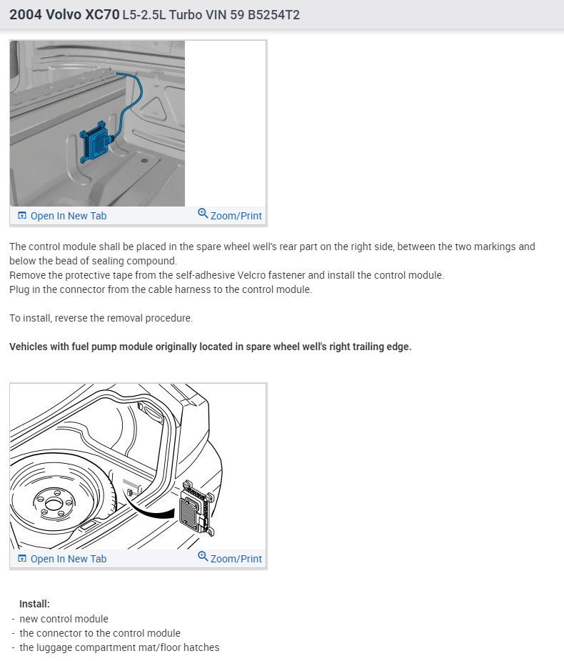

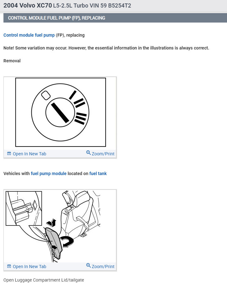

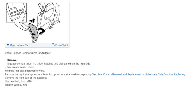

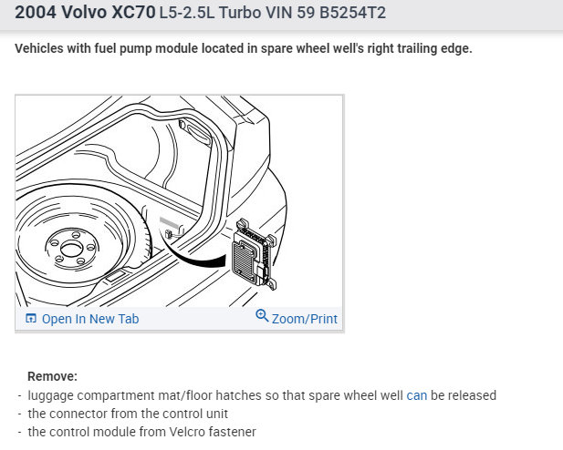

Are you sure the vehicle has a demand control fuel pump? If it doesn't, it won't have an electric controlled fuel pump module.
If you look at the pic below, that is the only other place the manual indicates as being located.
See pic below.

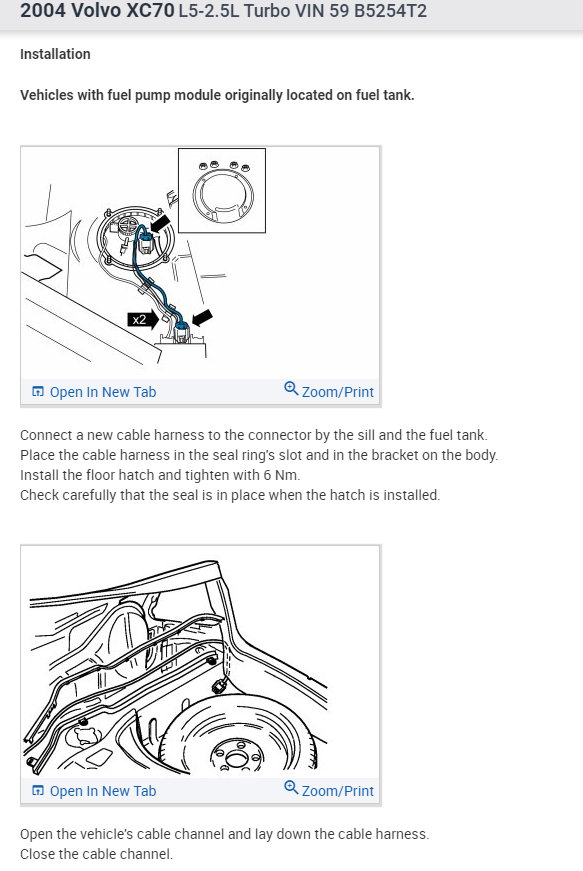

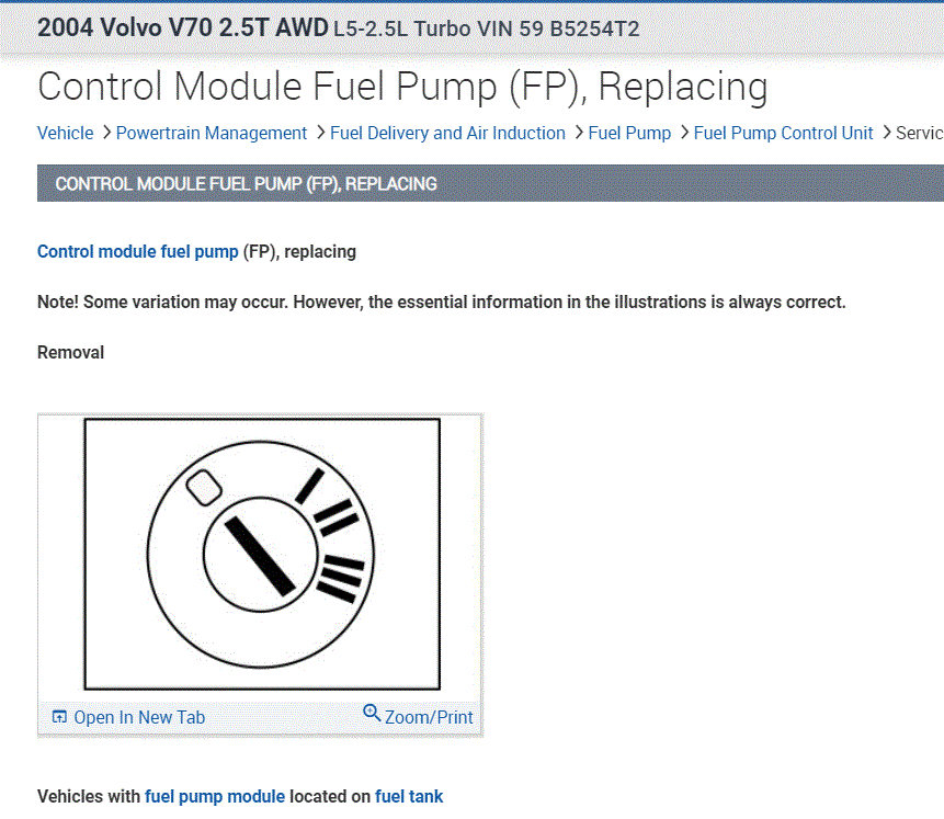

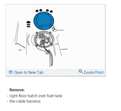

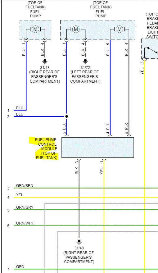

You are correct. Just to confirm, you have a 2004 Volvo XC70 L5-2.5L Turbo VIN 59 B5254T2, correct?
IF that is the case, it should be on the top of the fuel tank. I attached a portion of the wiring schematic for this vehicle below. Take a look.
