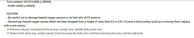

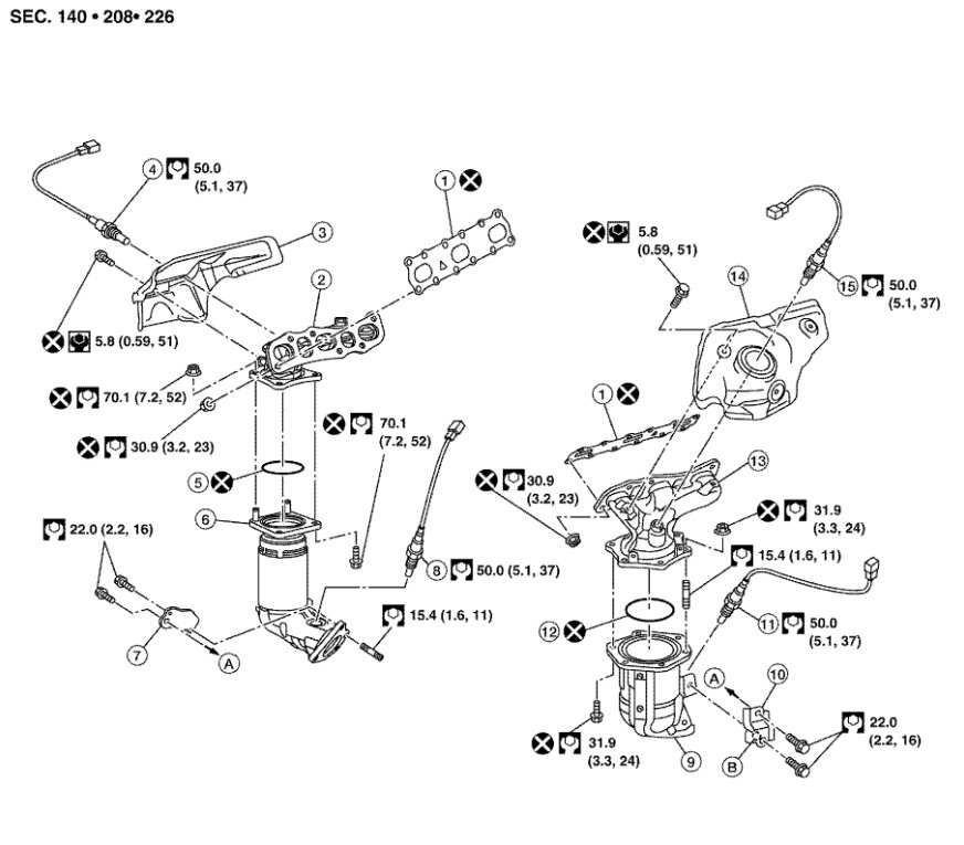

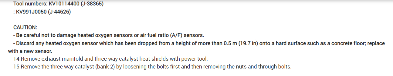

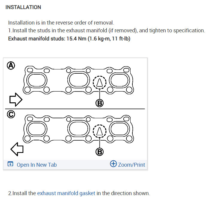

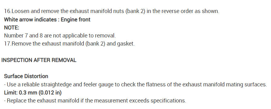

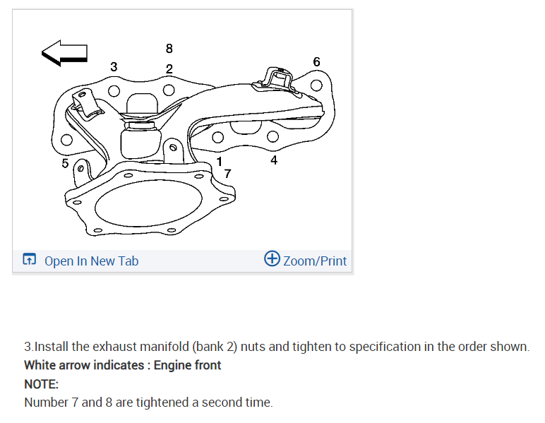

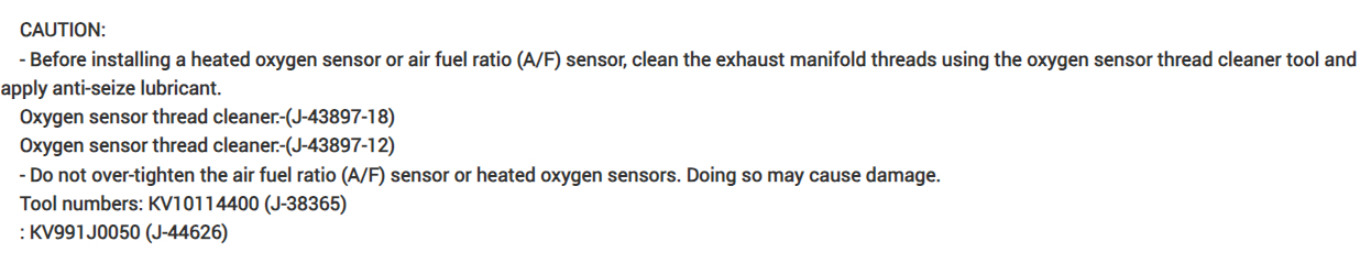

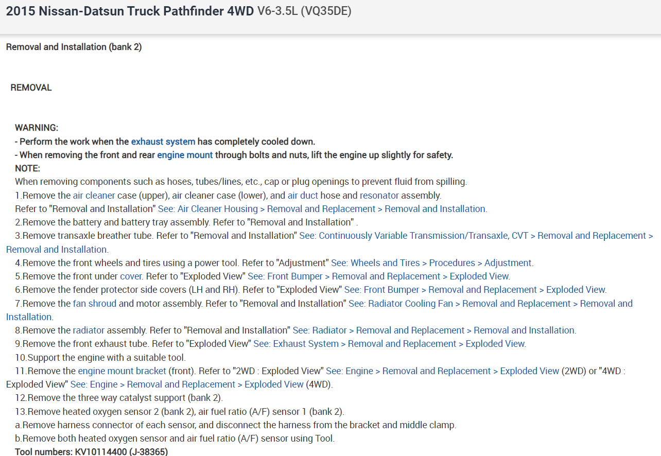

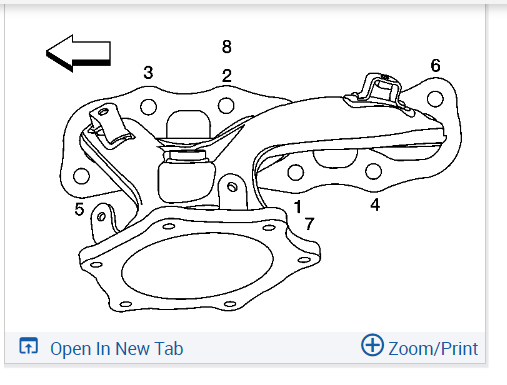

So, this code can mean the catalyst material has broken apart in the bank 2 catalytic converter and is sometimes blocking the outlet. I suggest removing the unit to look down inside with a flashlight for inspection. Bank 2 is on the driver's side of the engine. Here is how to remove and install the exhaust manifold and catalytic converter. Check out the images (below). Please upload pictures or videos in your response to the problem so we can see what's going on.
