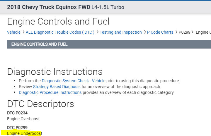

Black smoke indicates a rich fuel mixture. Also, the original code, P0299, is related to a turbo under boost. When this is set, the ECM will disable boost control and limit the system to mechanical boost only, resulting in a substantial decrease in engine power. Also, the black smoke is due to the rich fuel mixture when the boost pressure is low.
Let me know what engine you have. Also, let me know if anyone has mentioned this as the issue.

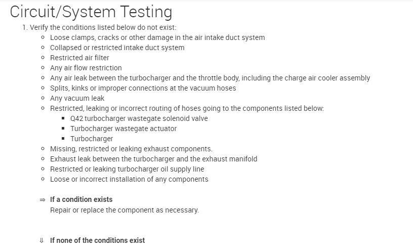

Also, make sure there are no air restrictions between the air filter and engine and if there are any exhaust leaks, engine vacuum leaks (see link below), or anything other you can think of.
Here is a link that explains how to locate an engine vacuum leak. See if you are able to find one.

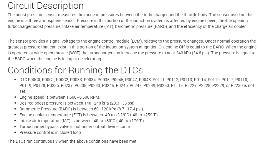

The engine is a 1.5 L 4-cylinder. The mechanic thought they figured out the problem yesterday and replaced the boost sensor but that didn't fix it.

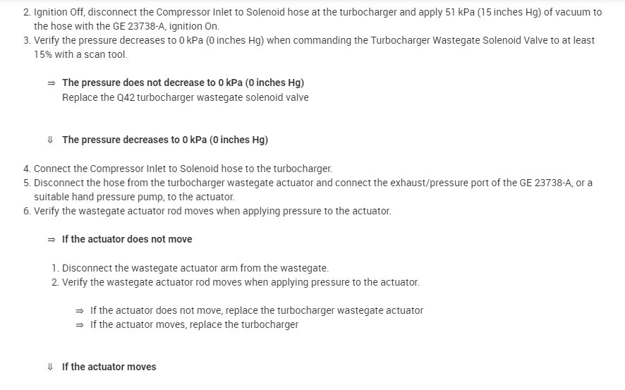

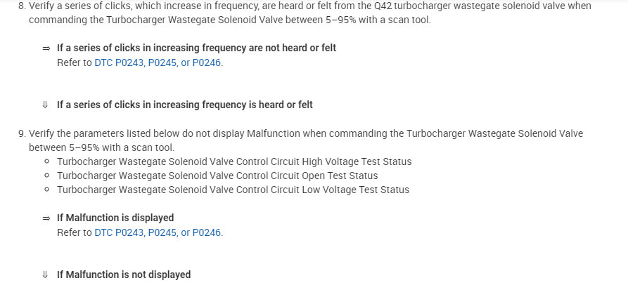

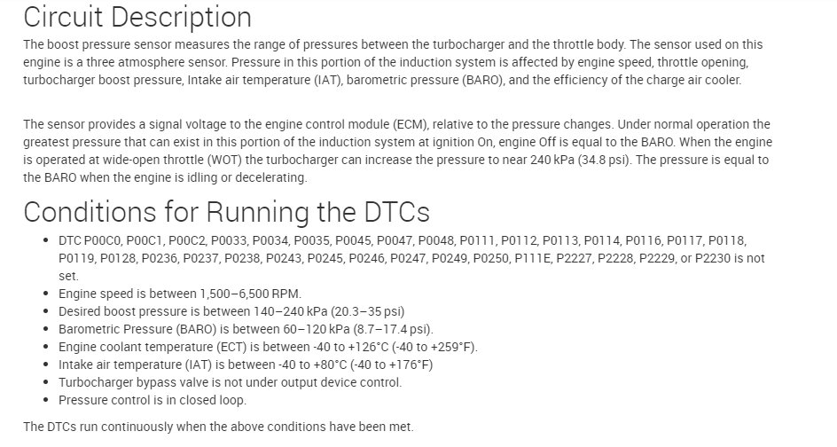

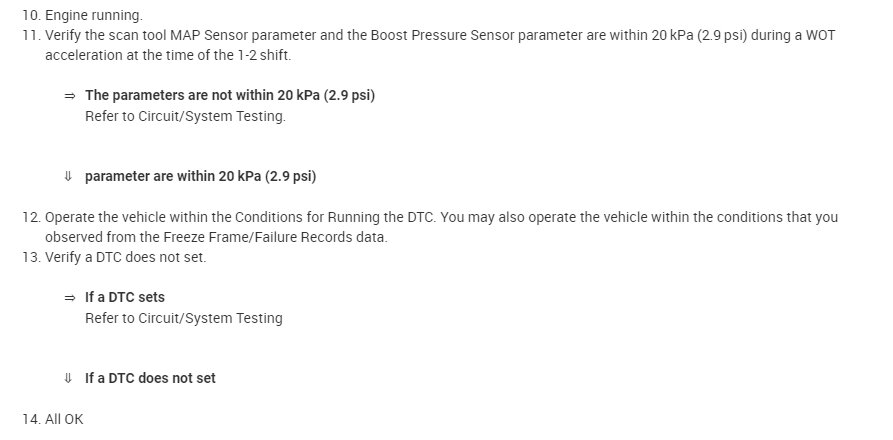

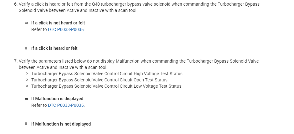

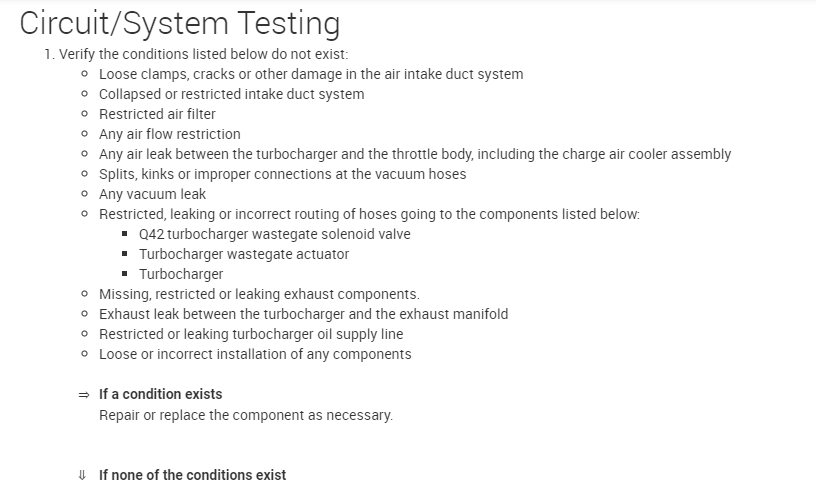

I have a feeling there is a vacuum-related issue within the turbo air induction/charge air tube. You could have a crack in the air induction, and it would cause an underboost condition. The turbo itself may be failing as well.

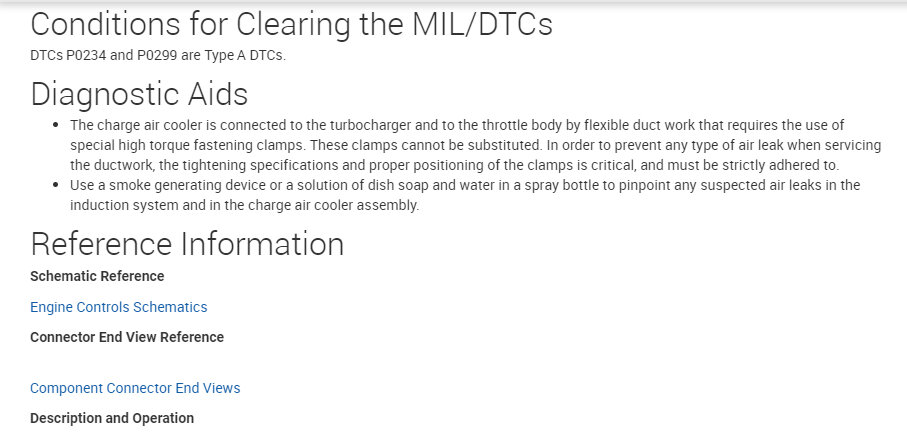

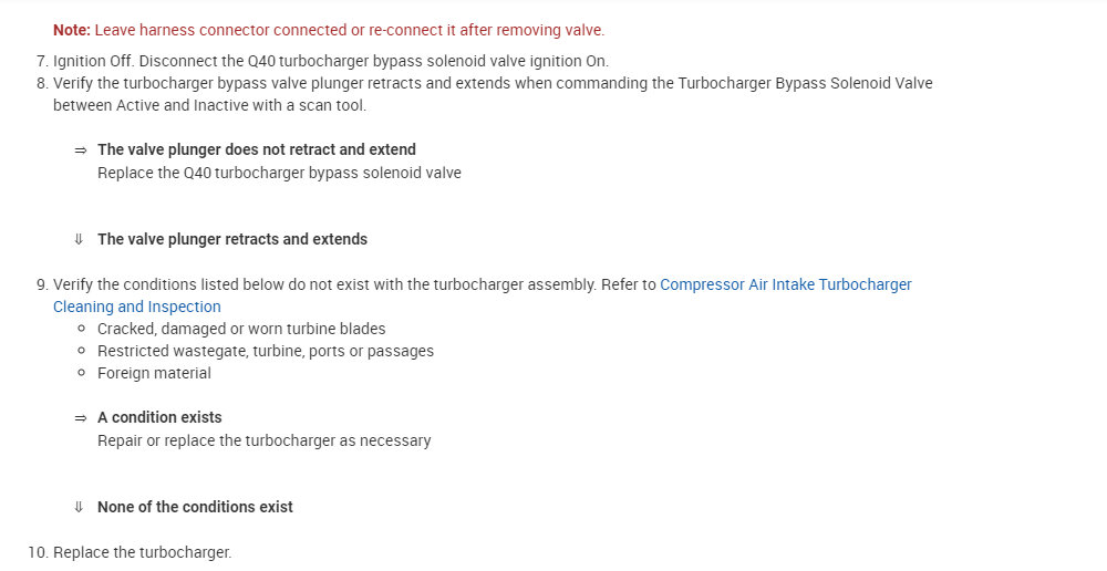

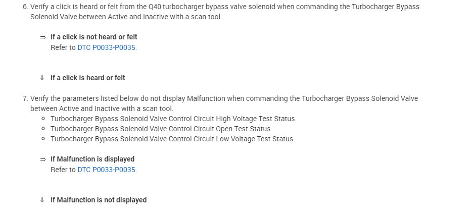

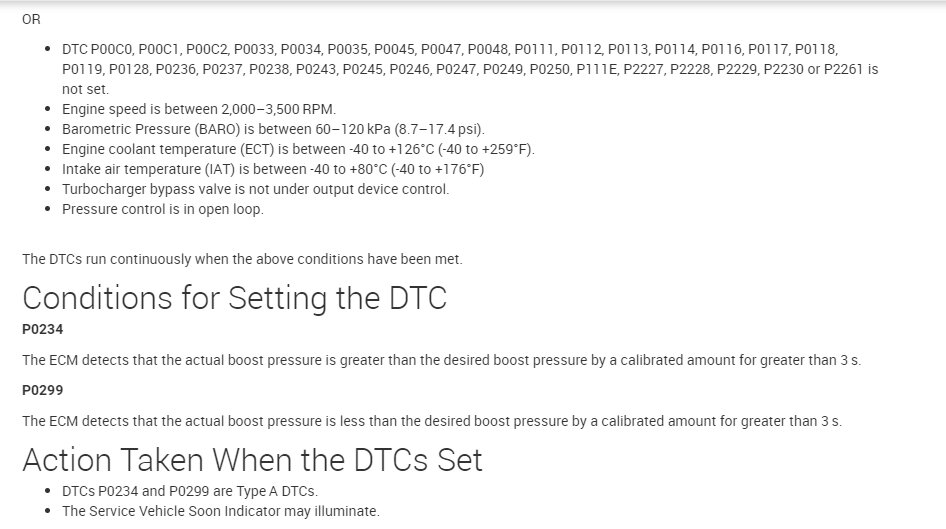

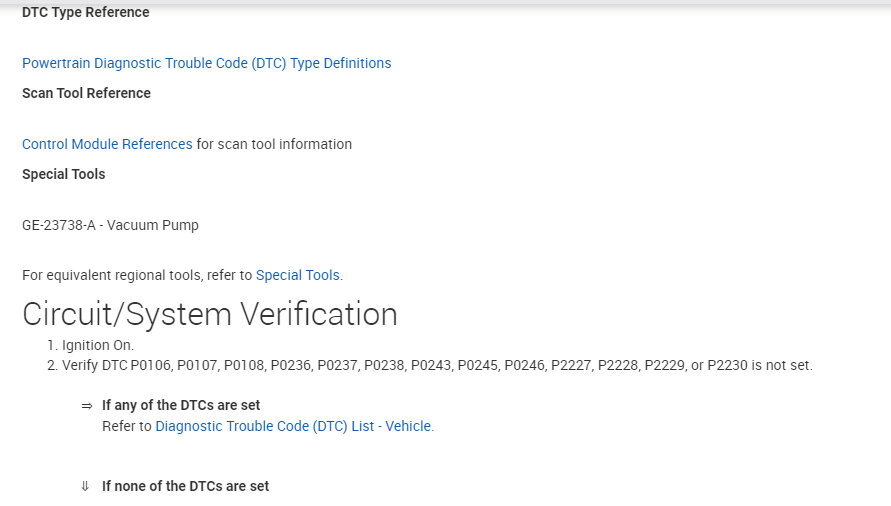

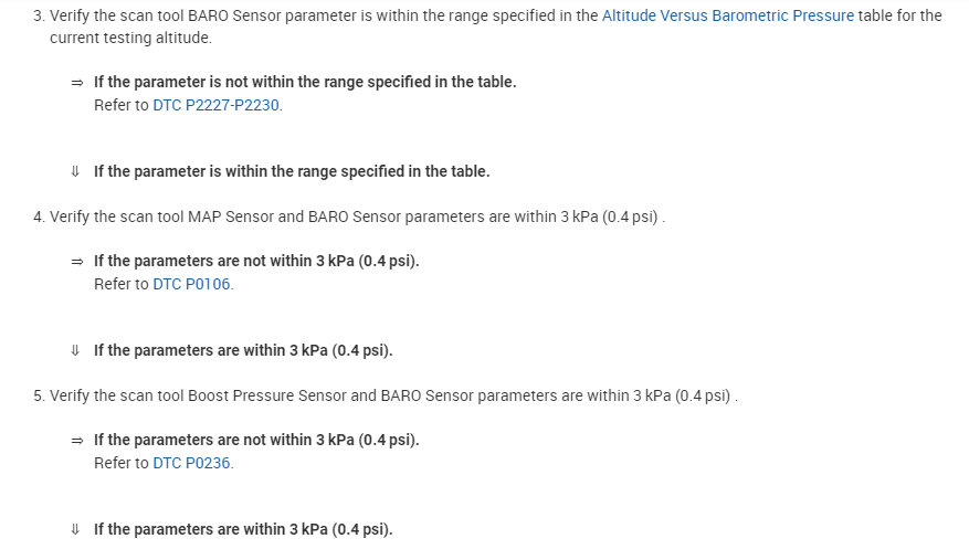

At this point, we need to complete the diagnostics related to the code. I attached that information below. It does require a scan tool that can command different components on and off. Take a look through the diagnostics and let me know if you are comfortable performing them.
