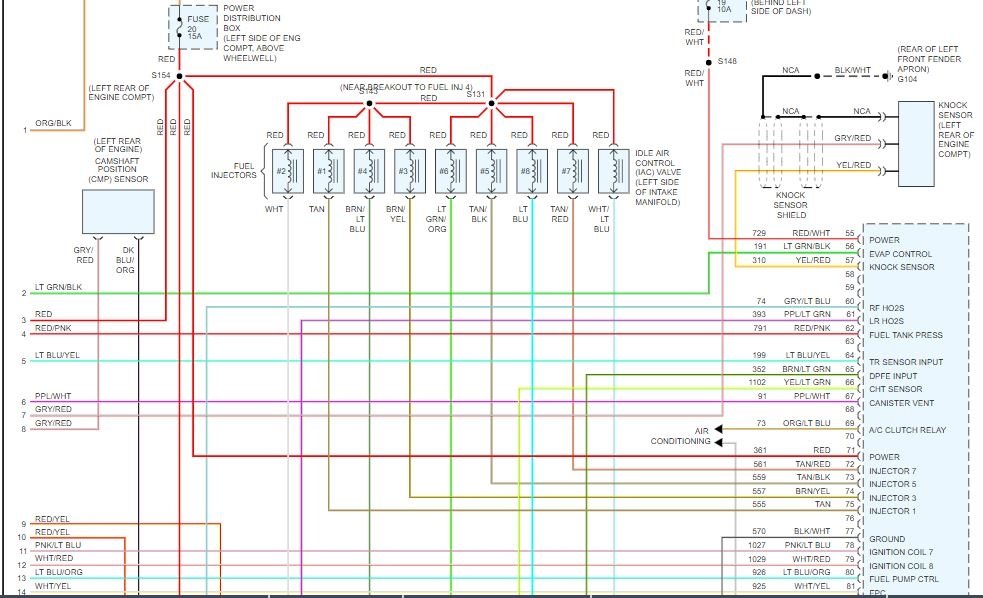

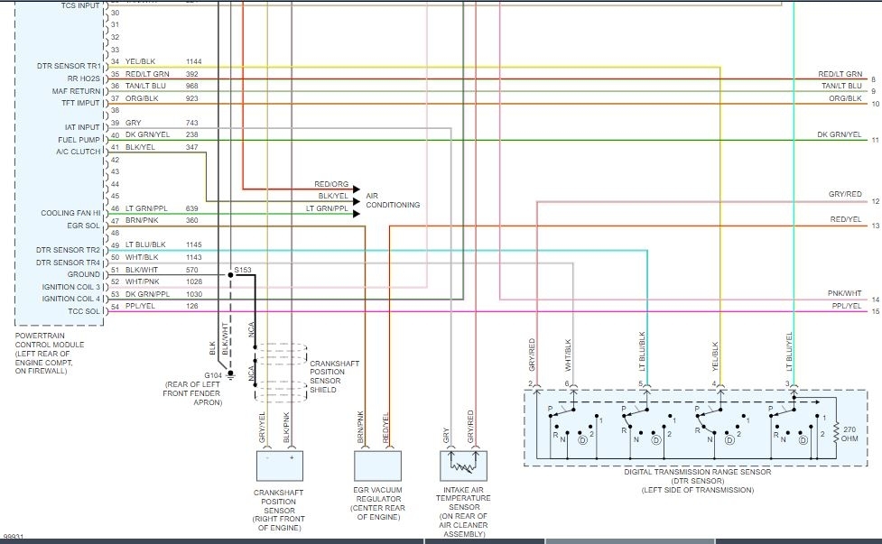

Engine wiring diagrams please?
1998 LINCOLN TOWN CAR
225,000 MILES • V8 • 2WD • AUTOMATIC
SEAN_DENNY21

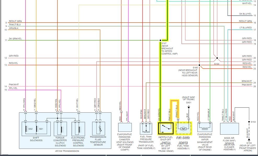

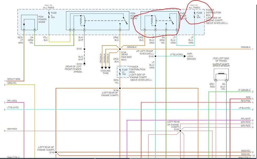

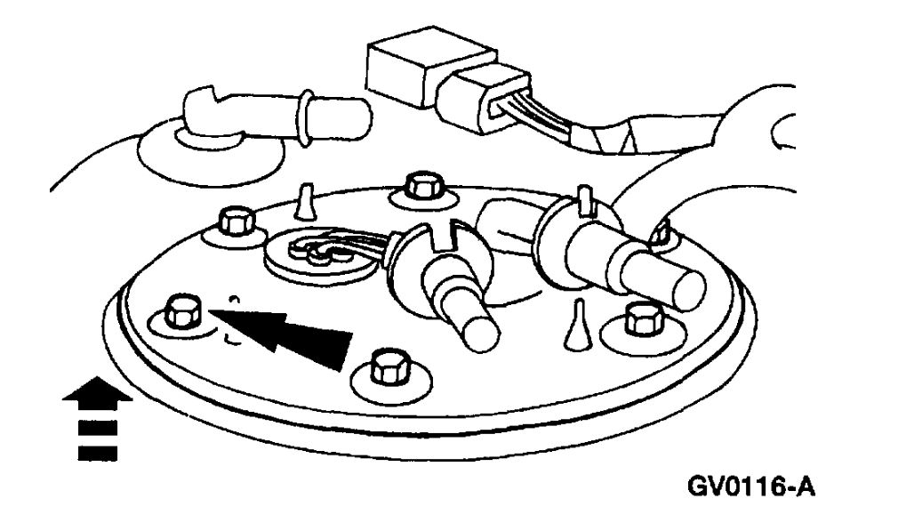

Car starts fine in the 6:00 am, morning, by 5:00 pm after work is done for the day and weather is moderately warm car will not start will turn over then immediately shuts off and will not start for the rest of the day. i let car sit over night and come back to work, i crank car and will turn on in the morning 6:0 am then have the same problem again if it gets moderately warm at the end of work day. would love to get this fixed before summer starts please.
Feb 21, 2020 at 11:11 AM
Good afternoon,
When it does not start, did you check for spark?
Can you hear the fuel pump run when you turn on the key?
Feb 21, 2020 at 12:07 PM
