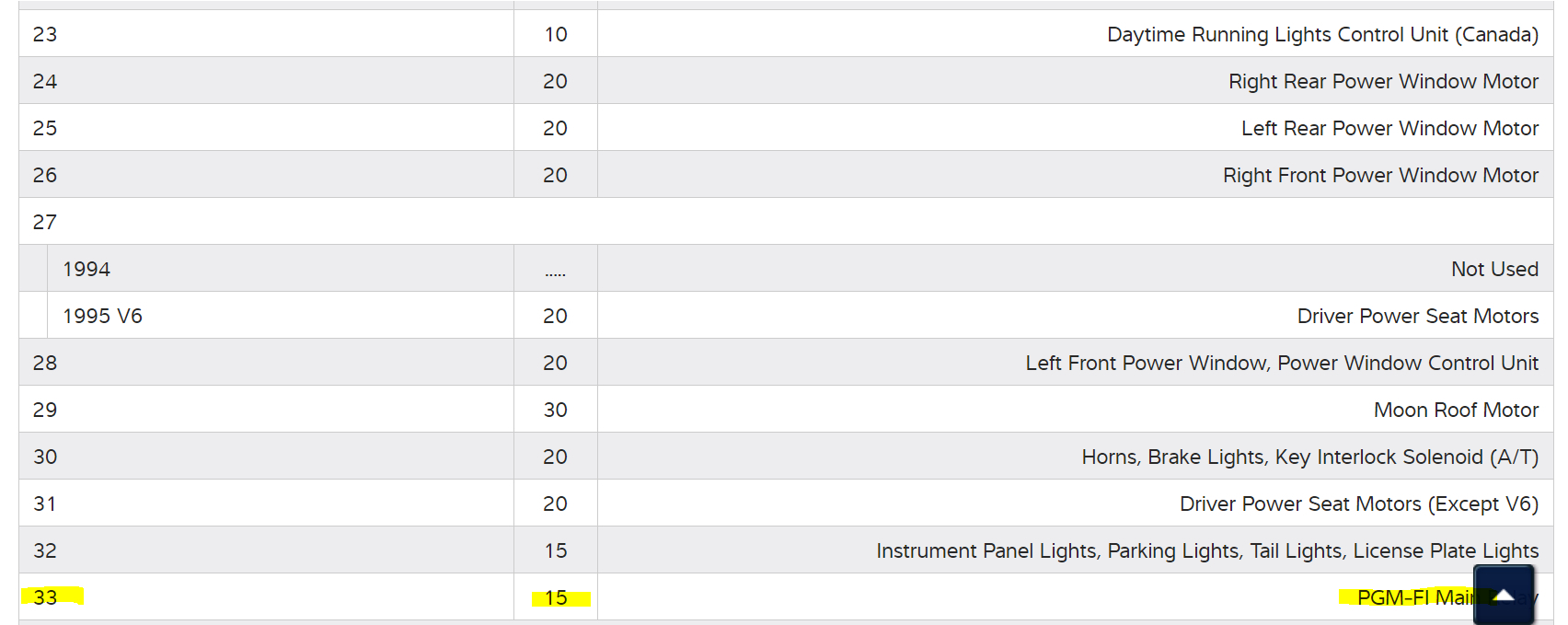

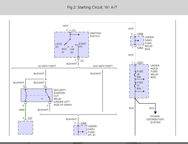

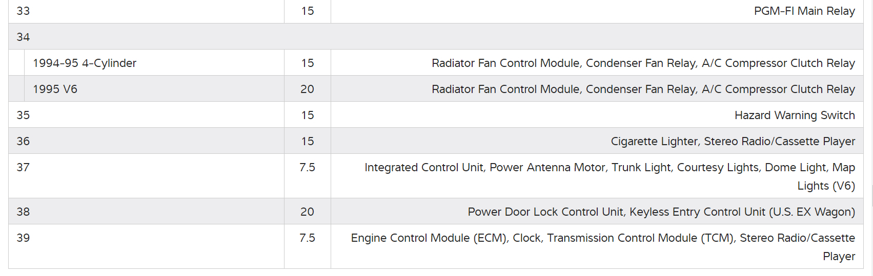

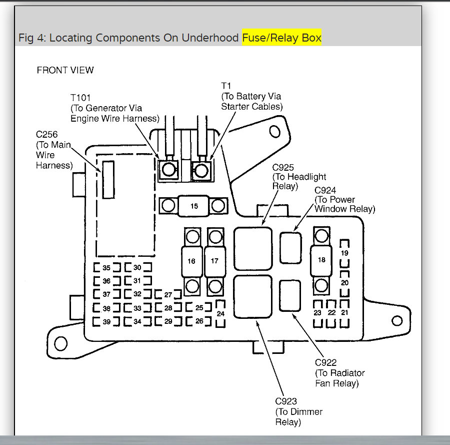

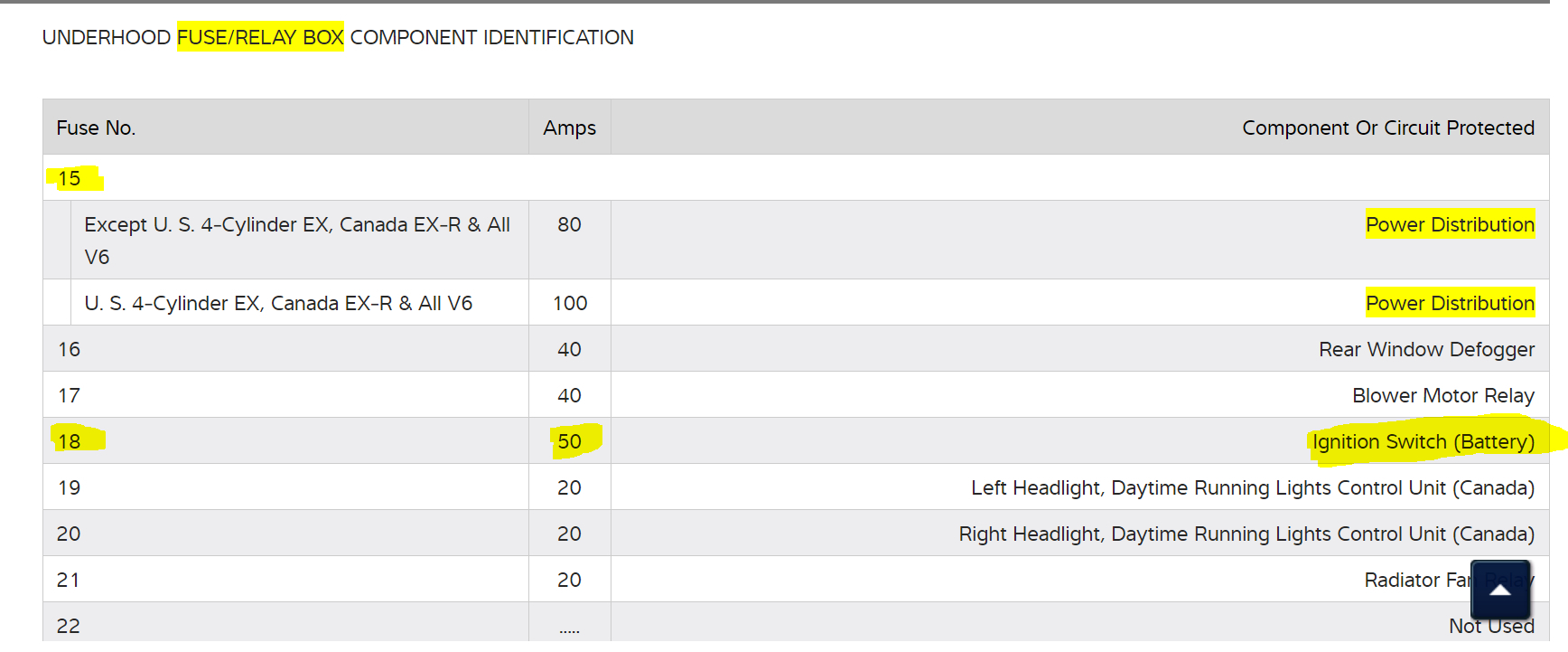

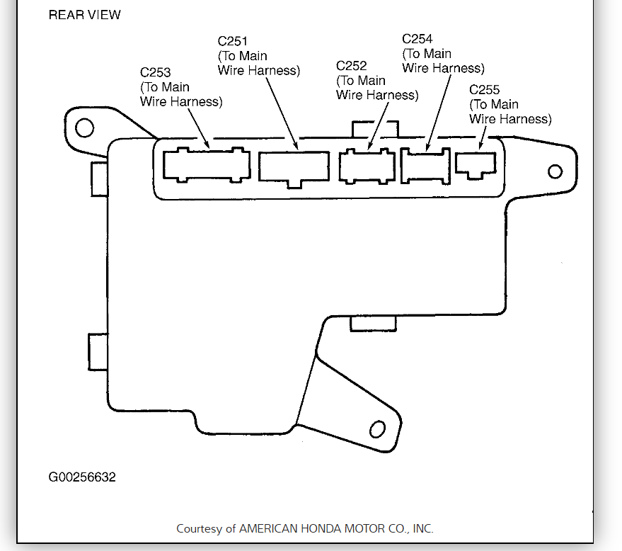

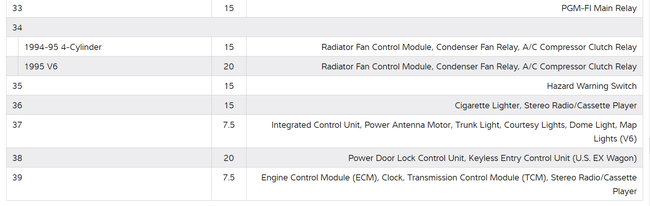

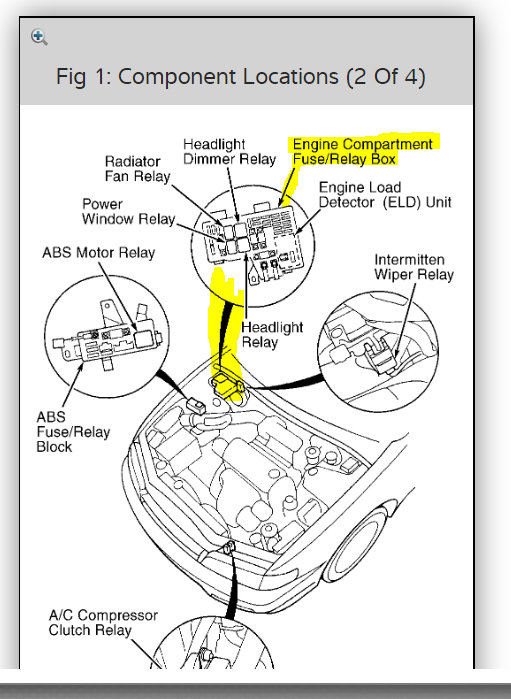

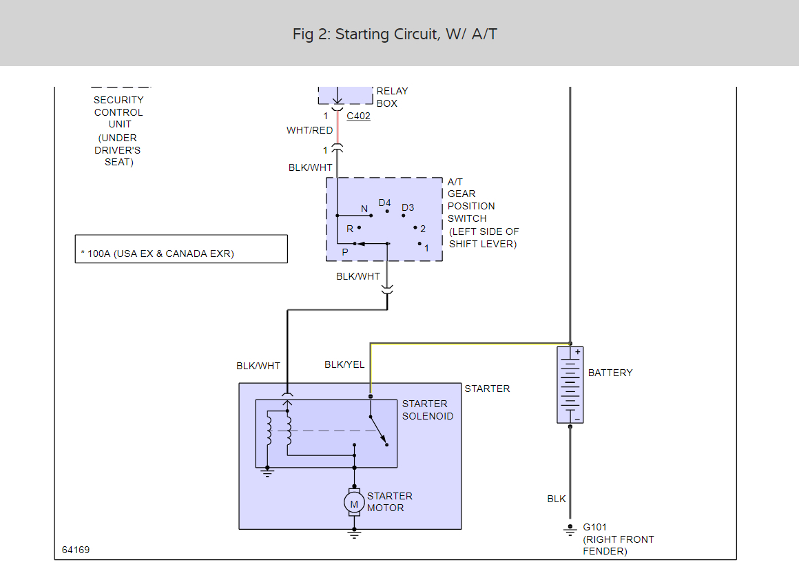

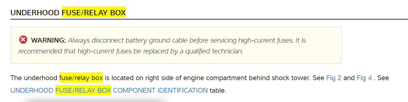

This could be a problem with a fuse(s) in the Under hood Fuse/Relay Box located on the right rear of your vehicle's engine compartment, behind the strut tower mount. I have include in the diagrams down below a wiring diagram of your vehicle's starting circuit, as well as a diagram with the location, layout, and callout of the Under hood Fuse/Relay Box. Check fuses #15, #18, and #38. Here is a link if you are unfamiliar with how to do that.
Please go through these guides and information and get back to us with what you are able to find out.

Fuses were all good, it ended up being bad wiring under the steering wheel causing the ignition issues.
