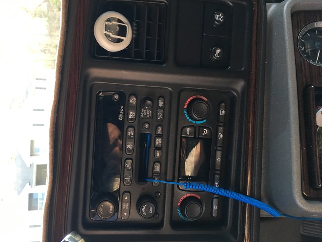

KELTICTIM
  • 7 POSTS
I’ve sent a picture multiple times. It’s a standard head unit with tape, CD, 5 disc changer down below, and RSE for the DVD player. Bose speakers, and I believe an amp.

KELTICTIM
  • 7 POSTS
Here is the picture:
Mar 20, 2019 at 8:45 AM

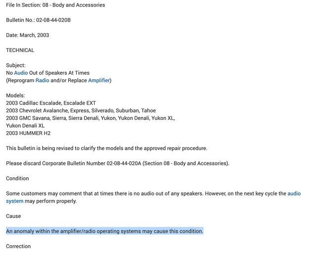

JOETECHPRO
  • 705 POSTS
Hey KELTICTIM,
It looks like it may be a radio programming or amplifier issue.
There is a TSB applicable to your vehicle.
I would Advise going to a Cadillac dealer if you can, they will be able to identify your sound system from the VIN and tell you what measure is applicable to your vehicle.
If you need to replace the amp you can do this yourself but the programming update you may need the dealer to do for you.
