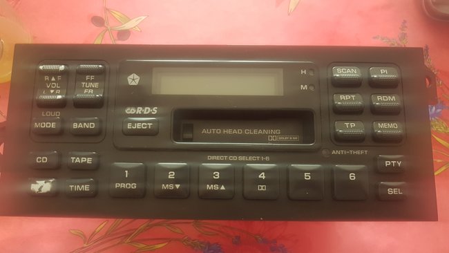

Only display is lighting but nothing else.
Impossible to put on, no sound, no nothing.
Here nobody know what is the problem.
The photo of the radio is in the attachment.

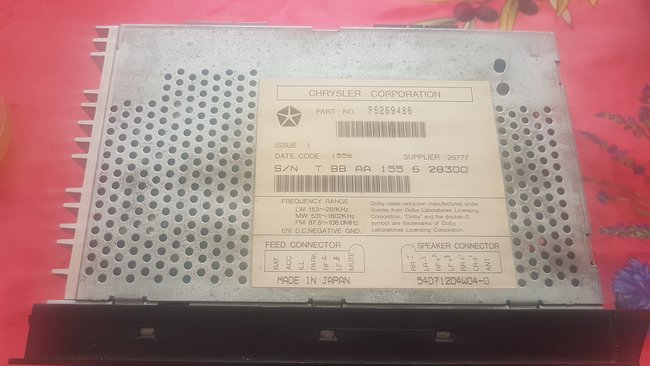

Car radio, part number P5269486

No photo showed up, and I don't have a listing for that model number. Can you describe it, and list the supplier number from the sticker?

If that "Supplier number" is 26777, that radio is built by Alpine. That would explain why I don't have a service manual for it. Alpine will not allow the authorized service centers to sell us parts or service manuals for their oem radios built for Toyota and Chrysler.

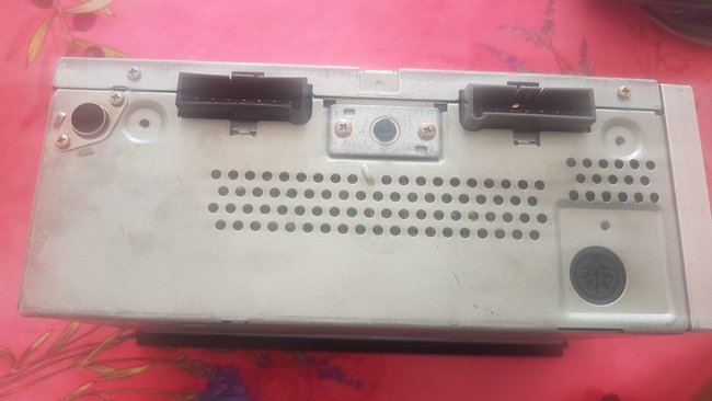

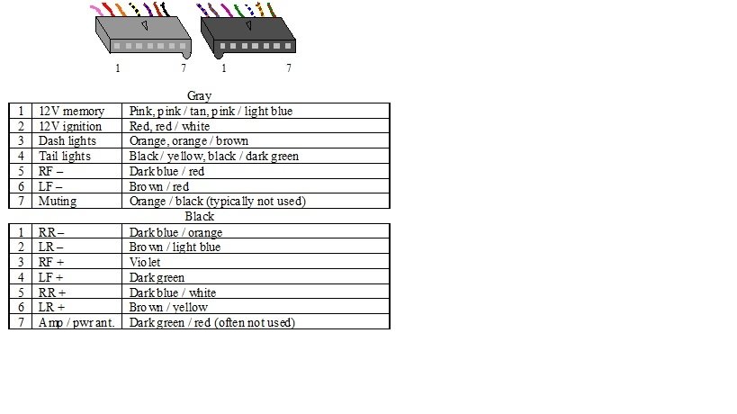

The first thing to do is check the fuse for the memory circuit. That is always tied into some other circuit that is always live. On most Chrysler models that is the "Interior lights" fuse. Alternatively, you can check for 12 volts on the two power wires in the gray radio plug. A test light will be more accurate for this than a digital voltmeter. The first wire should have 12 volts all the time. If that is missing, the symptoms will vary depending on the radio model. Some will be totally dead. Some will display the time but won't turn on. Some work just fine but the clock goes back to 12:00 each time it is turned on.
If the problem appears to be inside the radio, broken solder connections on the power relay is one thing I've run into. Those usually cause intermittent problems for a few weeks.
