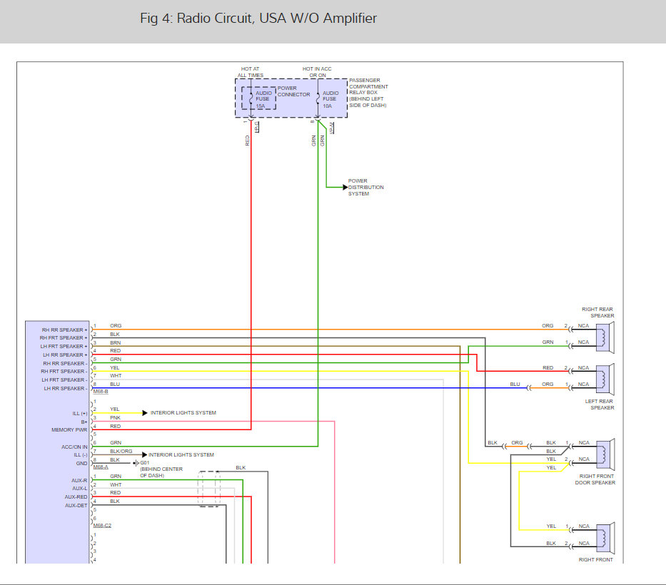

I am currently having some car radio issues. When I turn on the car (Hyundai Getz 2009) the radio lights up but nothing happens. Usually the radio will start and there will be the station text on the screen however, nothing happens just lit up.
Any hints to what the problem maybe?
Thank,
Jasmine
Apr 28, 2013 at 11:49 PM
HMAC300
  • 48,601 POSTS

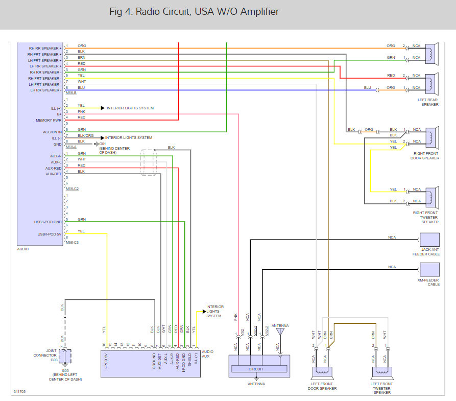

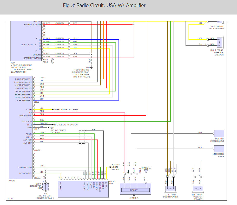

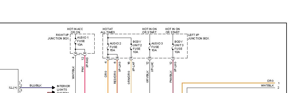

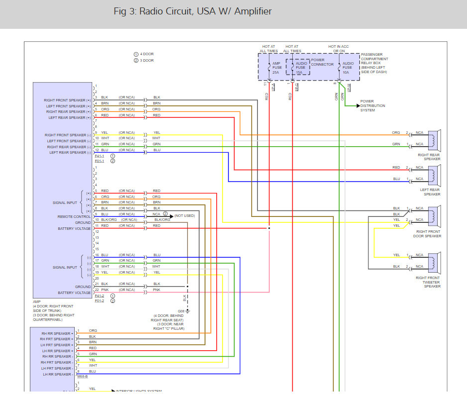

There are three fuses that run the system if you have an amp if not only two fuses here is the wiring diagrams so you can see how the system works and a guide to check for power at the fuses.
Check out the diagrams (Below). Please let us know what you find. Cheers

check underhood as well
