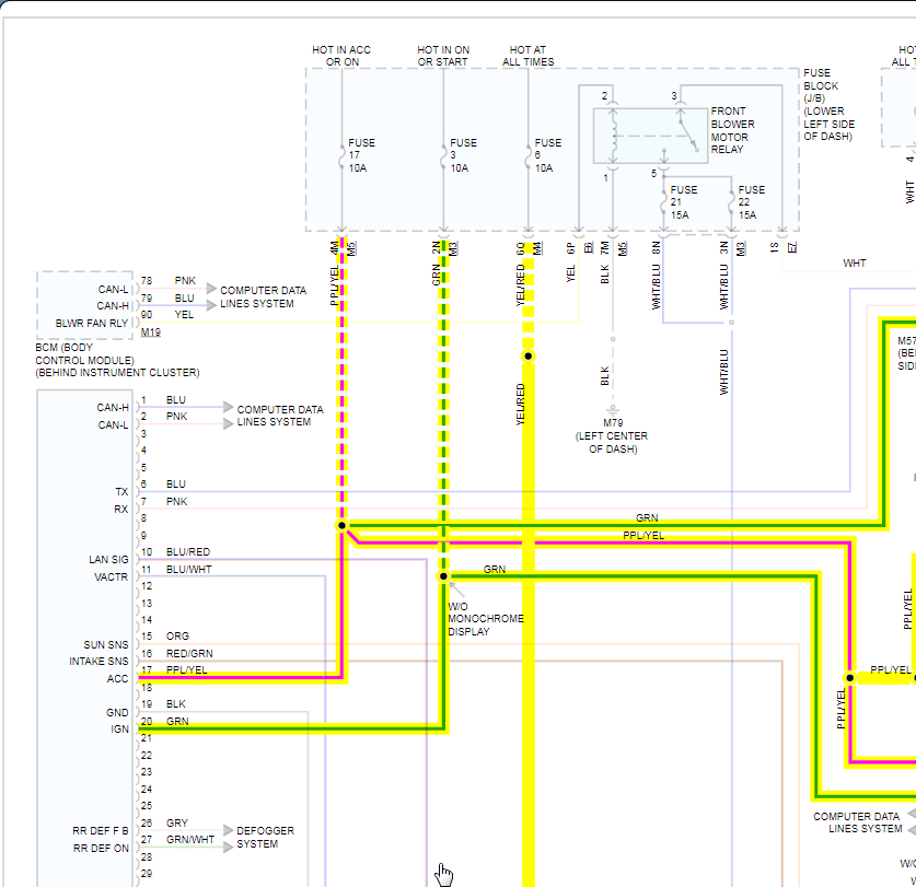

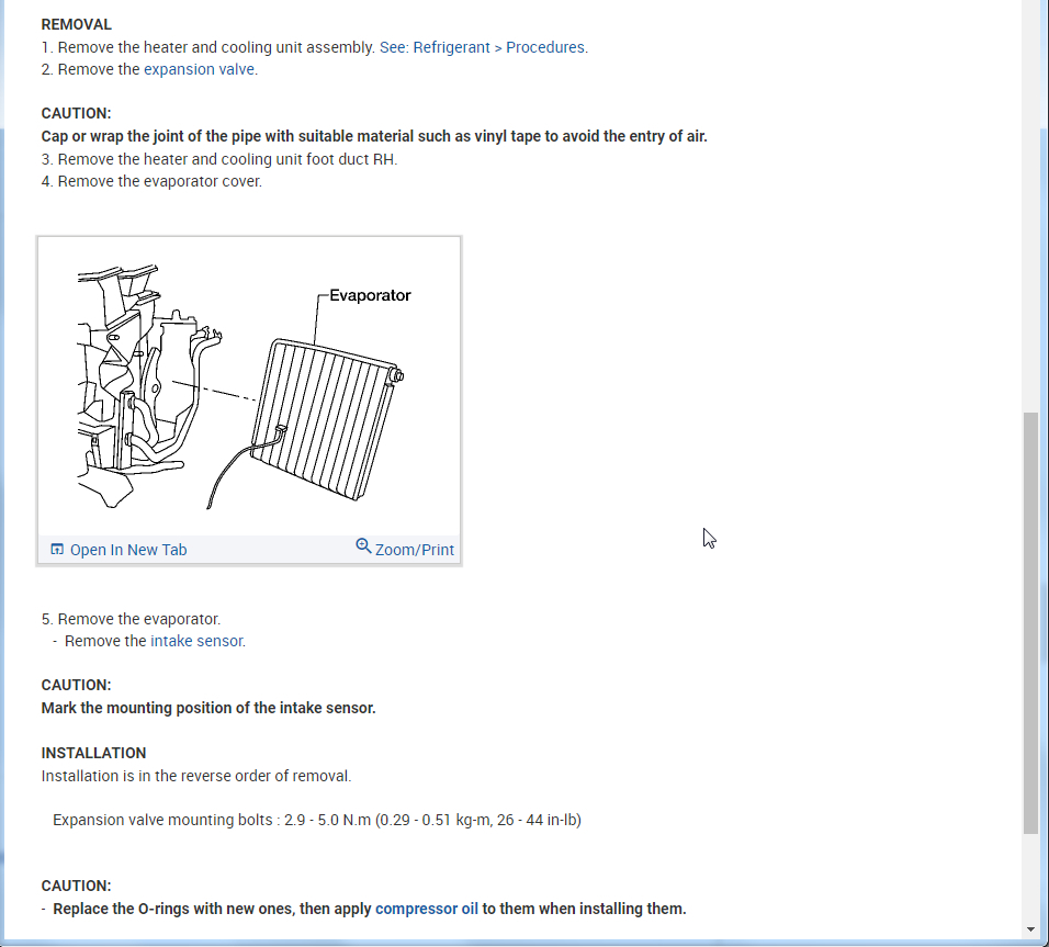

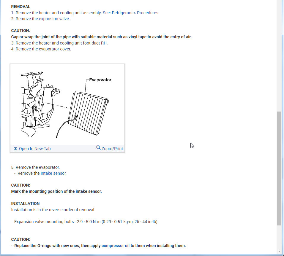

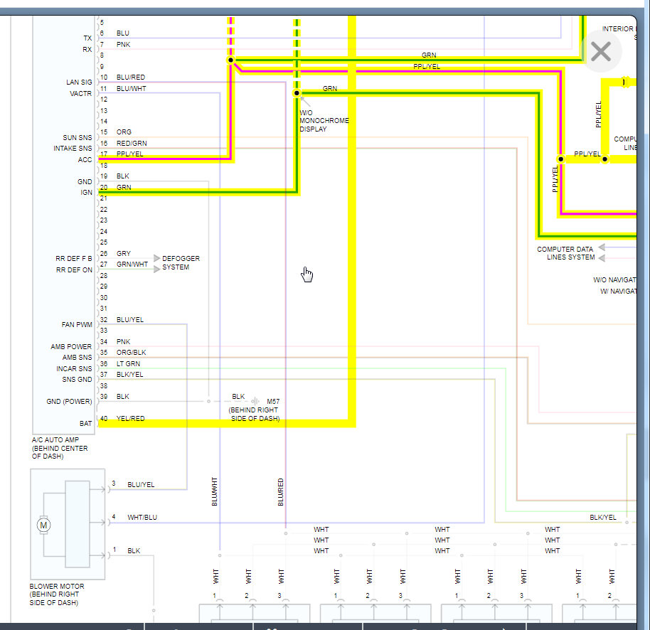

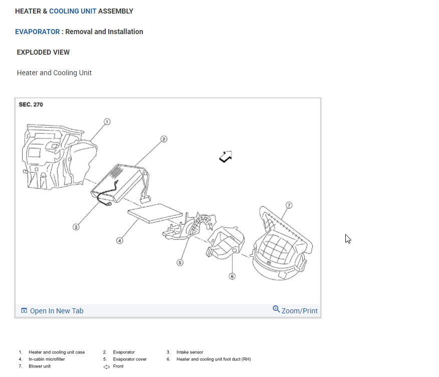

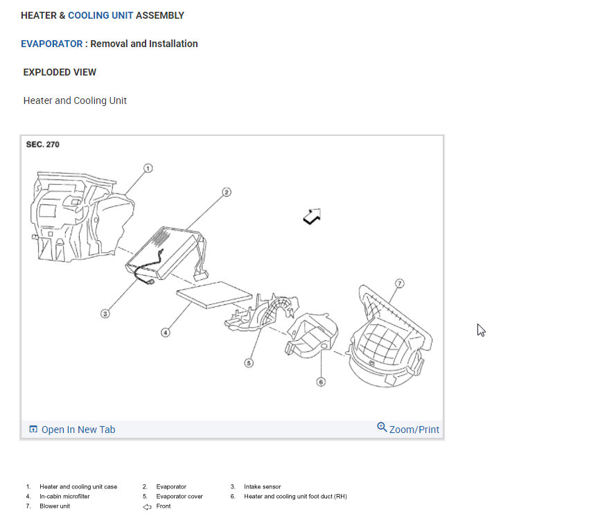

My mechanic has my car and he just changed my evaporator and now my radio screen is blink and my A/C comes on and work, but we can’t turn it off or turn it down change anything. help please.
Mar 30, 2021 at 12:56 AM
In order to replace the evaporator, the HVAC unit behind the dash needs to come out so I suspect he missed a connector or it is not fully connected.
The only way to find this out is to check voltage coming into the module behind the dash. There are a number of power wires and if the connector is loose or off then the unit will not come on.
Please let us know if you have questions with this.
