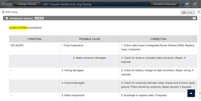

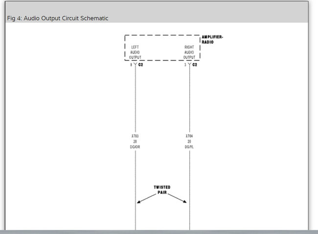

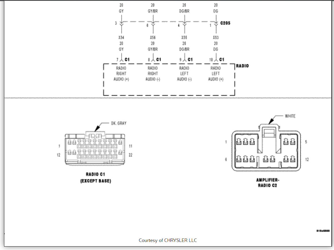

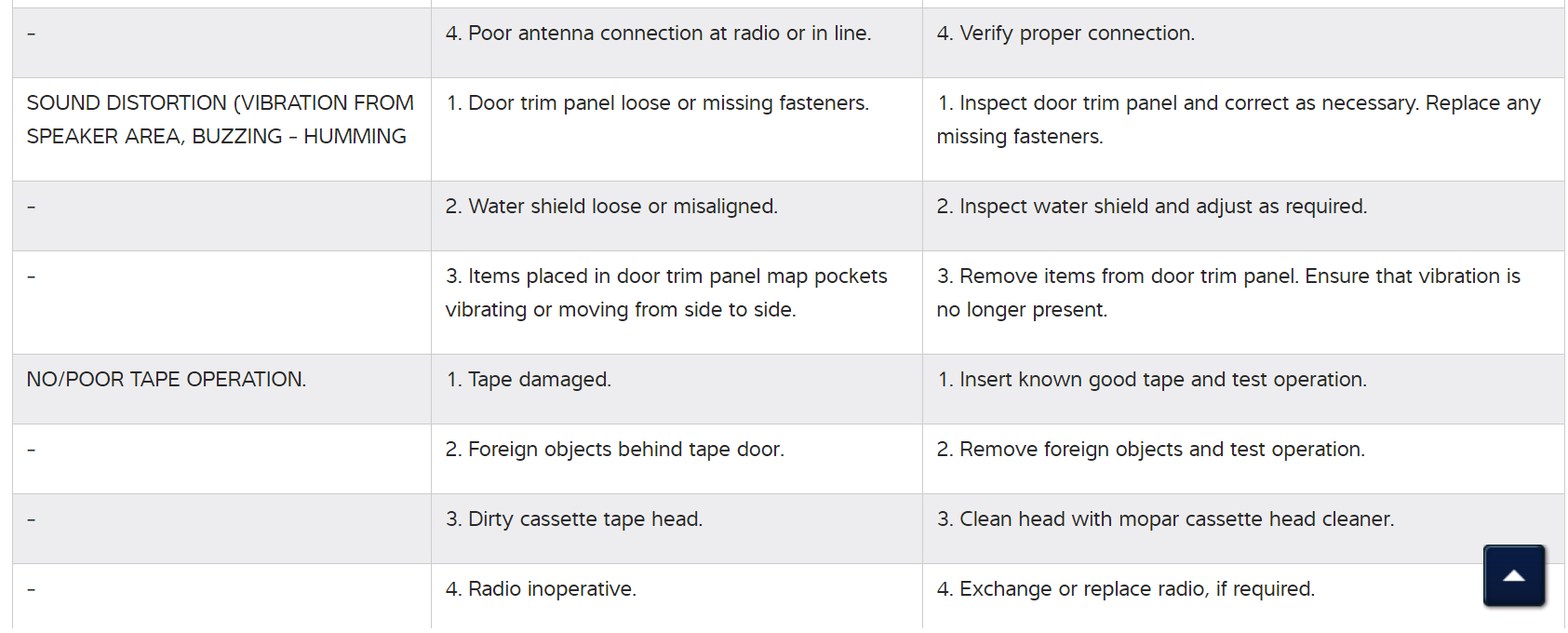

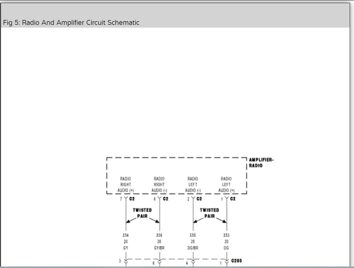

My factory radio stopped working, but it will show the time and the amp has power. Also my miles until empty wont show the miles anymore. Already checked the fuse box and that's not the issue. Please help
Mar 16, 2019 at 3:44 PM
SCGRANTURISMO
  • 4,897 POSTS

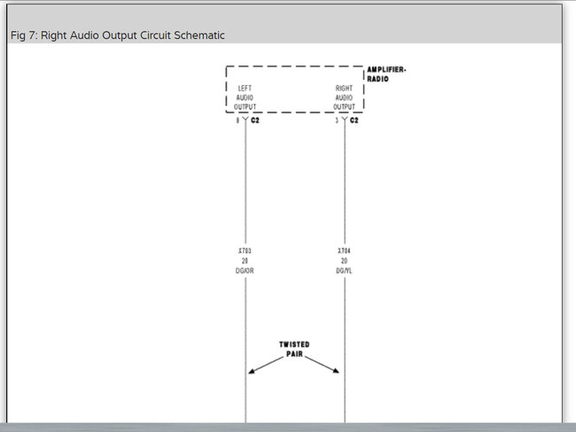

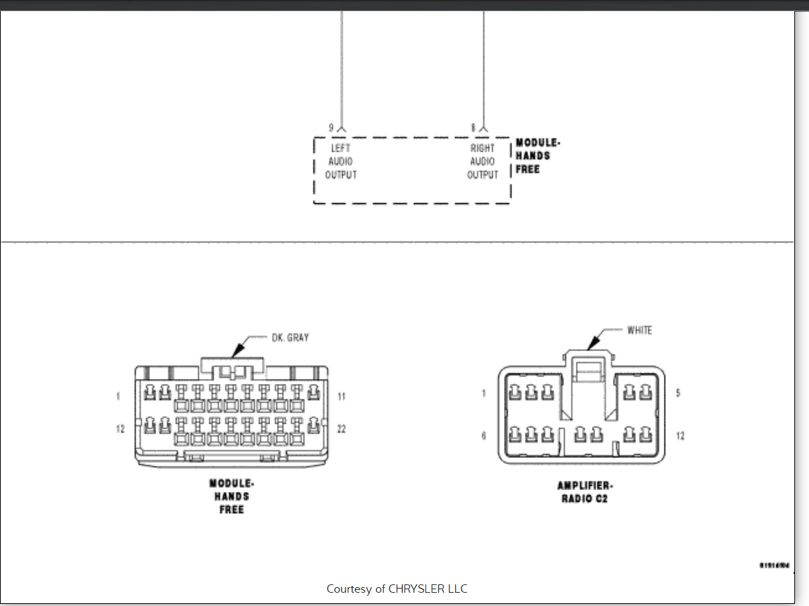

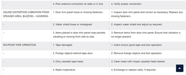

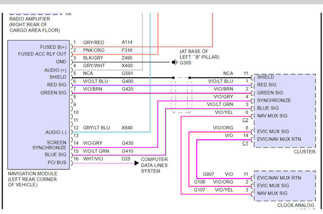

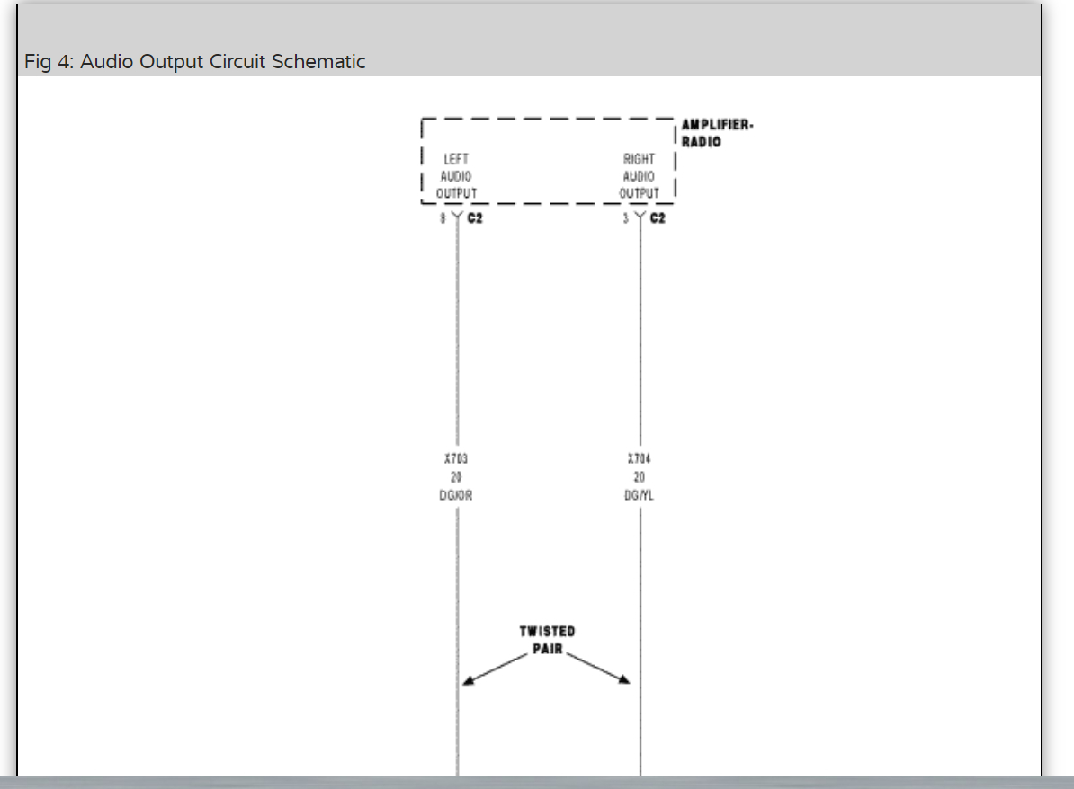

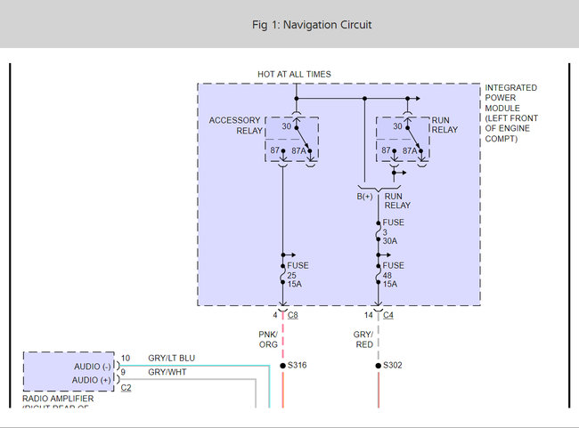

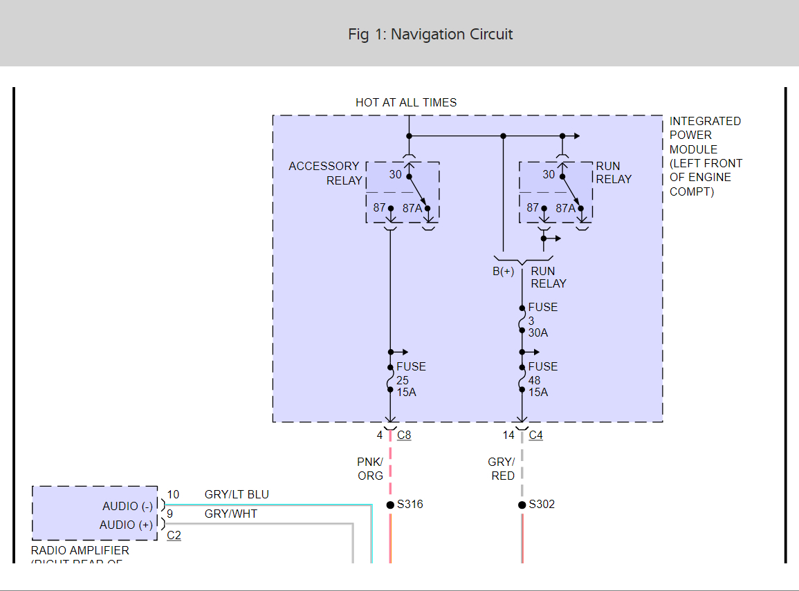

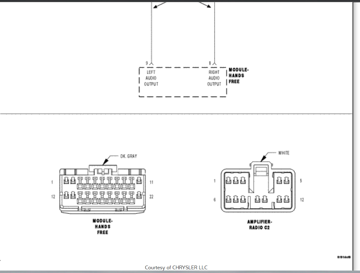

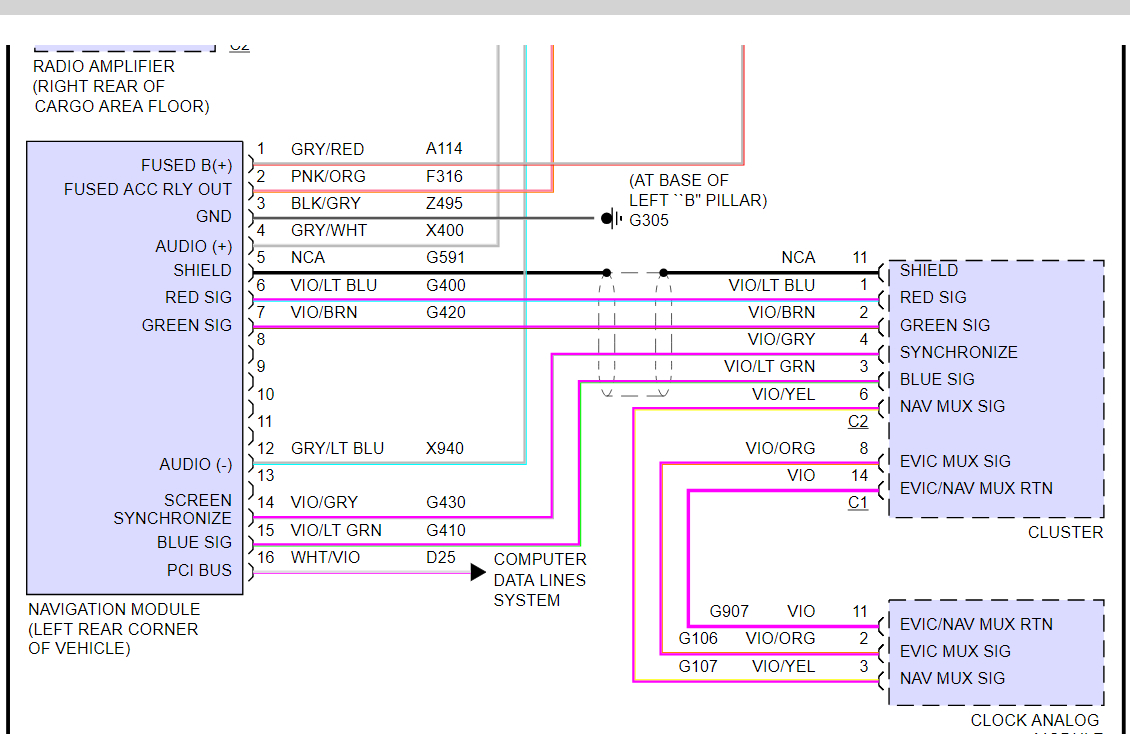

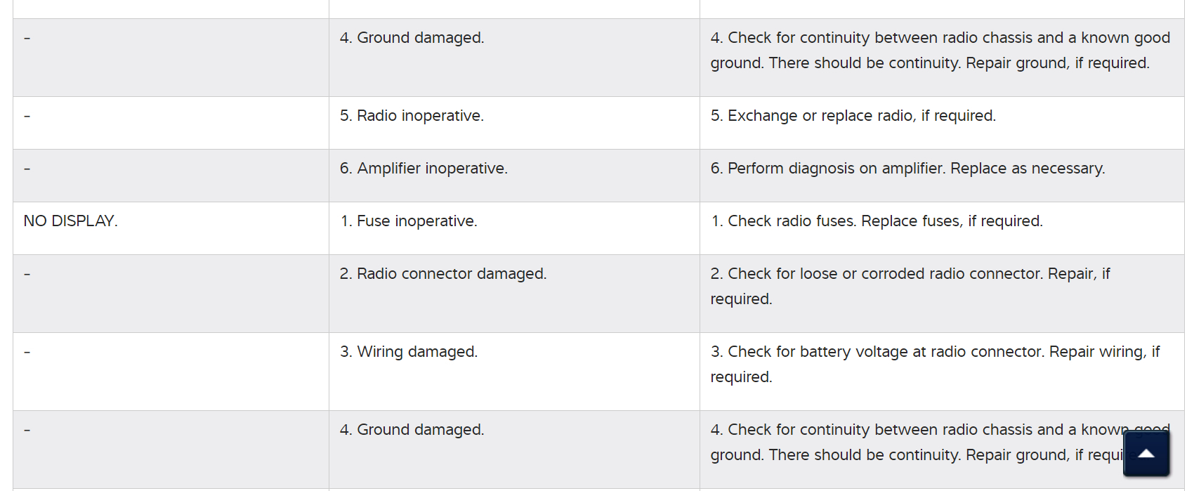

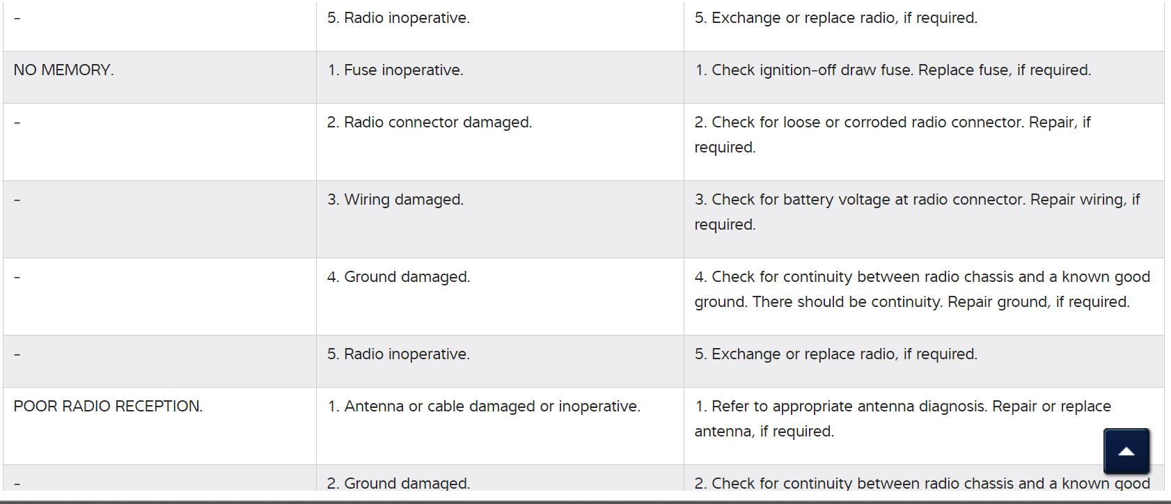

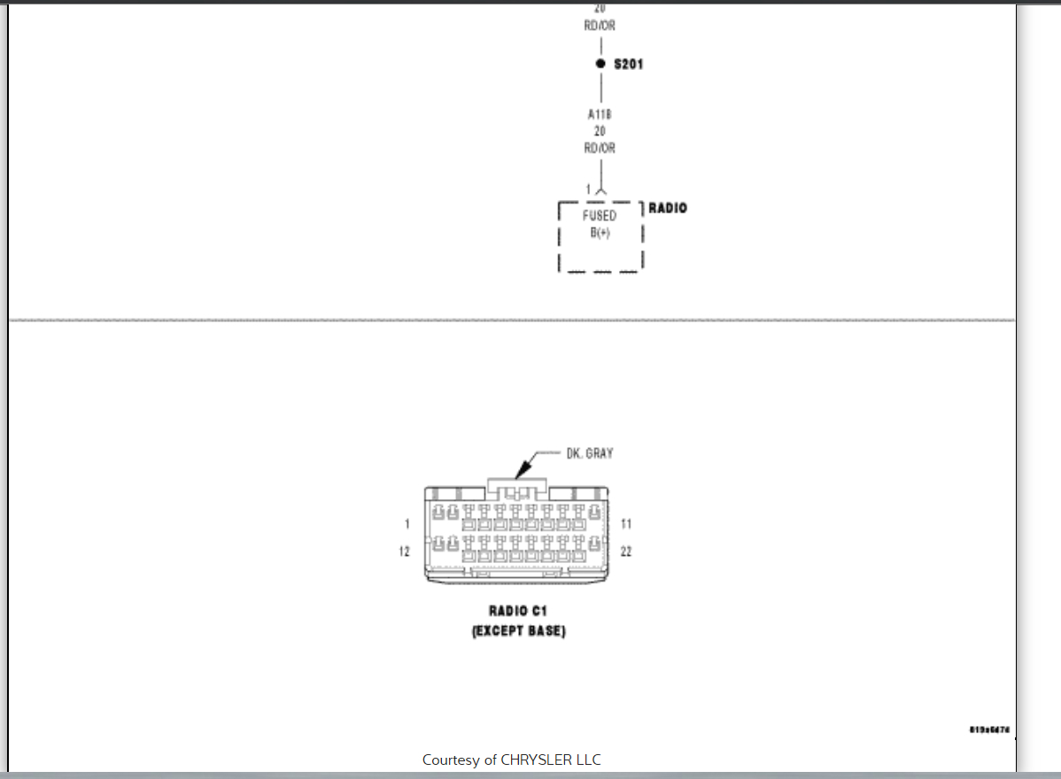

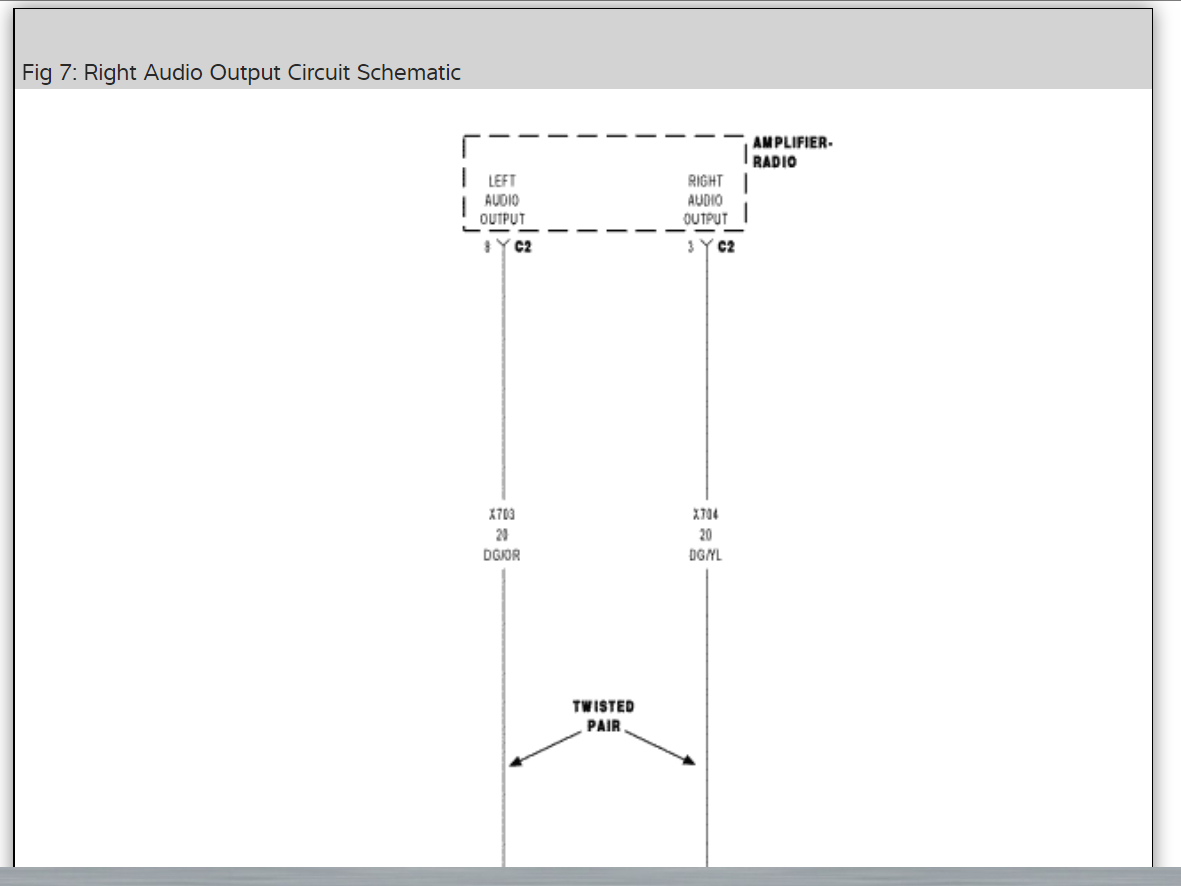

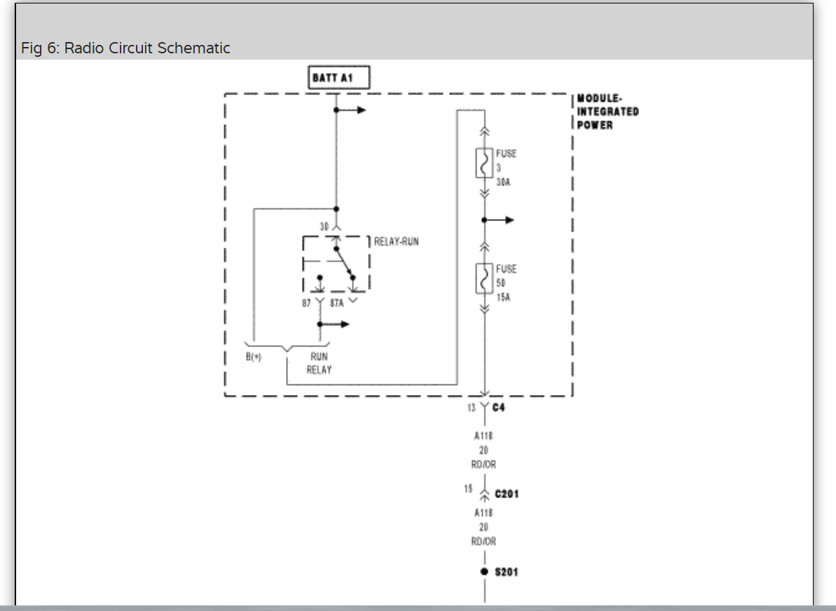

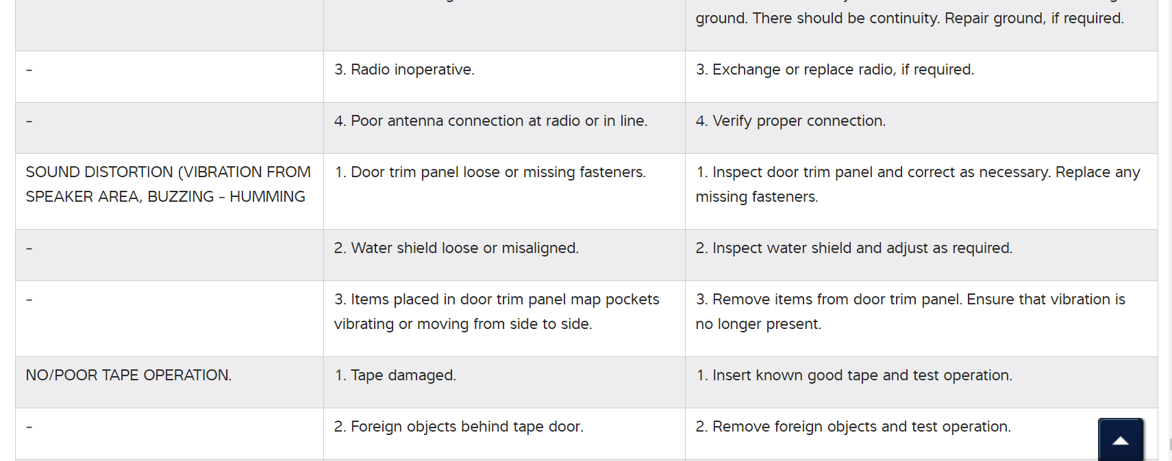

This could a number of things. It could be a loose ground wire, the antenna could of become detached, the connector could have come loose. Unfortunately this is just going to have to be a matter of elimination of probable causes until we get to what has failed. In the diagrams down below I have included a factory troubleshooting guide for your vehicle's radio unit. Please go through it and get to us with what you find out.
Thanks,
Alex
