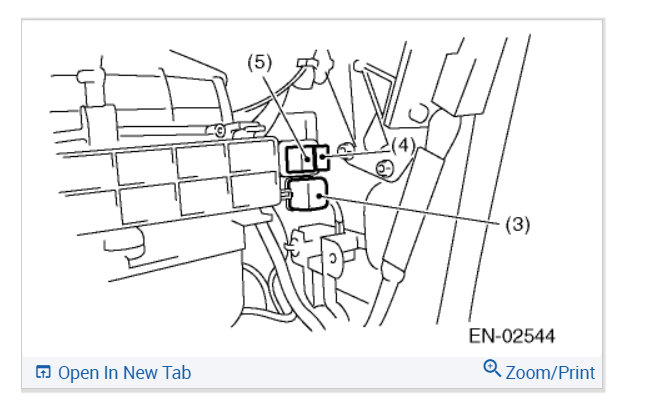

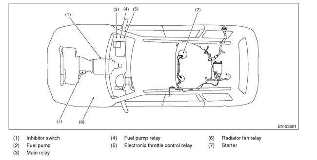

I rebuilt the fuel pump, and the car still won't start, check spark is good. The car still won't start.
May 15, 2022 at 10:04 PM
  • 55,423 POSTS
So, it turns over okay, correct? When you turn the key on without cranking the engine over do you hear the fuel pump run in the tank? Also, you say I rebuilt the fuel pump; you mean the electric one in the tank? Here are two guides to help us see what's going on. I have seen the fuel pump relay stop the engine from starting in these cars. I will leave instructions in the diagrams below for your car.
and
https://www.2carpros.com/articles/car-not-running-advanced
