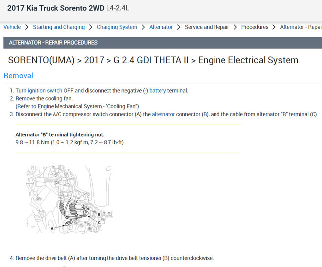

My car was acting like it was losing power, so I turned the engine off. When I tried to turn the engine back on it wouldn't turn over or start. Also, the battery light and the engine oil pressure warning light were on.
Mar 23, 2025 at 10:00 PM
  • 55,412 POSTS

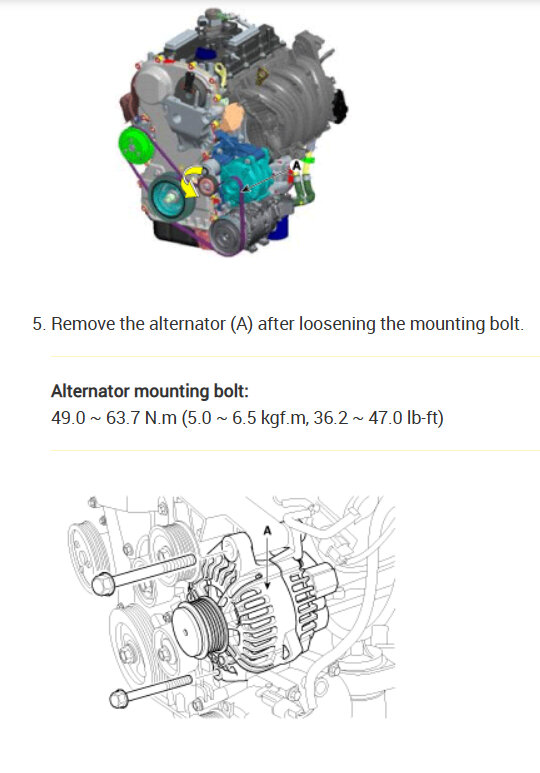

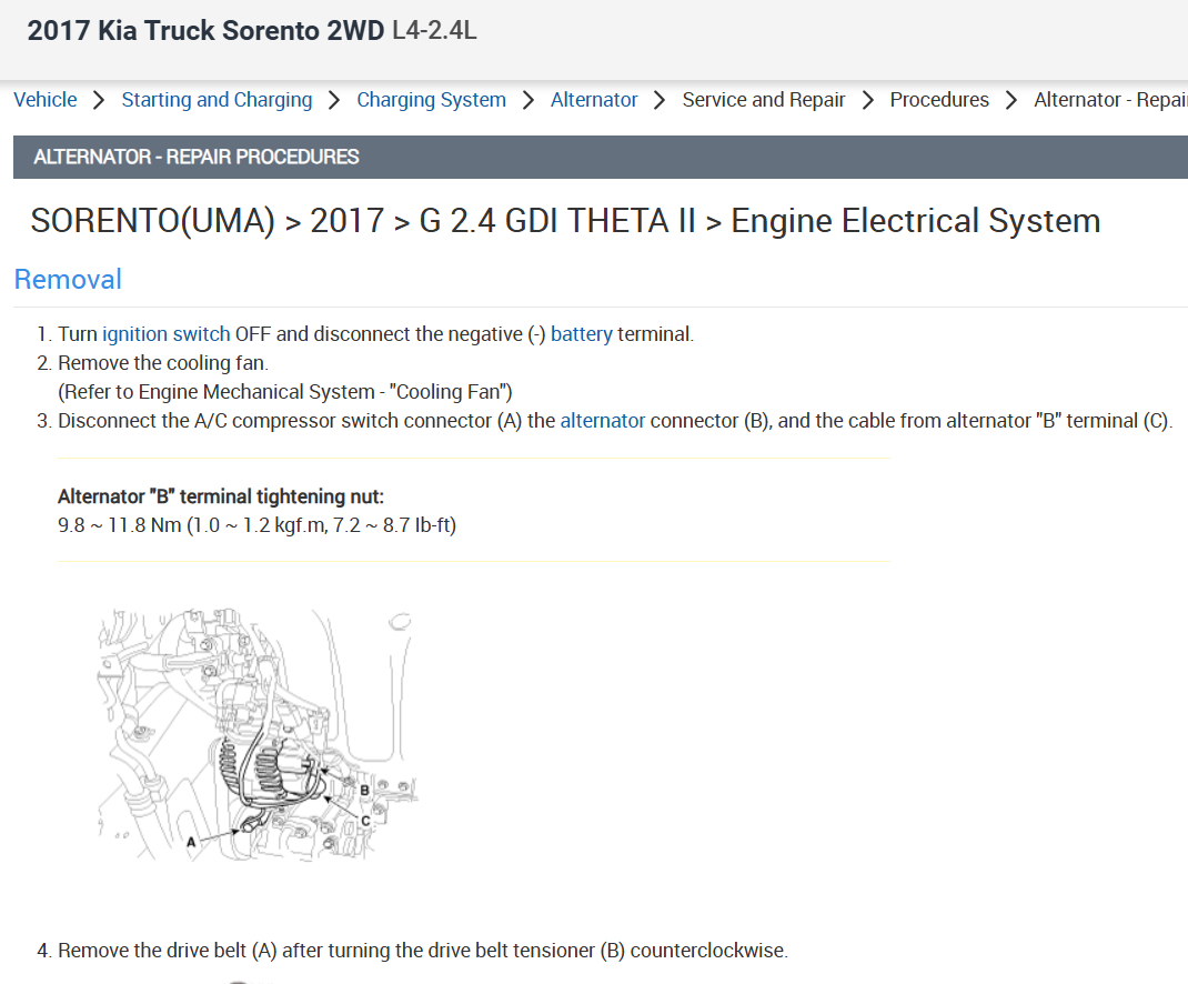

Yep, this is common when the alternator goes out, here is how to replace it in the images below. Let us know how it goes.
