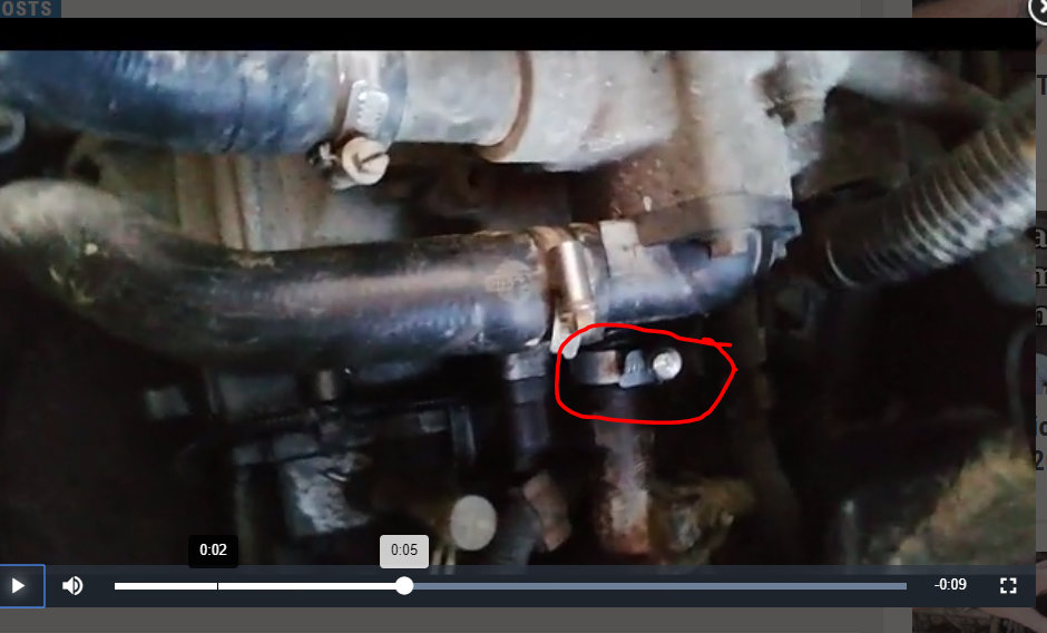

Car will go into gear when off and when on the gears will eventually go into gear. it was leaking oil but we fixed that problem. when driving it sometimes changes no problem but other times it won't. when putting car into reverse it drives it self without putting foot on accelerator.

Where was the leak? Based on your description, it sounds like a bad clutch master cylinder or slave cylinder. If the leak was within the hydraulics of the clutch, after the repair, did you bleed the system?

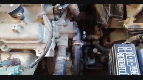

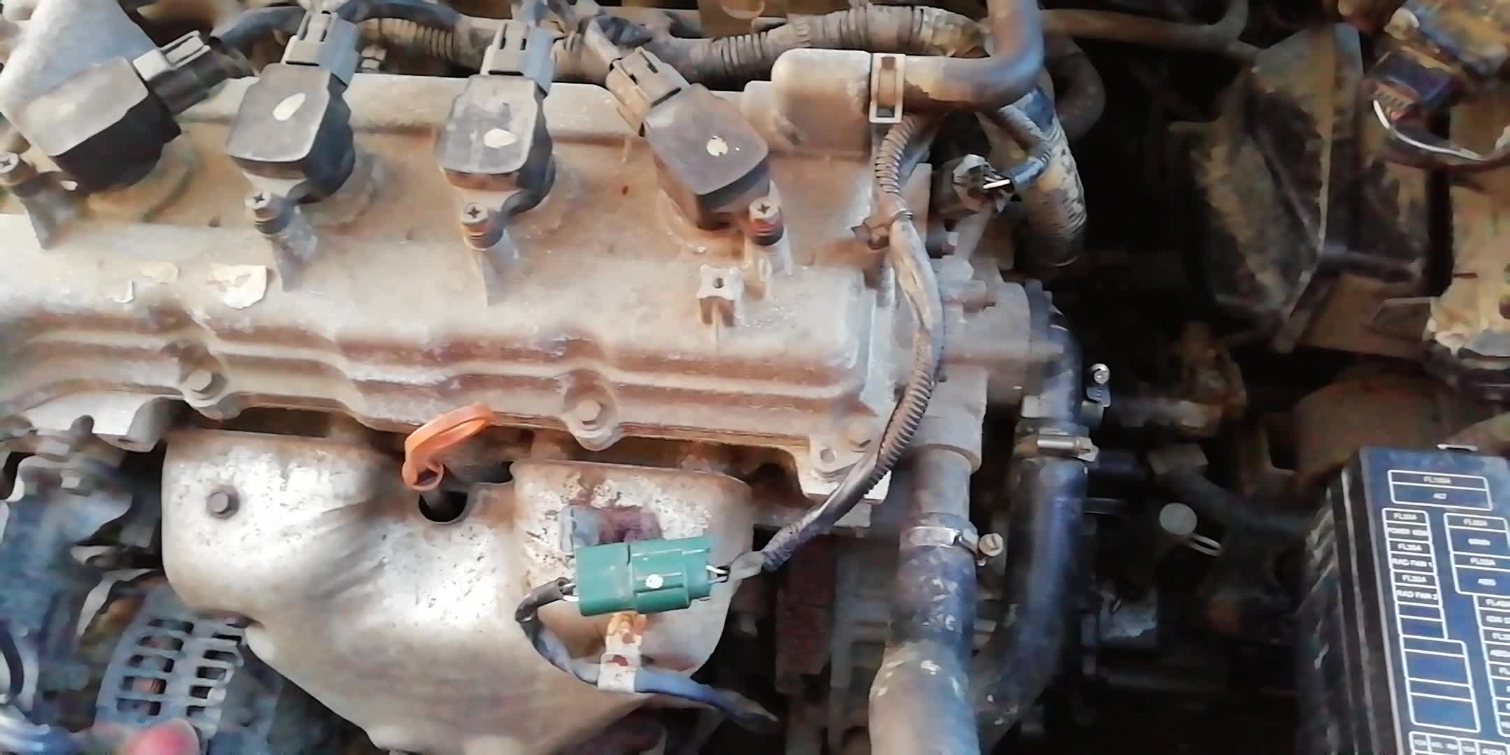

This is where the leak was. you can see the clip that I put on it after we put the clip on it was grand for all of a few minutes. i have checked the clip and it's no longer leaking.

I copied a portion of your video and circled a part. Is that a clamp you placed on it? I'm sorry, it's hard to tell looking at a video.
