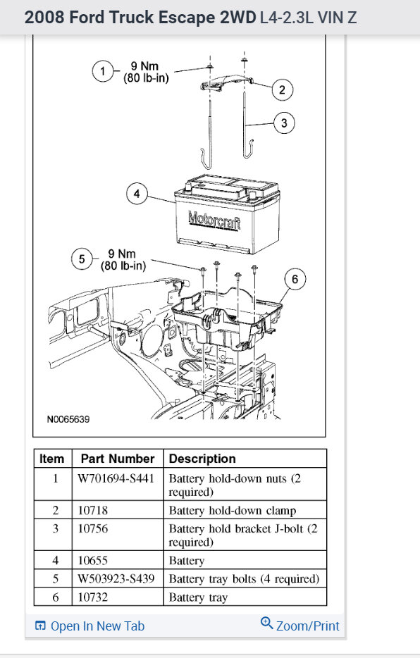

It sounds like you need a new battery but to be sure this guide can help you load test the battery without equipment:
This guide can help as well:
I have included how to change the battery out for your car in the images below.
Removal and Installation
Warning:
- Batteries contain sulfuric acid and produce explosive gases. Work in a well-ventilated area. Do not allow the battery to come in contact with flames, sparks or burning substances. Avoid contact with skin, eyes or clothing. Shield eyes when working near the battery to protect against possible splashing of acid solution. In case of acid contact with skin or eyes, flush immediately with water for a minimum of 15 minutes, then get prompt medical attention. If acid is swallowed, call a physician immediately. Failure to follow these instructions may result in serious personal injury.
- Always lift a plastic-cased battery with a battery carrier or with hands on opposite corners. Excessive pressure on the battery end walls may cause acid to flow through the vent caps, resulting in personal injury and/or damage to the vehicle or battery.
NOTE: Because the engine is electronically controlled by the PCM, some control conditions are maintained by power from the battery. When the battery is disconnected or a new battery is installed, the engine must relearn its idle and fuel trim strategy for optimum drivability and performance. Allow the engine to idle for one minute. The relearning process automatically completes as the vehicle is driven. The vehicle may need to be driven 16 km (10 miles). If the engine is not allowed to relearn its idle trim, the idle quality may be adversely affected until the idle trim is eventually relearned. Additionally, to account for customer driving habits and conditions, the automatic transmission must relearn its adaptive strategy. Optimal shifting resumes within a few hundred kilometers (miles) of operation. The clock and the preset radio stations must be reset once the battery is connected.
1. Disconnect the battery.
2. Remove the 2 battery hold-down nuts.
- To install, tighten to 9 Nm (80 lb-in).
3. Remove the battery hold-down clamp.
4. Remove the battery cover (if equipped).
5. Remove the battery.
6. To install, reverse the removal procedure.
Check out the images (below). Please let us know what you find. We are interested to see what it is.
