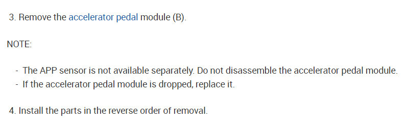

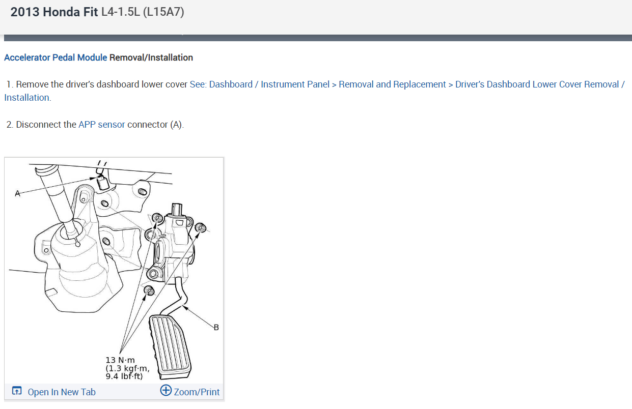

Here is how to change out the accelerator pedal position sensor in case a code is stored if it. Check out the images (below). Please let us know what happens.
