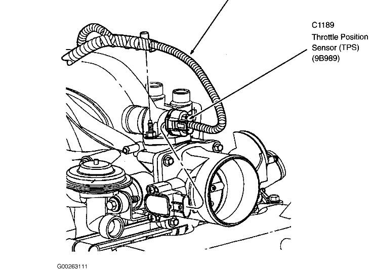

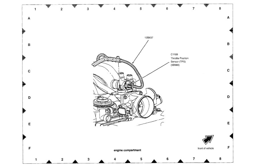

Does it have a air idle control valve?
Dec 14, 2018 at 1:22 AM
Good afternoon,
Yes it does. it is located on top of the throttle body. Check out the diagrams (Below). Please let us know if you need anything else to get the problem fixed.

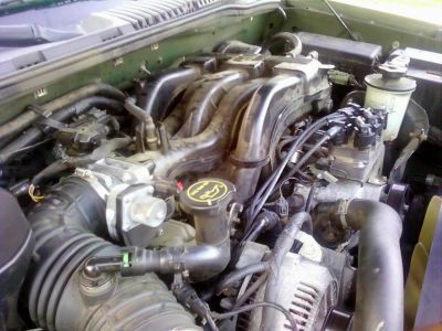

HUCKLEBERRY918
I am having the hardest time locating my Idle air control valve. The pictures I've seen doesn't match what i see on my motor. Can anyone help? As of right now my truck will not continue running.
https://images.2carpros.com/forum/automotive_pictures/576261_20100924075456_1.jpg
Feb 5, 2021 at 2:13 AM (Merged)
  • 55,711 POSTS
Your car is drive by wire so It does not have an IAC motor becasue the throttle body actuator acts as the IAC as well. Here is a guide to help you see what I am talking about.

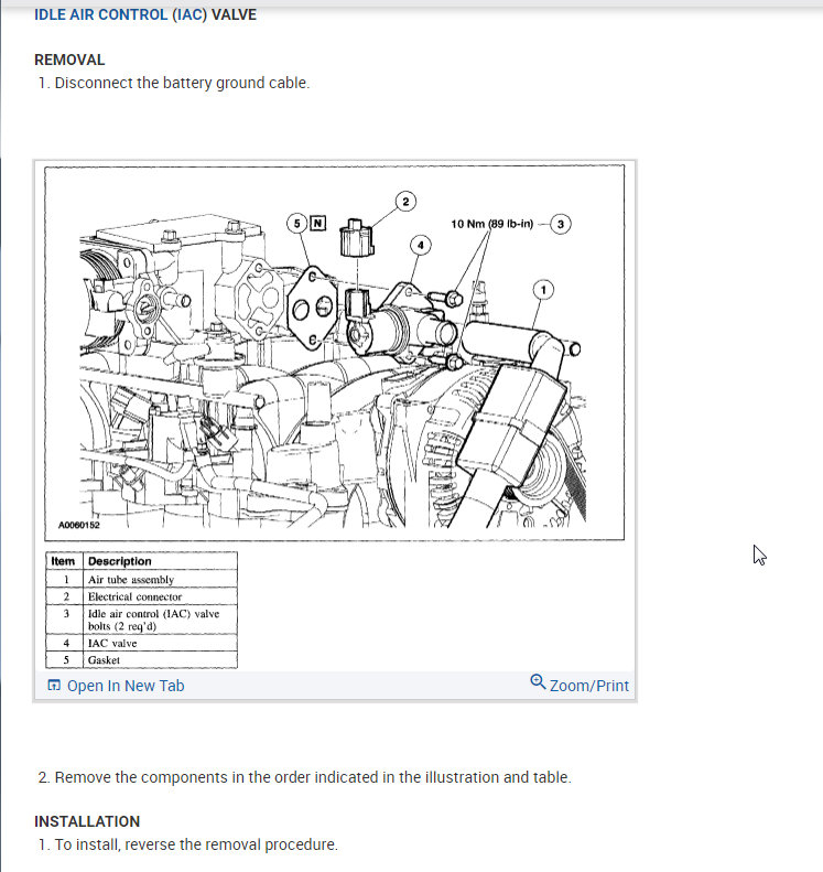

MJBJR57
I am experiencing a humming or rumbling noise from my explorer when i am decellereting to idle. the noise happens at low rpm's and only when decreasin g. It sounds like it is coming from the air intake just before it enters the ebgine.
More then likely this would be the idle air control so here is a guide that will explain how to replace this plus a guide that talks about noises from a vehicle. Please take a look at number 6 on this guide that talks about this in more detail.
https://www.2carpros.com/articles/how-to-replace-an-idle-speed-control-motor-iac
https://www.2carpros.com/articles/engine-noises
Lastly below is the process from the manual on how to replace the IAC. Please let us know if you have more questions. Thanks

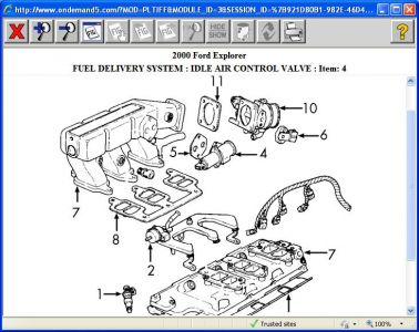

DALVANN1228
My Mom's Ford Explore has a check engine light. Went to Autozone to get the code. I did some research about the IAC valve. Do you know the location of the valve so that it can be cleaned?
SATURNTECH9
  • 30,869 POSTS
https://images.2carpros.com/forum/automotive_pictures/416332_2000_ford_explorer_iac_diagram_1.jpg
There you go its figure number 4.

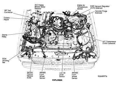

HIPPYDAWG
1993 Ford Explorer
where is it located and how to tell if it is bad?
Feb 5, 2021 at 2:14 AM (Merged)
DAVE H
  • 13,383 POSTS
Idle Air Control (IAC) Valve The IAC valve, mounted on the throttle body, controls idle speed by regulating throttle plate by-pass air. IAC valve includes an air by-pass valve and idle speed control solenoid valve. The air by-pass valve is affected by the engine coolant temperature and functions during cold engine conditions less than 122 °F (50 °C). The idle speed control solenoid is controlled by PCM and works throughout the entire temperature range. On some models, idle is controlled by idle speed control air by-pass valve. A throttle air by-pass valve is a solenoid-operated valve controlled by PCM. The valve allows air to by-pass throttle plates to control cold engine fast idle, no-touch start, dashpot, overtemperature idle boost and engine load idle correction. Air by-pass channel carries idle airflow regulated by air by-pass valve. Air by-pass valve is controlled by PCM to adjust both cold and warm idle speeds. Air by-pass valve uses solenoid valve to vary idle airflow volume allowed to enter engine
https://images.2carpros.com/forum/automotive_pictures/266999_iac_1.jpg
Idle Air Control (IAC) Solenoid Solenoid is by-pass air type. Ensure ignition is off. Disconnect IAC solenoid harness connector. Set DVOM to 200-ohm scale. Measure resistance between IAC solenoid connector terminals. See Fig. 3 . Solenoid has diode. Connect DVOM (+) test lead to terminal VPWR and DVOM (-) lead to terminal IAC. Resistance should be 6-13 ohms. If resistance is not as specified, replace solenoid. Faults in IAC solenoid or circuit should set a service code. See QUICK TEST in appropriate TESTS W/CODES article in the ENGINE PERFORMANCE Section. If no service code has been set, see CIRCUIT TEST KE in appropriate TESTS W/CODES article for additional testing and specifications.
