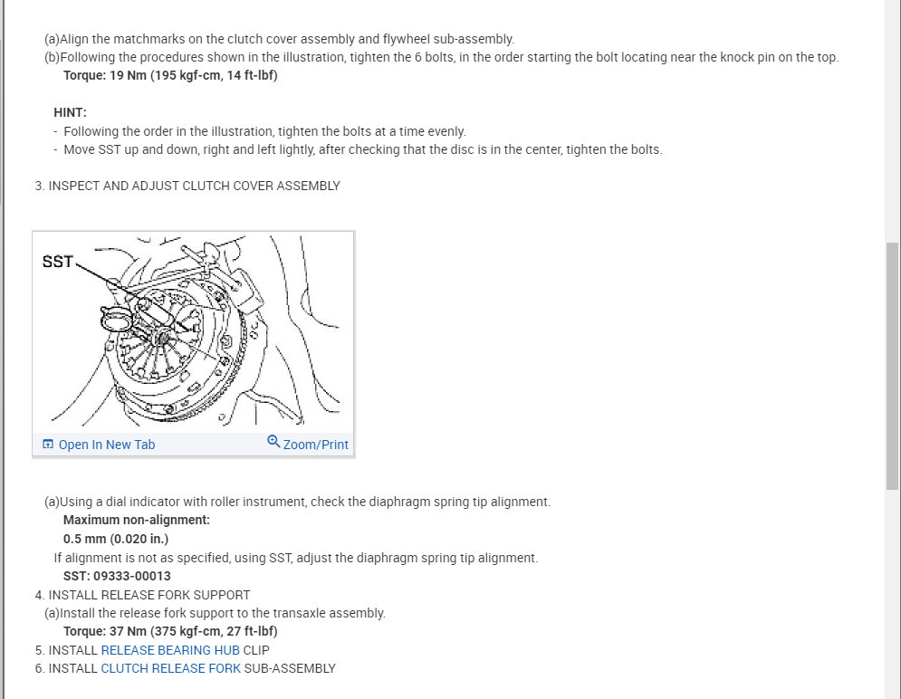

I am replacing my clutch and I don’t know which one is good . It’s a daily driver and I also drive fast. Can you give me diagrams on the job?
Dec 19, 2020 at 11:26 PM

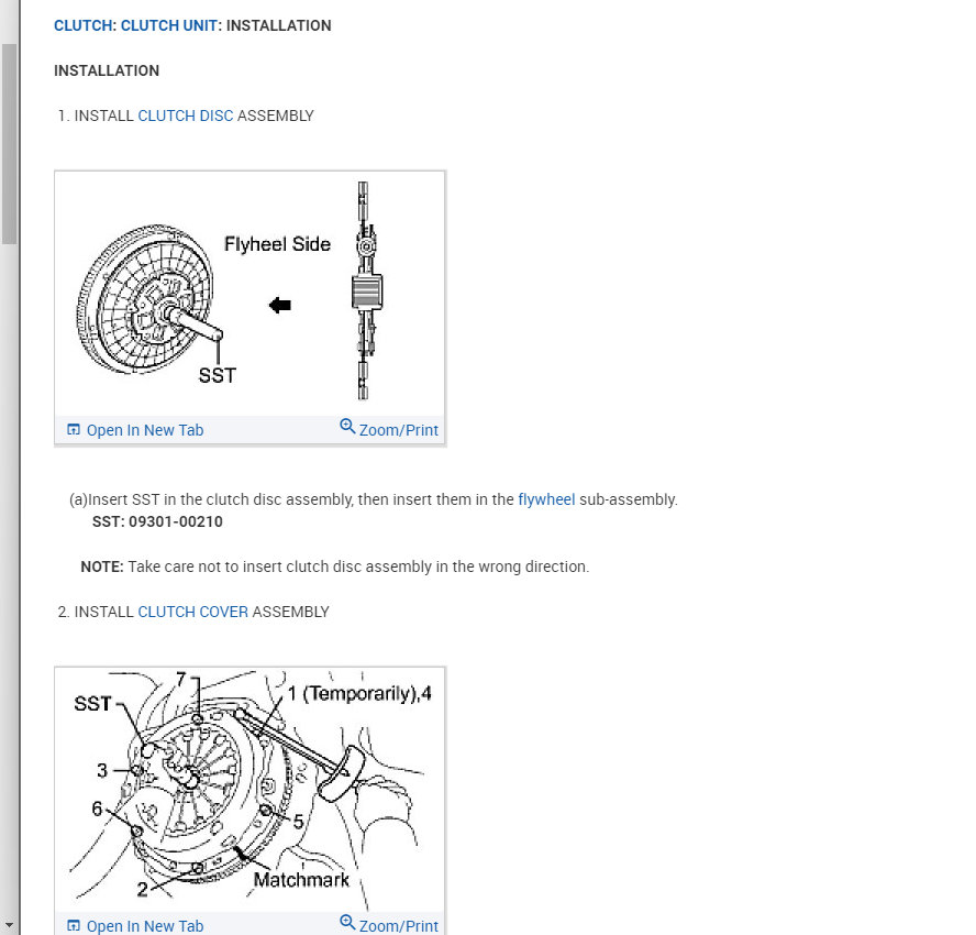

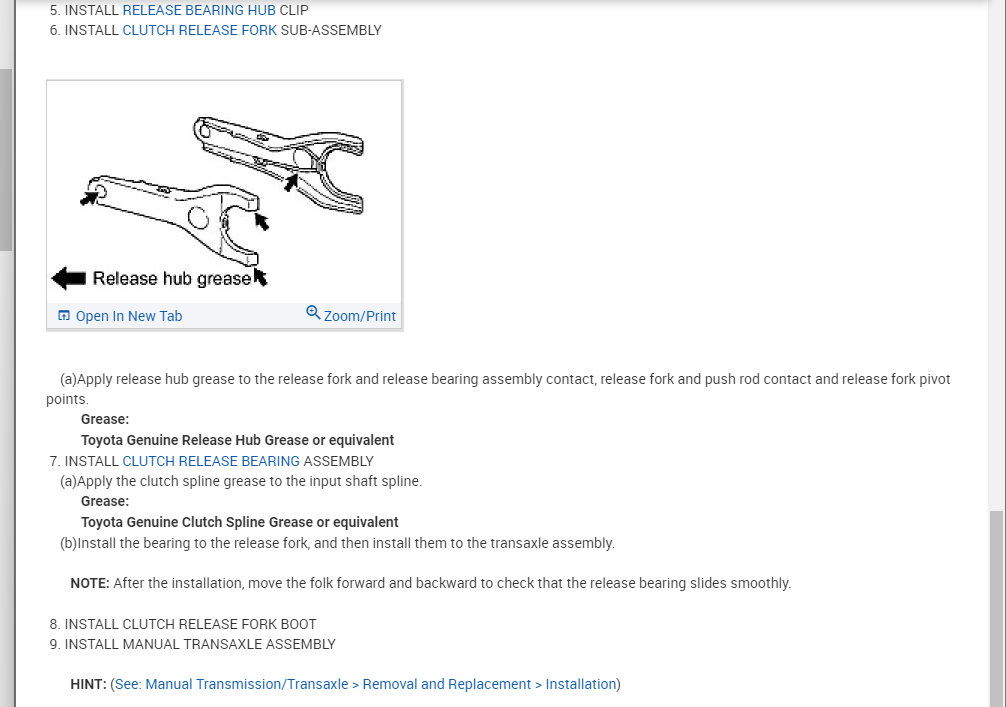

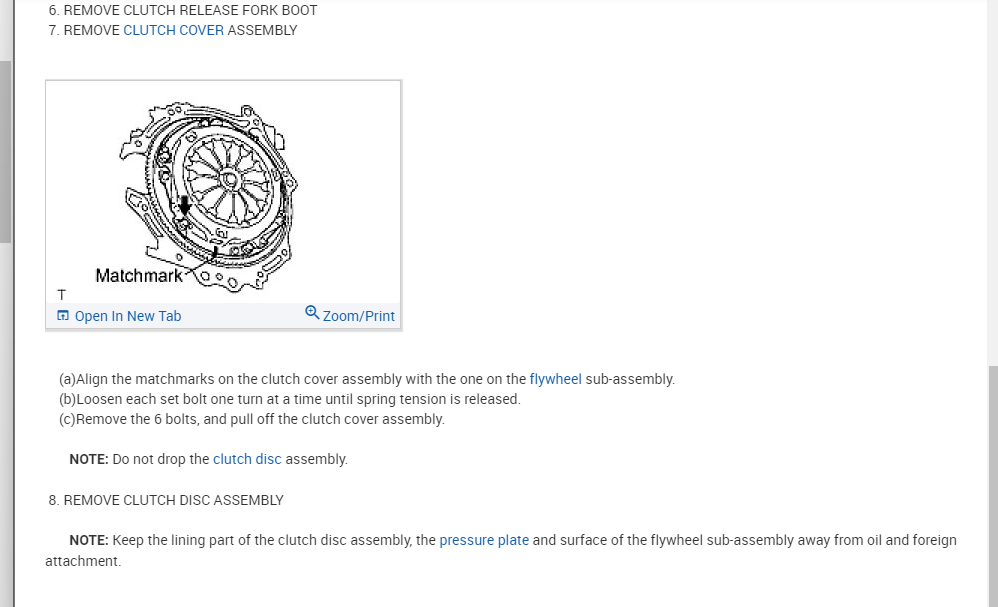

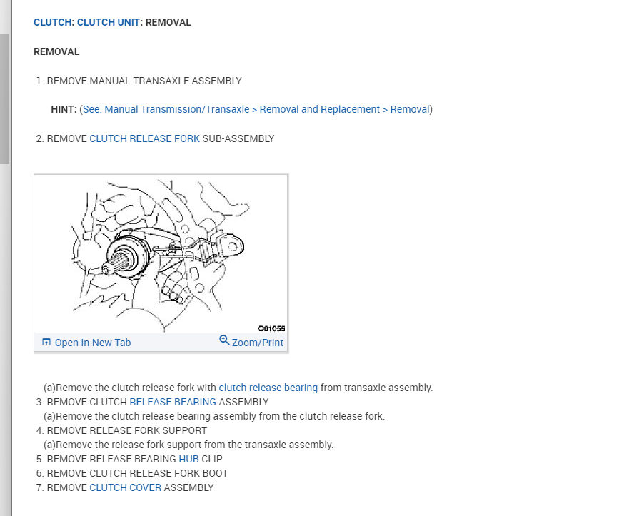

I will attach the info from the manual also here are a couple guides that will help with replacing the clutch as these have good info that the manual does not include:
https://www.2carpros.com/articles/how-to-replace-a-clutch
https://www.2carpros.com/articles/throw-out-bearing-replacement
Below you will find the process from the manual that will provide the specific info needed.
As for which part to go with, I would stick with the OEM kit just because this is a wear item that is not the easiest to replace so I would not want to put a cheap part in because if there is an issue, you have to redo the whole process.
Please run through this and let us know what questions you have.
