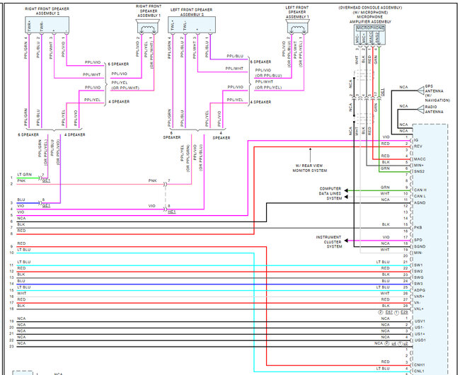

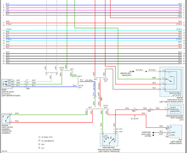

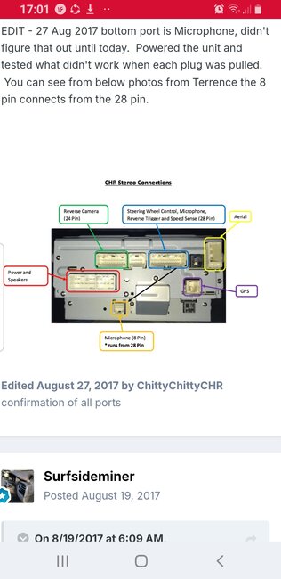

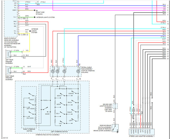

I am looking for a wiring diagram for a 2018 Toyota CHR. More specifically I need the one for the 10 pin and 6 pin connector that plugged into the back of the factory unit. I am looking for the wire diagram so I can properly connect my new navigation unit.

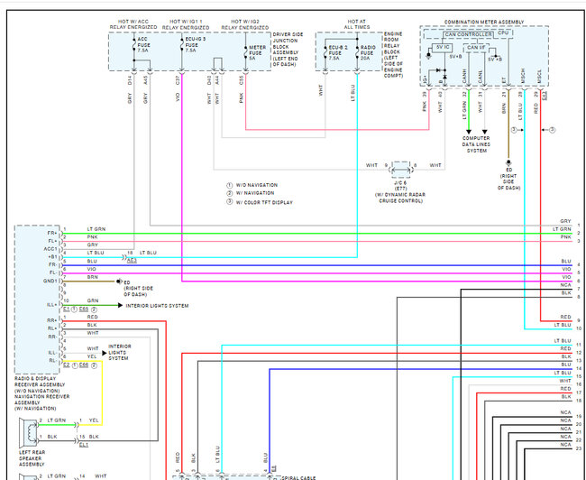

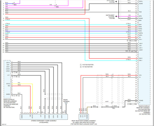

Here are the radio wiring diagrams as requested, check out the images (below). Let us know if you need anything else.

I want to know what each of these colored wires are?

You will need to match the wiring to the diagrams above to see what each wire does. There are a few options as well so if some of the wires don't line up, I will look into other diagrams for you.
