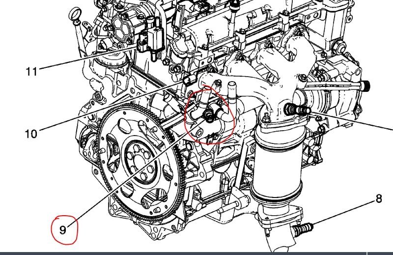

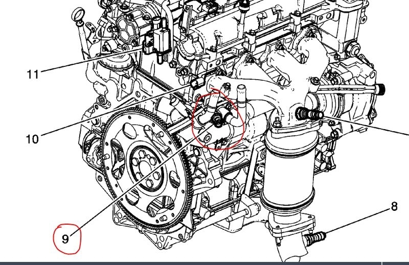

When i drive for about fifteen to twenty minutes, i get a message saying AC off/high coolant temperature and the temperature gauge goes way up to the red mark.

Does this happen in stop and go traffic or can it happen at highway speeds? Have you checked the coolant level? When this happens, does it seem as though the engine is actually overheating? Is there any steam from the engine or sounds indicating it actually is extremely hot?

Hi Joe, the message comes on in stop and go traffic as well as highway speeds.I checked the coolant level and it was fine.There is no steam or noises coming from the engine.After i park the car the fan stays on for about five to ten minutes.

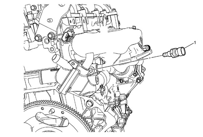

It sounds like you have a faulty engine coolant temperature sensor (ECT). Here is a link that explains how in general one is replaced:
https://www.2carpros.com/articles/coolant-temperature-sensor-cts-replacement
I attached a picture of where yours is located. I circled the sensor on the second pic. You will have to drain the coolant from the vehicle or it will leak when you remove the sensor. I have to be honest, if it doesn't see like the engine is actually overheating, this is my first suspect.

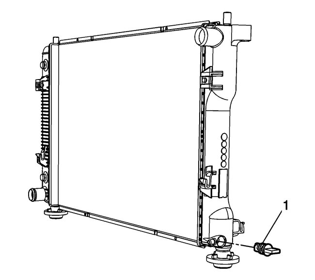

3. Place a drain pan under the drain cock.
pic 3
4. Loosen the radiator drain cock.
5. Drain the cooling system.

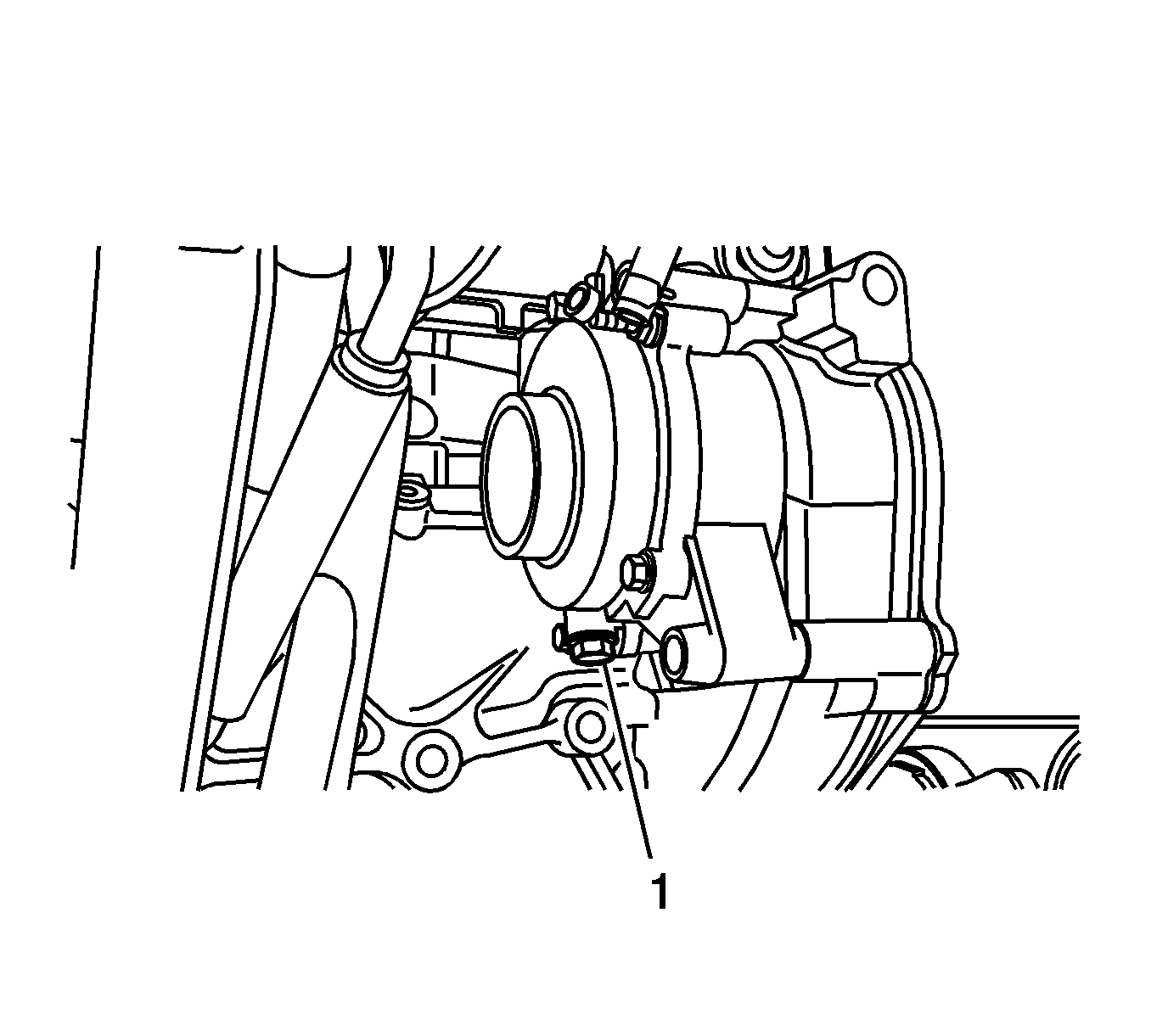

6. If a complete block drain is required, place a drain pan under the water pump drain.
pic 4
7. Remove the water pump drain plug.
8. Drain the cooling system.

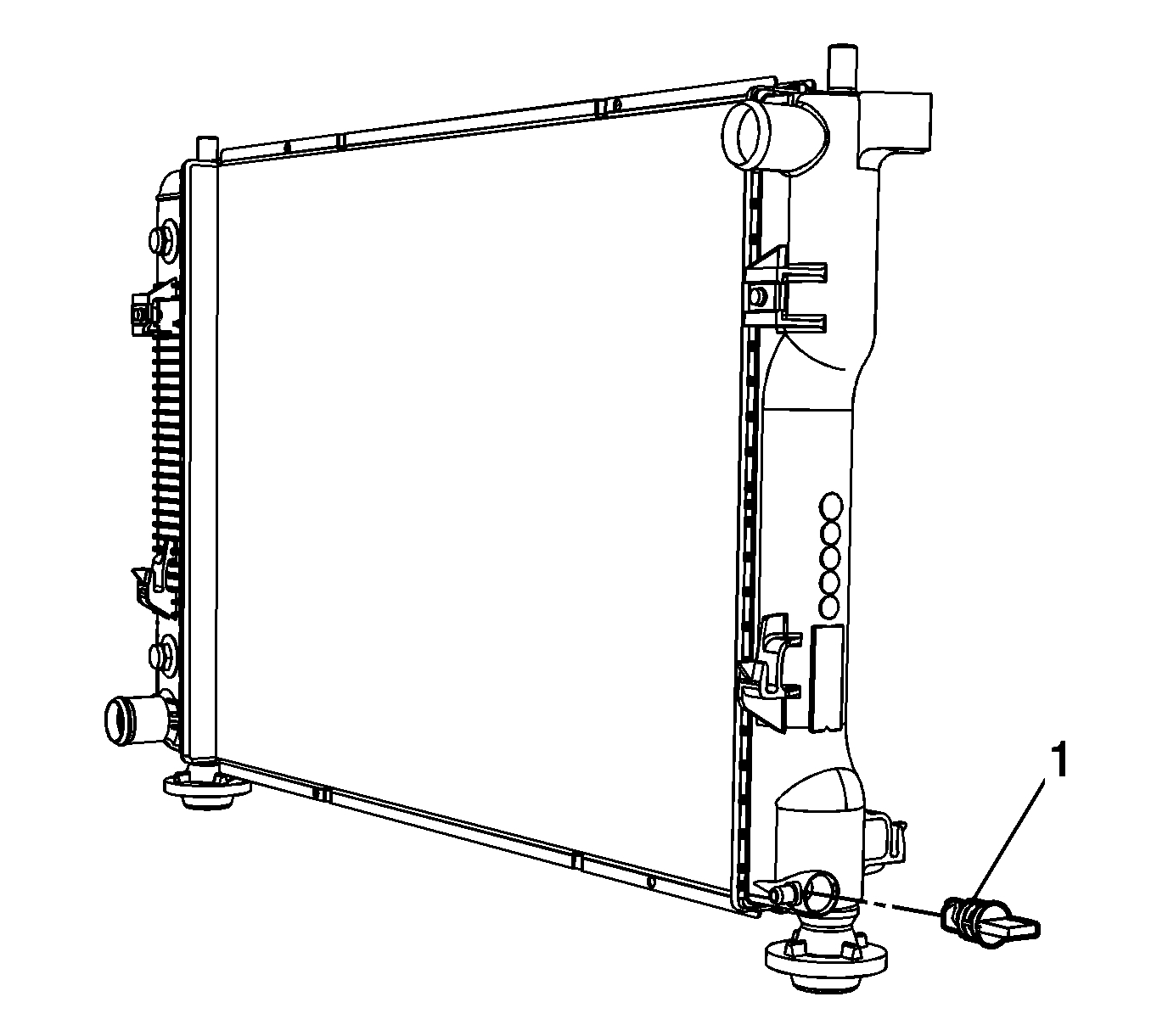

pic 5
Caution:
Refer to Fastener Caution See: Vehicle > Technician Safety Information > Fastener Caution.
1. Tighten the radiator drain cock to 2 Nm (18 lb in).

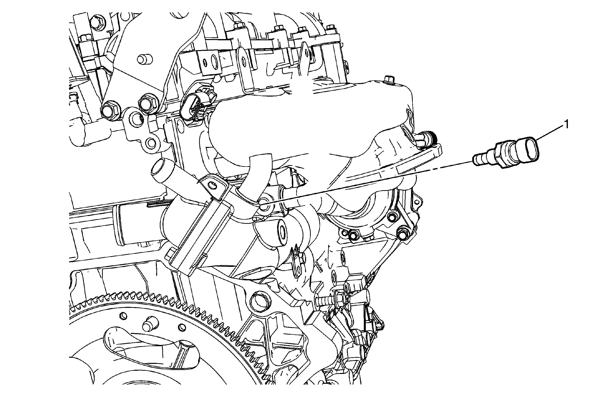

pic 6
2. Install the water pump drain plug and tighten to 10 Nm (89 lb in) if removed during the draining process.

I hope this helps. Let me know if you need anything and how things turn out for you. Note. You only have to drain the engine coolant until the level in the radiator is below the height of the sensor.

Hey Joe, the coolant temperature sensor fixed it thank you.
