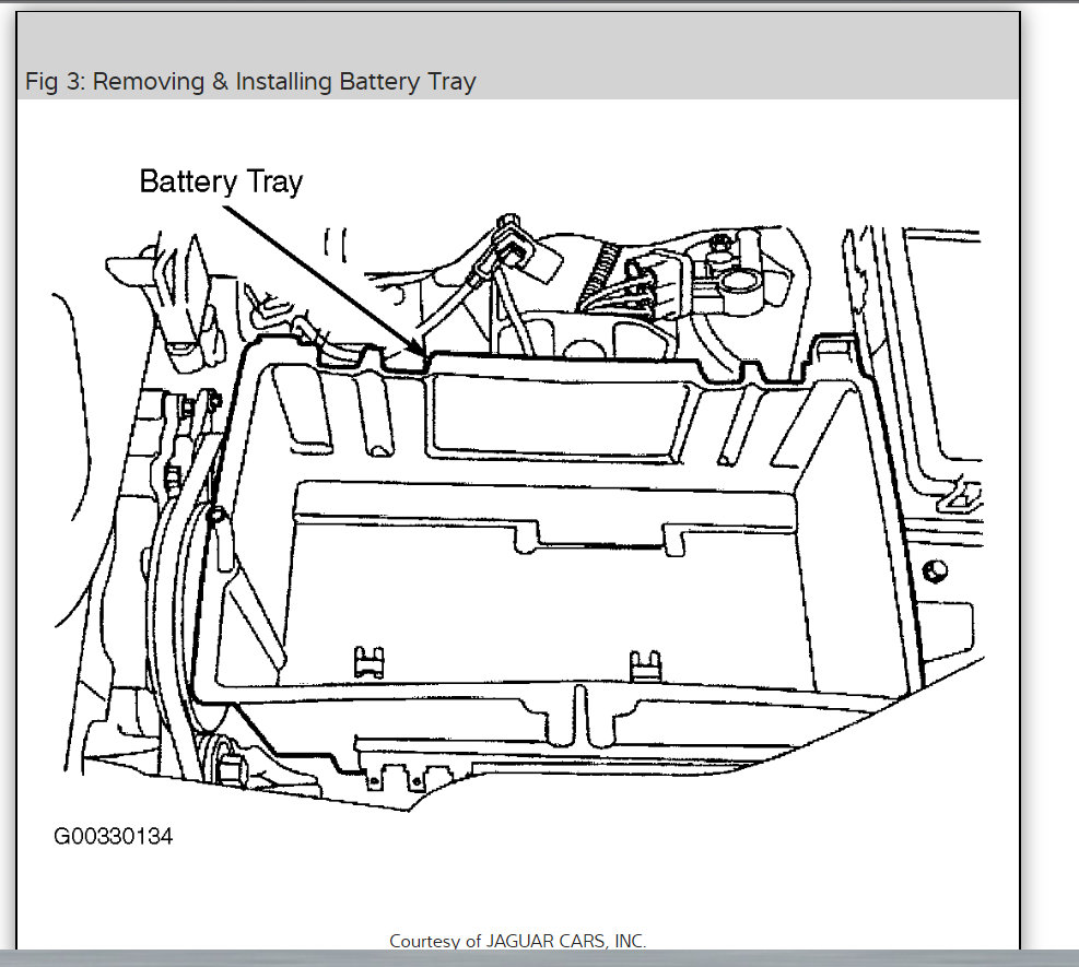

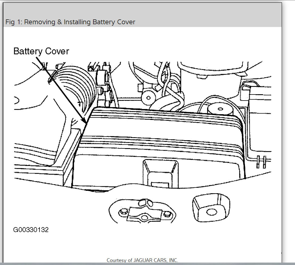

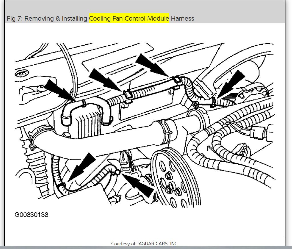

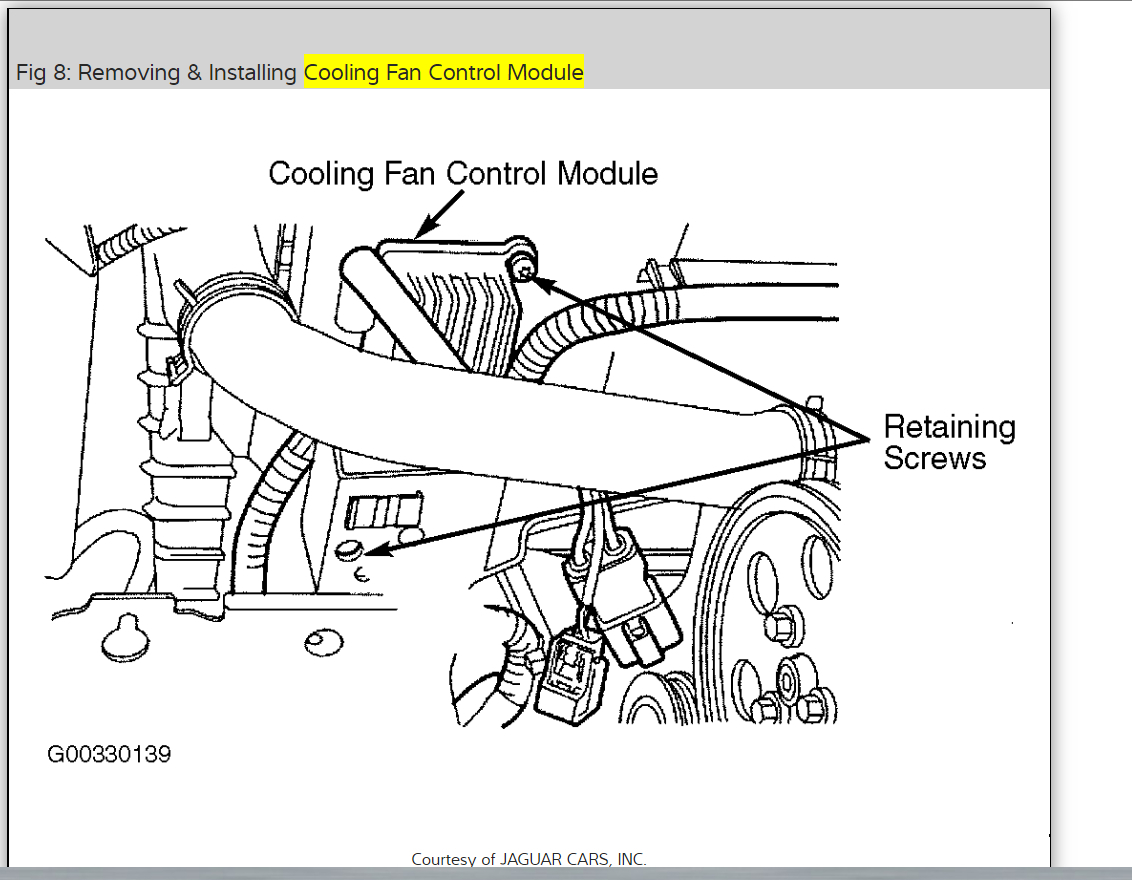

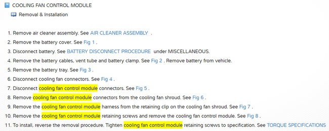

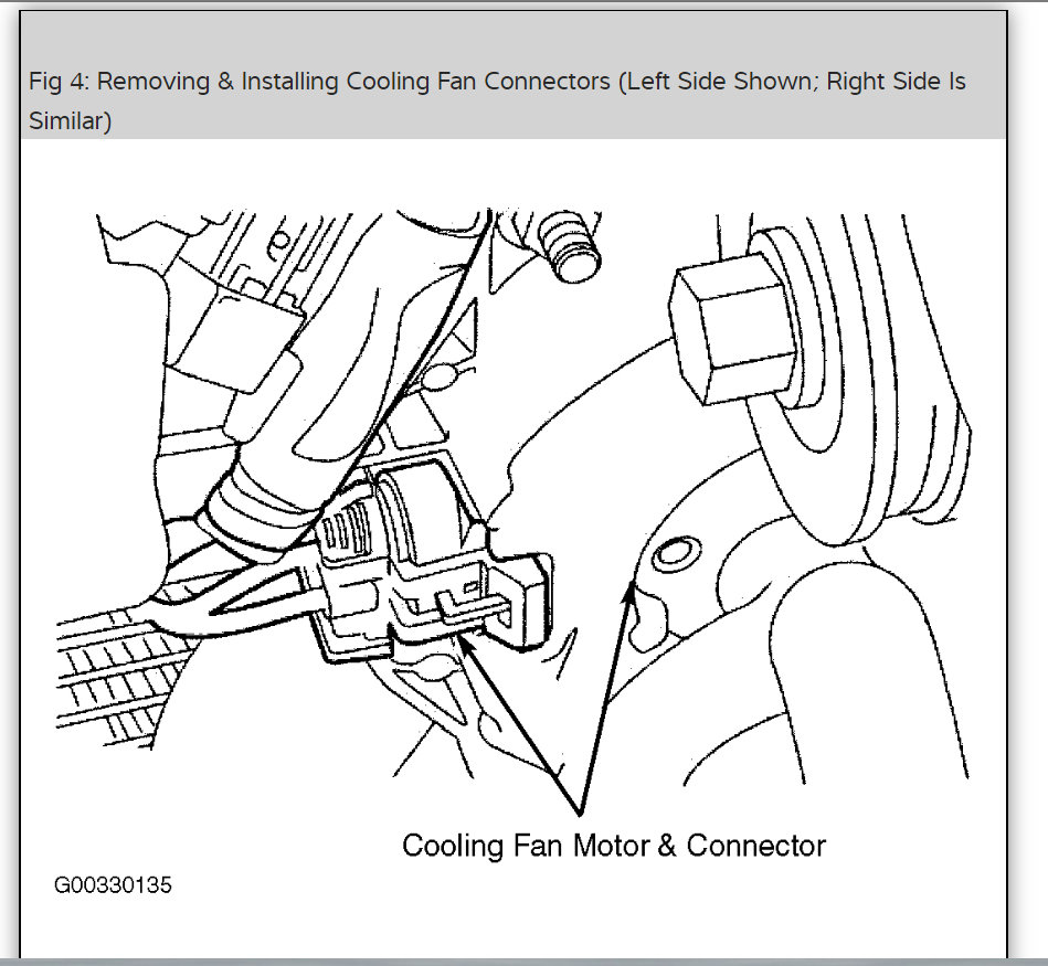

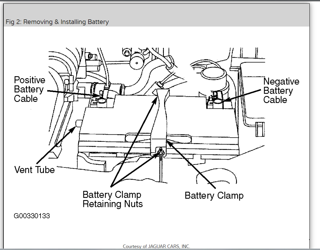

When driving above forty miles per hour I have no problems, when sitting in traffic car overheats. when I turn the heat on to press the gas it stops overheating. so basically it only overheats when sitting in traffic. I replaced new fan, replaced thermostat. help please and thank you.
Mar 12, 2019 at 5:16 PM
SCGRANTURISMO
  • 4,897 POSTS

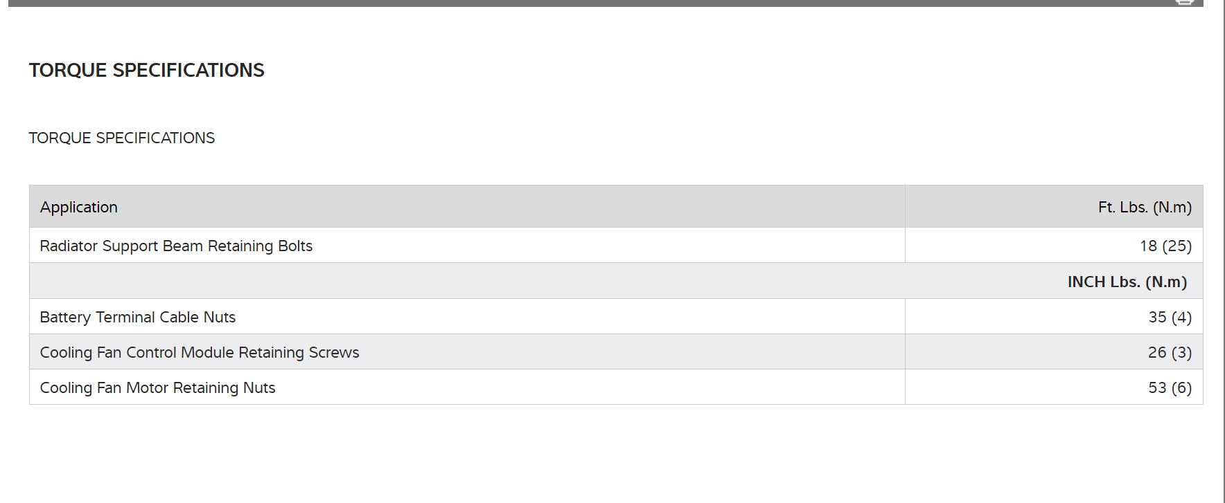

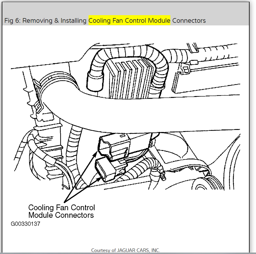

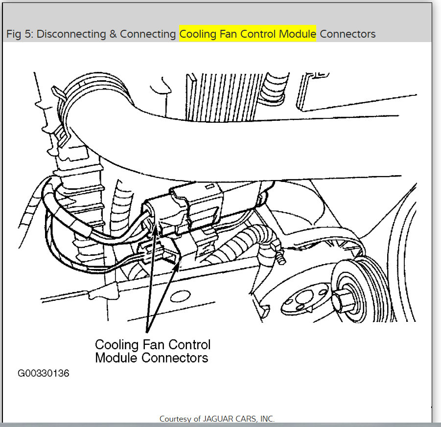

This could be a problem with your vehicle's cooling fan control module. This module does just what it's name implies, it controls your engine's cooling fan. It is has failed, then your engine's cooling fans will not come on when at idle sitting in traffic. I have included in the diagrams below a step by step procedure for removing and installing the cooling fan control module. Please go through it and let us know what you find out.

Hey guys thank you very much you were absolutely correct it was the fan modulator that was making my vehicle overheat when I was sitting in traffic thank you. Kenny
