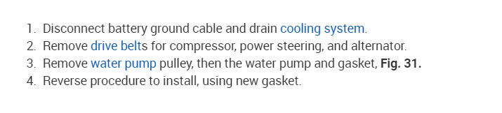

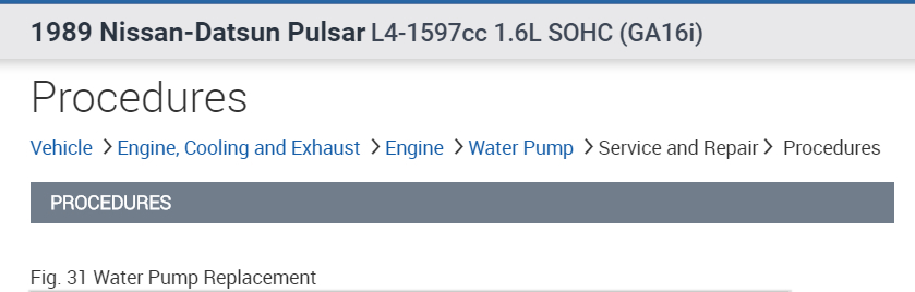

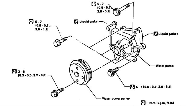

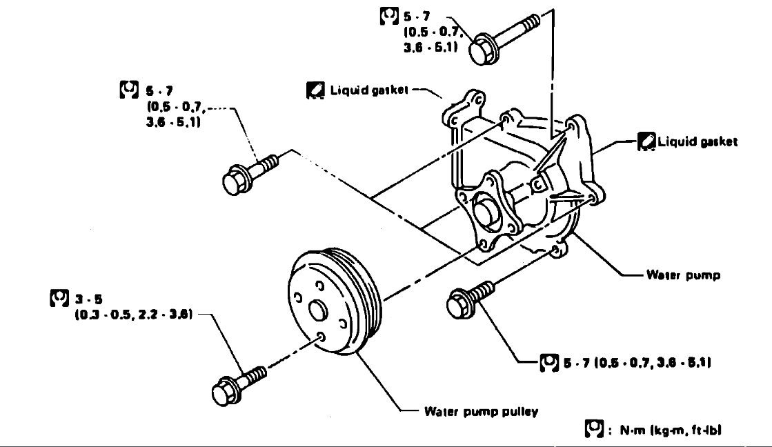

I would also check the water pump. There should be a "weep" hole located on the bottom of the water pump. There will be coolant leaking from it if the water pump is bad. This is done because the coolant can't be allowed to make it to the bearing when it starts to fail, or the water pump will completely freeze up, shredding the belt. I would also do a flush and fill, regardless of what you find out about the water pump. Here is a link describing how to do that below:
https://www.2carpros.com/articles/coolant-flush-and-refill-all-cars
I have also included instructions from the vehicle manufacturer on the removal and installation of your vehicle's water pump in the diagrams down below. Please go through these guides and get back to us with what you are able to find out.
