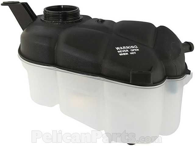

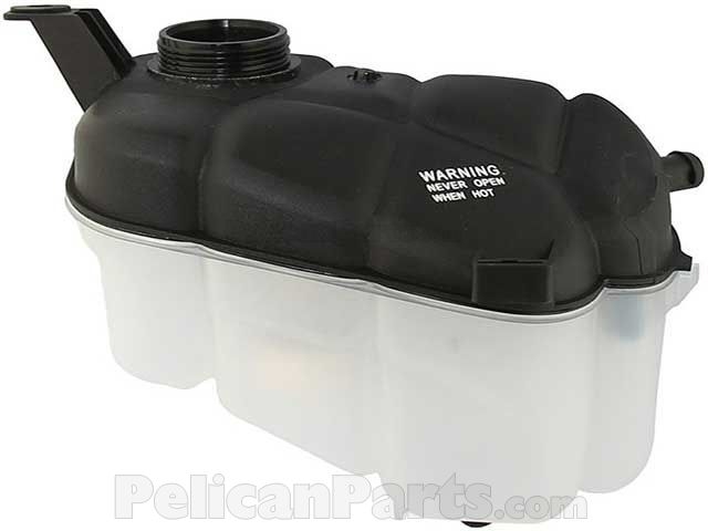

1. Could it be a leak in the upper reservoir tank? It's a closed system. It has a two-piece plastic reservoir that is factory fitted together. The seam is just above the fill line. There are no visible cracks.

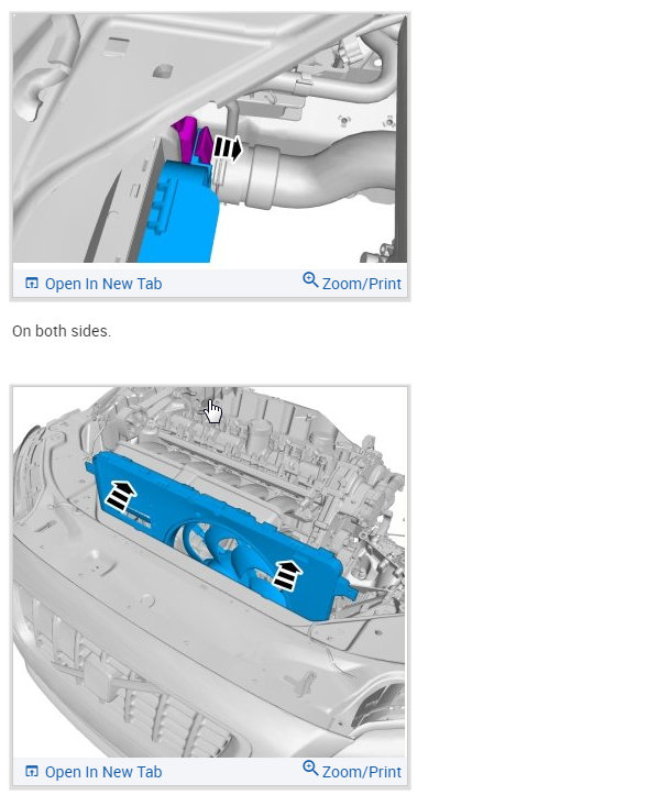

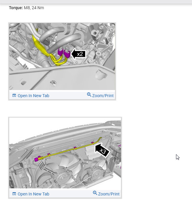

Did I miss something about the cooling fan? Usually, when a vehicle overheats sitting still but not moving it is because the fan is not coming on. You have a cooling fan control module so that could be the issue as they normally burn up and cause this issue. Turn the A/C on max with the engine on and see if the fan comes on high. If not, I suspect this is your issue.

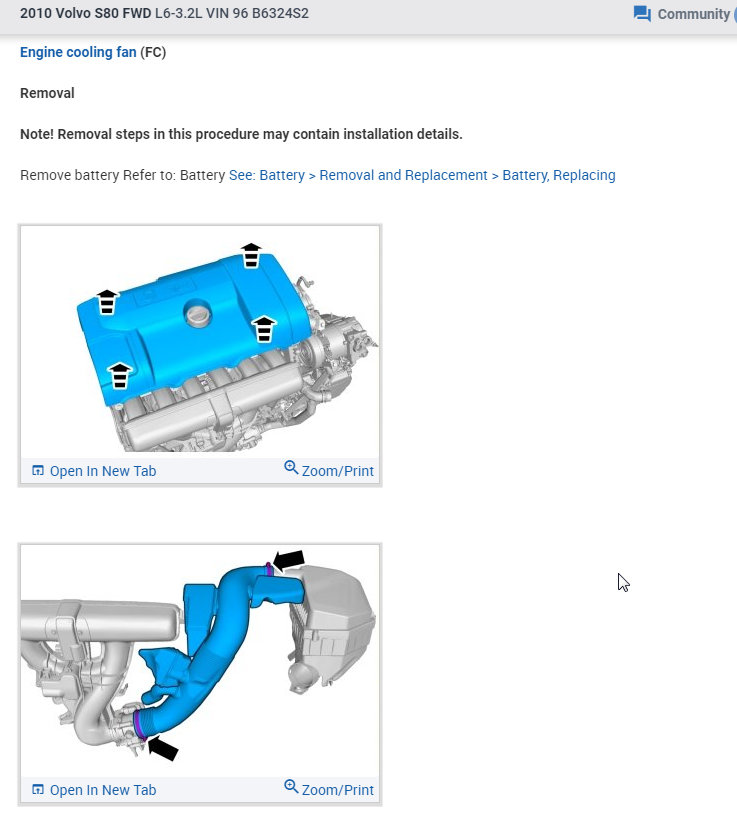

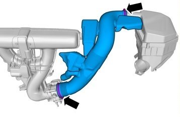

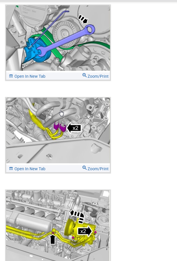

If it is not the control module, it could be the fan motor itself. Here is the procedure on how to replace the fan assembly in case you need it. Let me know what you find. Thanks

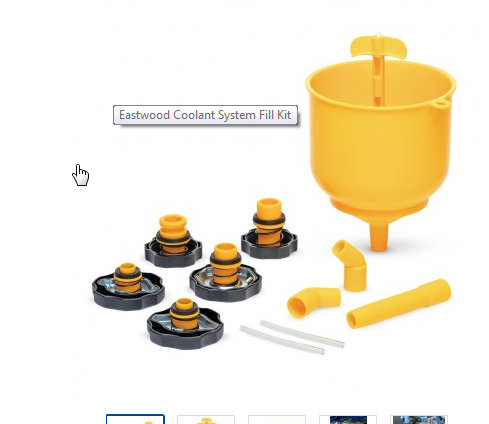

Okay. If the fans are working, what happens when it starts to overheat at idle and you rev the engine and hold the RPM around 2500? Does the engine temperature come down?
Normally, when you start driving and it cools down then it is a fan issue. However, it may be an RPM issue which would point to a water pump issue or possibly an air pocket. I would suggest using a funnel like the picture attached. Using something like this will allow the engine to work out the air pockets and leave you with a full radiator.
If you have no air pocket, the a water pump would make sense if the holding the RPM higher and the temperature comes down. Let me know and we can go further if needed. Thanks

Thanks. Interesting feedback. I never considered a software update. Is there any merit to the idea that it could be my expansion tank? While I concur with everything you stated, the fact that stop leak helped to some degree has me baffled. Case in point, I live just outside Washington, DC. Worst traffic on planet earth. Five days after first adding stop leak (with zero issues) on a Friday afternoon, I went from Alexandria, VA to Rockville, MD in standstill traffic. It should have been a 45 minute trip. It took over two hours. I had no issue. That evening, I was at a traffic light in DC. I got a high temperature warning. The stop leak definitely did something. I know stop leak is dumb. The symptoms have not changed. I'll look into the scan tool. Thanks for that. I can tell you that when the temperature indicator says that the engine is hot, the coolant level is volatile and rises up and down by about half a centimeter.
The expansion tank came to mind for a reason. After I thought I fixed the issue, it reappeared. I pulled over. After close to 30 minutes, I slowly opened the radiator cap (it's on the expansion tank). It was still hot. I got a steady stream of coolant spilling over. It appeared to be coming from the side and not the cap. There was coolant on the ground. There was no moisture on the top of the reservoir. See pic of the tank assembly.

Does anyone have an opinion on the reservoir tank? Does anyone have an opinion on a stop leak additive providing a temporary fix? This issue is baffling. It appears to be something else. Unless it's the reservoir.
Aug 20, 2019 at 8:27 AM
JIS001
  • 3,412 POSTS

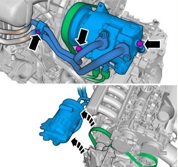

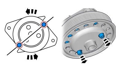

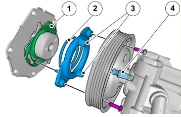

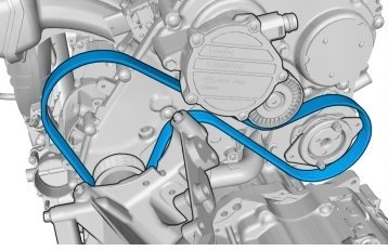

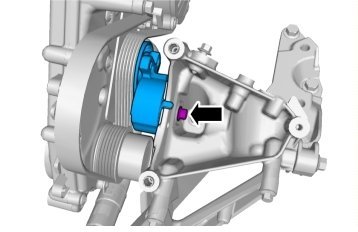

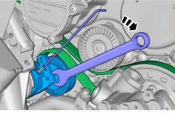

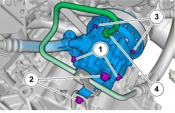

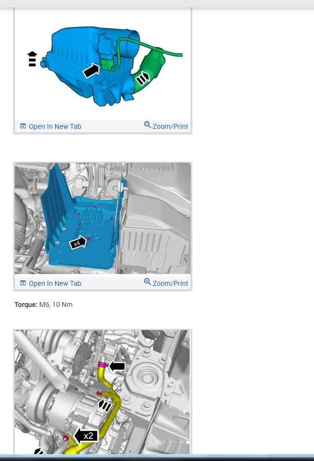

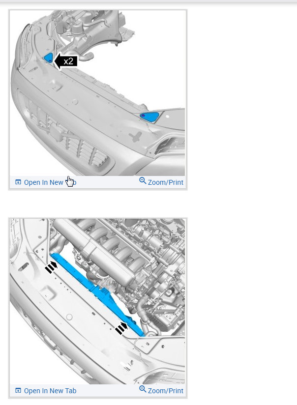

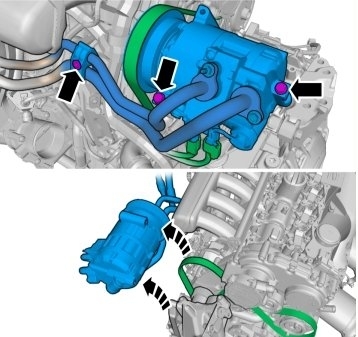

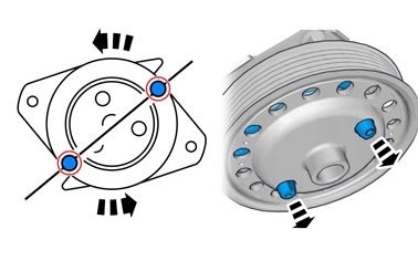

The tank is just a sealed reservoir that expands with pressure. You already replaced the cap so I would rule that out. I would like you to do the checks as stated earlier. And yes we can BFF's. As for the water pump replacement, it should take you about half a day to do. The repair manual does not use words but pictures instead so will upload them.
Let us know if you have any questions about the images. Also please do the checks and post videos of the information requested. Also that procedure is to remove the belt. Once you removed all that stuff in the way you can get to the water pump.

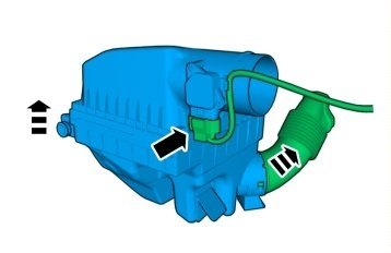

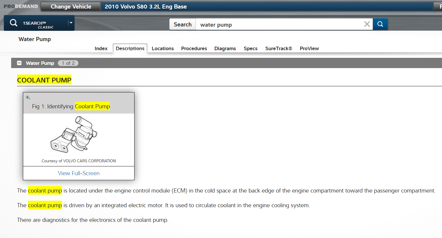

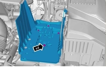

  • 54,832 POSTS

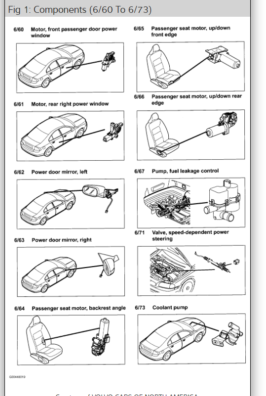

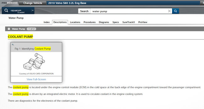

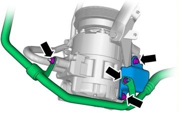

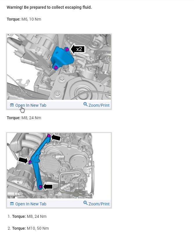

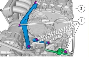

If I can jump in here. this car has an external coolant pump to circulate the coolant around inside the engine. it sounds like it works sometimes and not others. Here is the location and description of the pump operation. Check out the diagrams (below). Please let us know what you find. We are interested to see what it is.
Aug 23, 2019 at 12:55 PM
